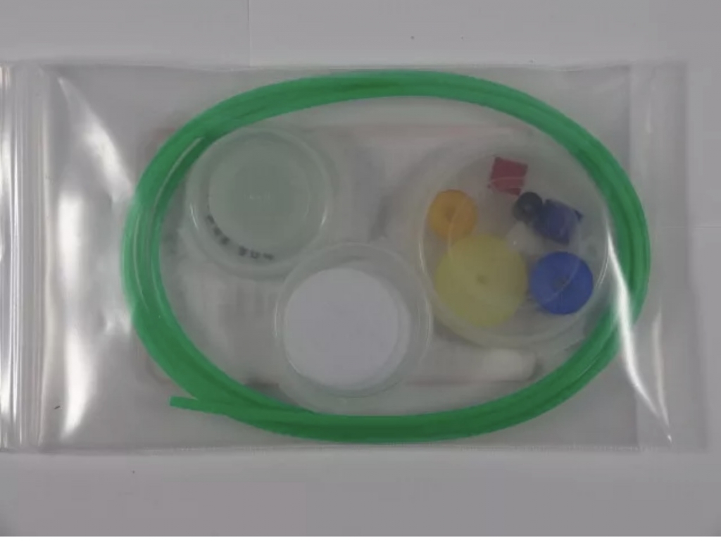

Patch Worm kit

A good video on how to use it all:
https://youtu.be/5xu6ZnX7q4M
