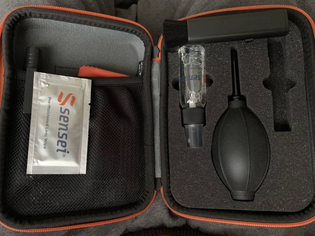

As for when the glass gets dirty I use a camera lens cleaning kit (see pic below). The blower (it has a bulb that I squeeze channeling through air through a narrow opening) is used first to blow away as much loose dust as possible. What I’ve noticed is that the dust is sometimes sticking to the lens. When I see this I use a lens brush in attempt to whisk away more dust. From there I will use a microfiber cloth that came with the scope to gently wipe away some of the rest. Then I finish it off with a pre-moistened lens wipe using circular motions from the inside (middle) of the lens outwards.

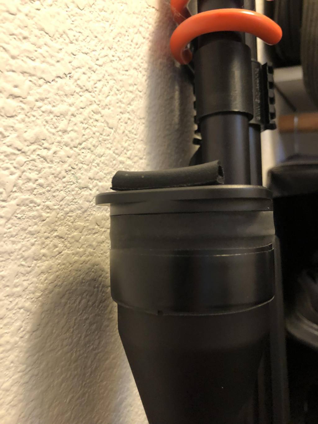

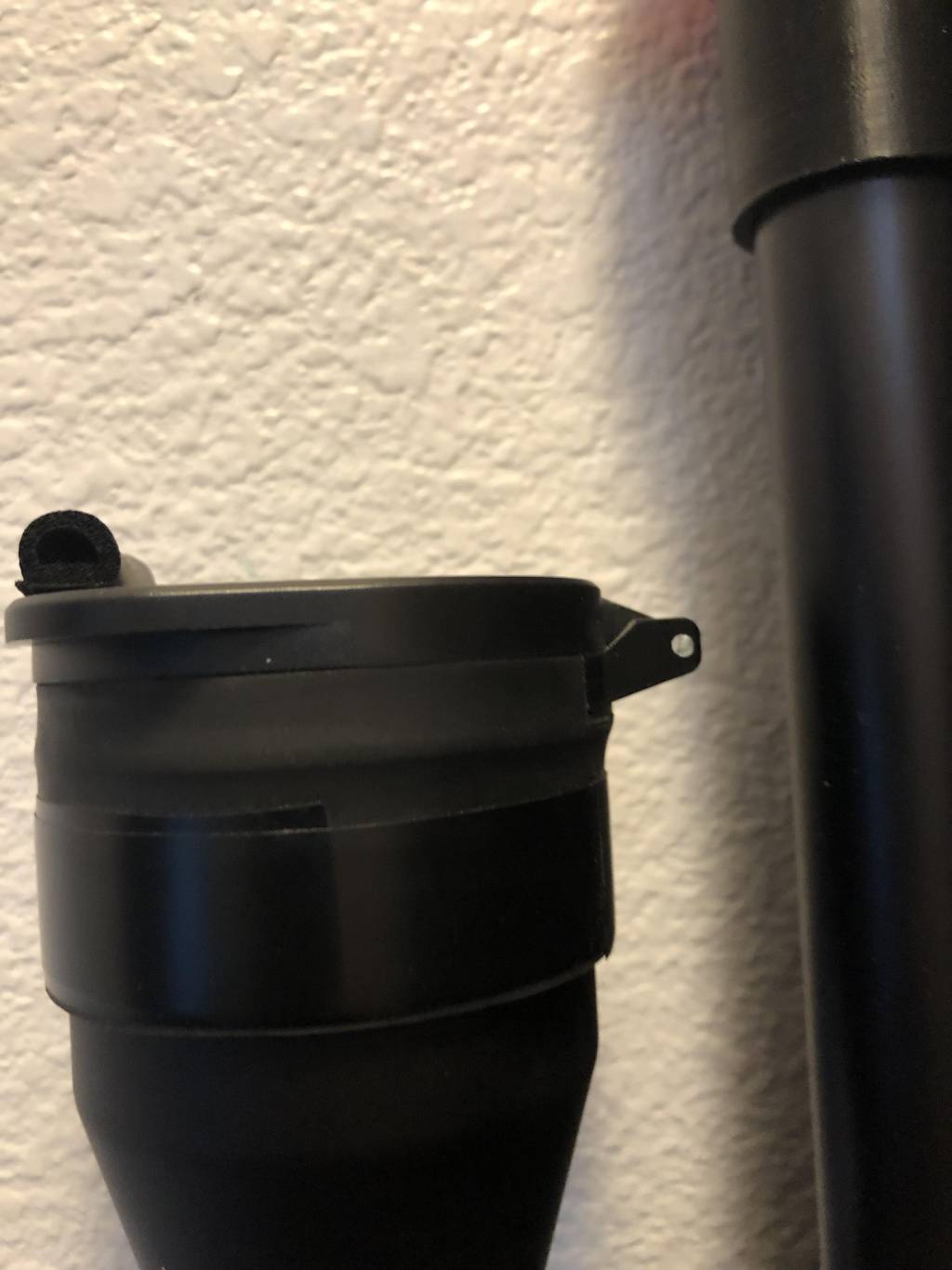

go to your local Home Depot, door and window gasket isle, and get some gasket material that’s around 3/8” wide by 1/4” thick. It’s adhesive backed so place a small strip onto your cap. When it flips up the gasket will remove that snap noise it gets when slapping onto your scope.
I prefer the 1/4” tube style gasket strips, myself-

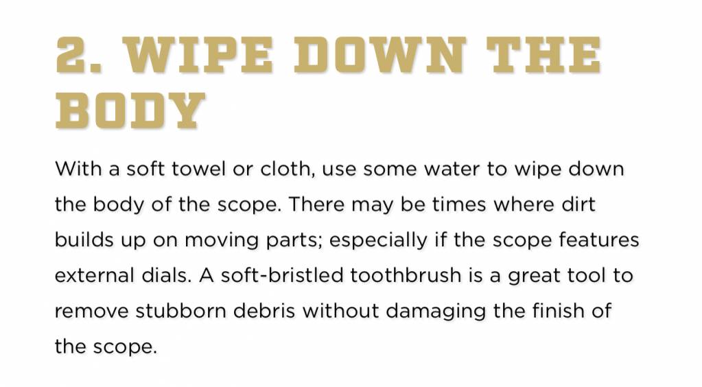

I tried cleaning around my turrets and adjustable magnification ring with a nylon brush and I am happy with the results. It eliminated some of the gritty feel when rotating the ring. I will continue doing this when cleaning my woods walking scope.
@bigragu I will definitely keep that in mind for springy scope covers. I hadn’t encountered that issue. The “click” I was referring to is what I hear as I open the covers. When closing them I am sure to push them shut firm enough to hear the cover “snap” or “click” securely. If I fail do this I have often had a problem with the eyepiece cover flying open on my way out of the woods when it brushes up against my hip or some brush. With this in mind, the same sound is heard when I open them again. When the woods are calm and I open the cover I have caused animals to stop moving or run off.
