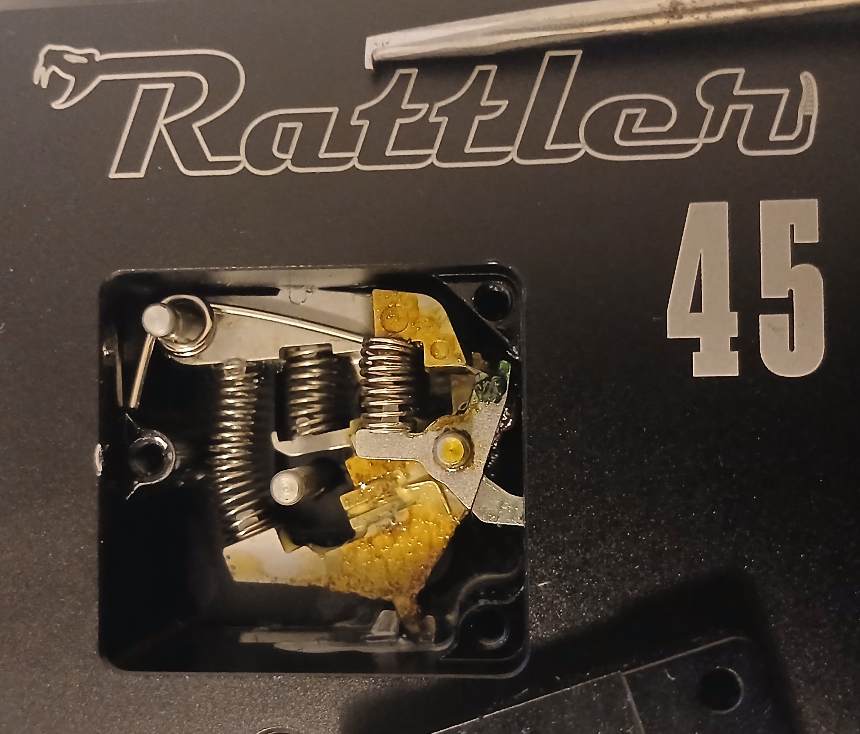

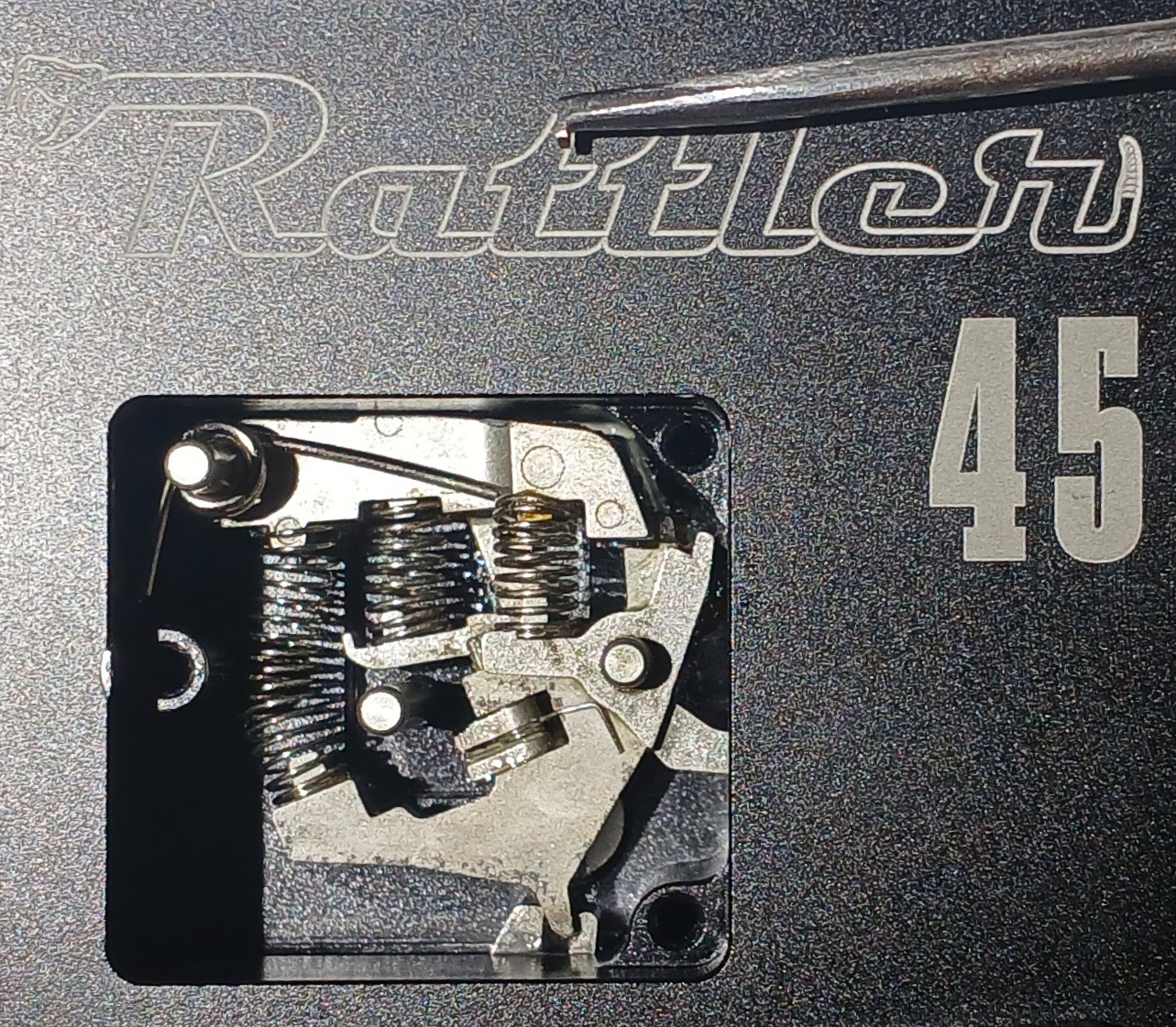

This video reinforces my desire to keep the correct lube on the internals of the Rattler, GK1, and other moving parts up here in the sub-freezing weather region. This factory applied grease is not the lube for smooth and consistent operation. (Before and after cleaning. )

@Airgun-hobbyist Now I see the difference and importance this. It’s about time I address the issue as well. Which grease did you use when cleaned and regreased your Rattler?

I used a mixture of gun oil and Hexagonal Boron Nitride hBN Powder (available on Amazon) on the dragging and moving parts like the sear and pin bores. Because the video shows that even some of the light gun oils would thicken and or freeze, I am going to throw the application bottle in the freezer to see if it survives. If it does not, I'll make a new mixture with something that doesn't freeze.
