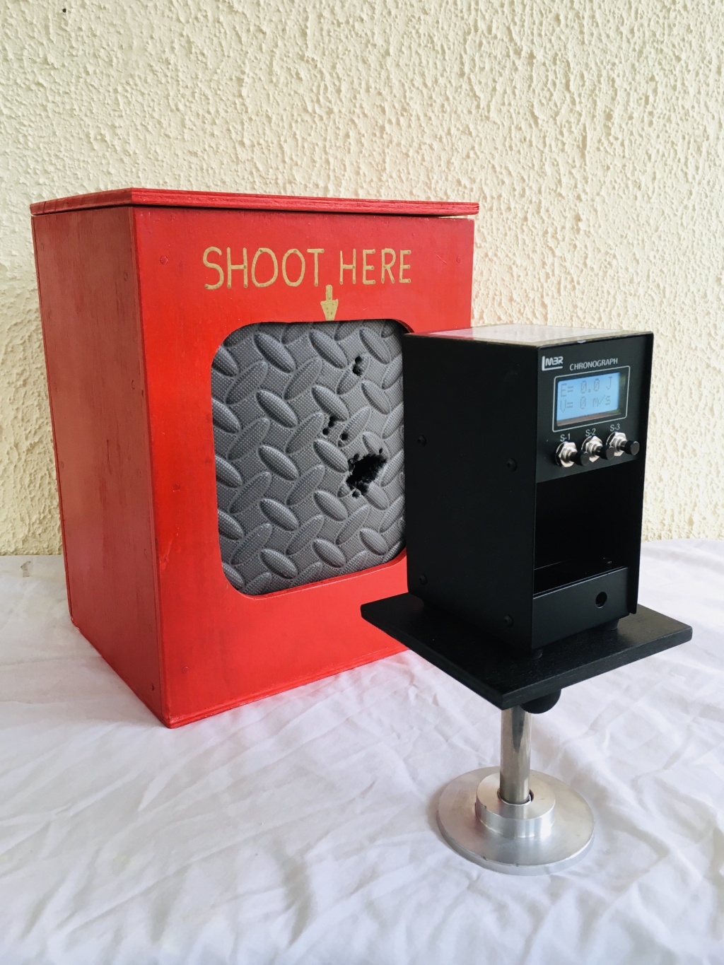

Hi , this is a chrony shooting stand I made last week. The chrony is put on a height adjustable stand ; the red box behind is made of 10mm plywood filled with magazines , newspapers or rubber foam , very thightly, and a plate of steel in the back in case of….very practical to test a gun in my shop without making a lot of holes in the wall 😊
. The thickness of the box is 8 inches , enough to easily stop the pellets of my .30 Crown.

Nice setup, Mike! Functional, and it looks nice. 👍🏼
I've been getting materials together for a chrony stand to measure BC out at 50 and 100 yards.
Got the acrylic glass to protect it against strikes, got a stand, a board — now I need the time (and the will!) to mount it...! 😄 The backstop is a great idea, just don't know where to get the rubber mulch here in Peru....
