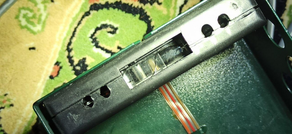

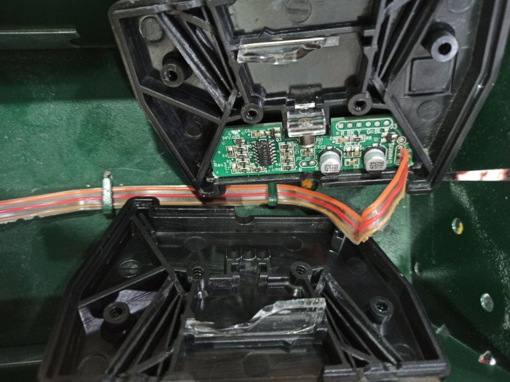

today my chrony m1 not detecting pellet.why? everything is like before
