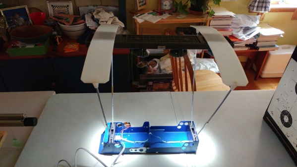

This is my indoor setup:
When outside I make sure the lighting conditions are the same for each sensor. As in the whole unit in the sun, or in the shade but not in between. If you have florescent bulbs as most do for ambient light turn them off as that is what is interfering with your chrony.
"John_in_Ma"This is my indoor setup:
I have my set-up dialed-in just right now; getting valid reads each shot. That's a nice rig you got there!
