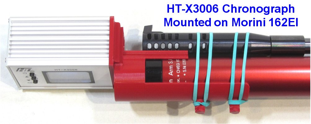

I think I can just create a single dovetail adapter that fits the Nate, which would allow reusing the mounts I designed for the HT-X3006.
I want to be able to use the sights on the pistol when firing. What is the distance between the sensor bore-line and the top of the Nate Chrony? If it's more than ~ 1.5 cm, how big is the sensor area? On the HT-X3006, I can offset the pellet path a few mm to get the sights above the housing.

The distance from center to top is ~15mm & bottom is roughly the same, however alignment is absolutely critical (new software has alignment detection though - so you can detect if there's an issue)
I would not recommend to use the outer surfaces on the Chrony as a reference point, and only recommend using the center bore as the reference.
Also looking at the designs - they're most likely not rigid enough & you'll see errors in fps with the NateChrony. To get the accuracy, I have to detect on a certain part of the pellet, if there's vibrations/movement the front sensor may detect on a different part of the pellet to the rear - at best it'll be variances of ~5fps, worst it'll be 50-70fps (assuming ~500fps speeds).
The adapters will need some form of bracing/contact top/bottom to secure them enough.
I'll have to check the height of the sights relative to the bore for the various pistols. 15 mm may be too much to use the sights properly on some of them. The 3D mounts are reasonably rigid, and the HT-X3006's are quite light. The cable hanging off the Nate Chrony might be an issue., but it's pretty easy to stiffen the mounts. Aligning to the bore should also be pretty straight forward. It would take about a 1 degree error to change the path length between the sensors by 0.1%. I think I can live with that...

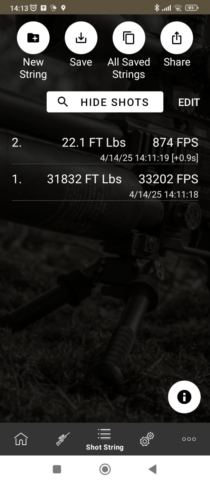

I have a 3D printed sight with a tube on top, but if the LabRadar beam is off center from the face, that doesn't help much. When I get time, I will drag mine back to the 50 foot indoor range and try again with an SD card so I can monitor the SNR. I really need to fix more pistols, not become an expert on the idiosyncrasies of my chronographs...
I've ordered another HT-X3006, but with the Wi-Fi option so I can collect long strings of data and get them into a spreadsheet more easily. I may try to put the two in series to see if they read the same on a given shot. That would give me more confidence that they are working well. It will take a few weeks to get here from China, but that gives me time to 3D print a bracket to hold a pair. I will test them with one of the Hammerli pistols that showed very small velocity variations.

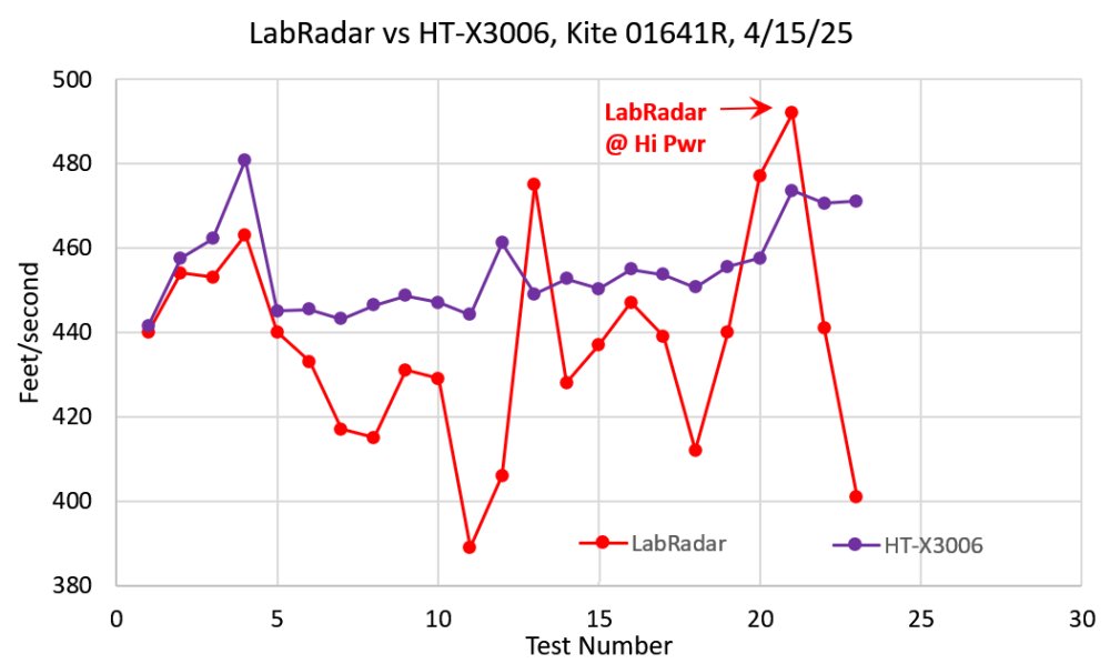

Given that I apparently can't use the LabRadar in my basement shop, it has VERY limited utility for me. Between the Garmin, the FX, the Athlon and the LabRadar LX, there are quite a few options for small radars with wider beams. I have yet to hear anyone bad mouth the Garmin, and it sounds like a few people have had success with one at short range indoors. The LX and Athlon are both so new that there's very little real info, especially for my use case.

I cannot stress enough how critical mounting is - it has taken many, MANY iterations, design updates and testing to get even a simple mount/test rig that works well to the accuracy i demand.
Something like a combro would benefit from a large/high-grip surface area with strong bands to ensure it doesnt move. Target pistol should be ok - maybe a strip of rubber to make sure between the unit & barrel for grip.
This is only for muzzle mounted units - although if a chrony is on a table which is moving/wobbling, the same will most likely apply. Careful on things like blast from air blast or powder burners.

In the meantime, LabRadar tech support has gotten back to be with some questions & suggestions. At some point I may drag that back to the 50 foot range at the college and try that again. As the weather improves, I could also try it at an outdoor range with even fewer obstacles nearby to confuse it.
