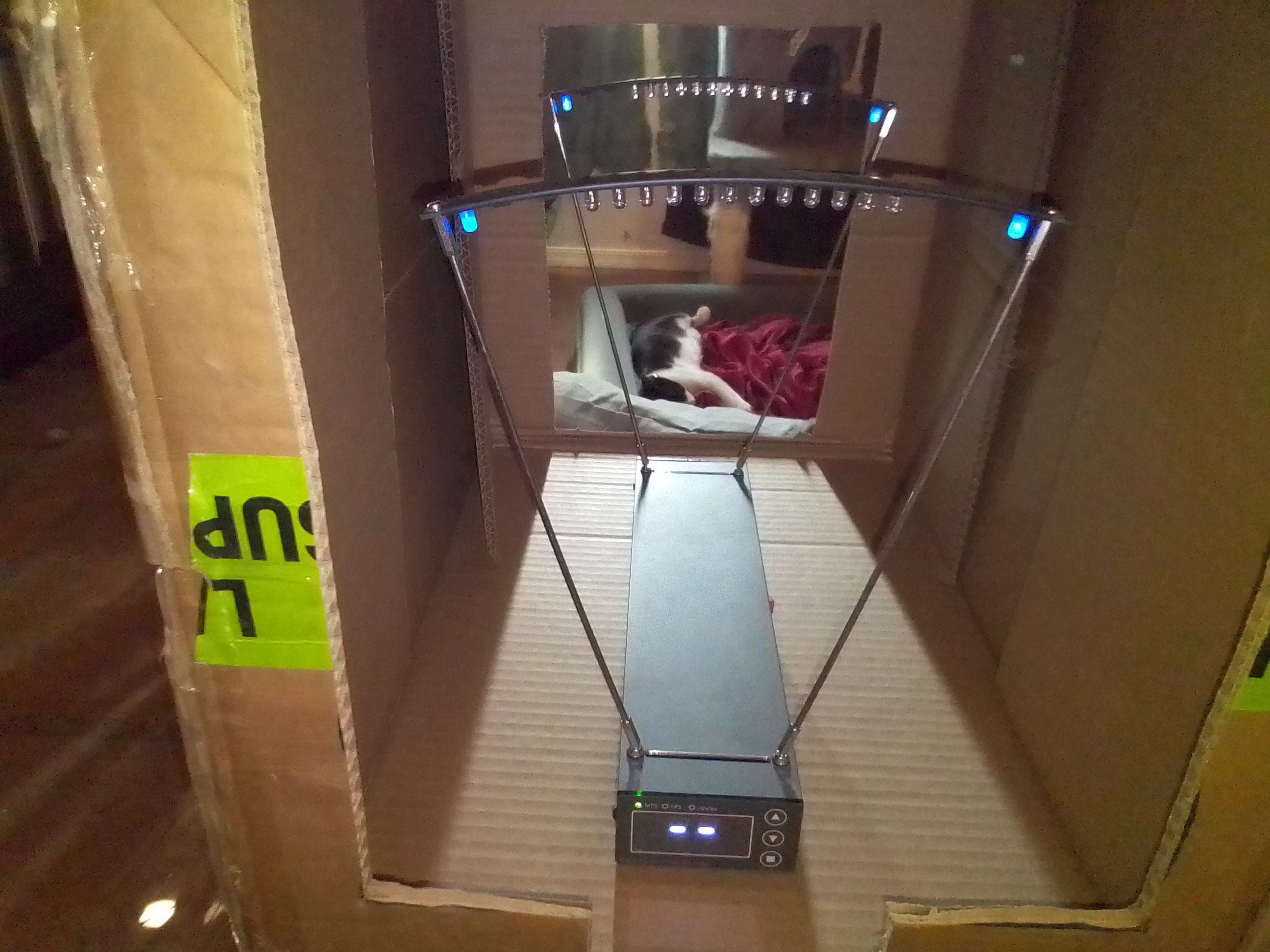

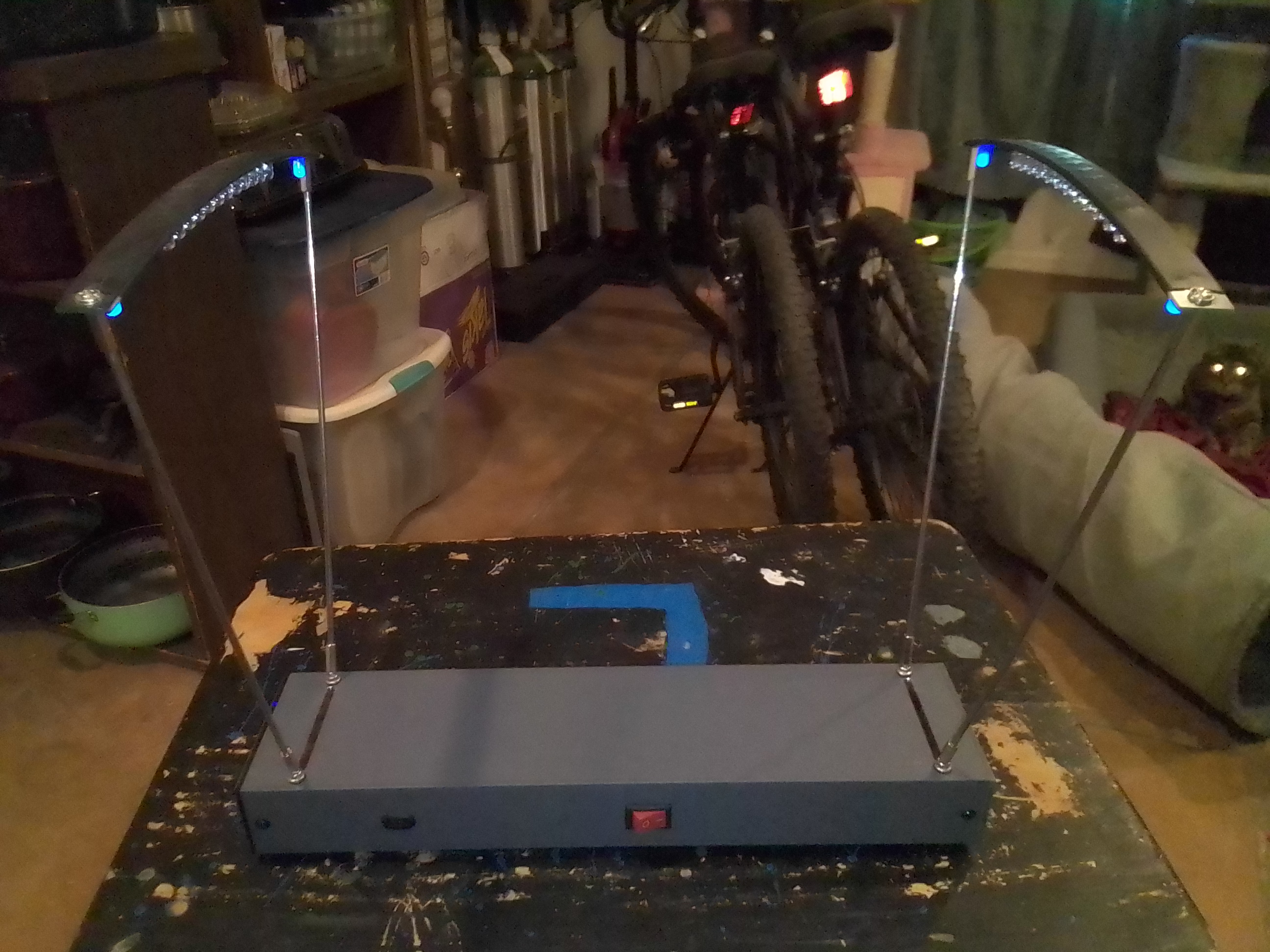

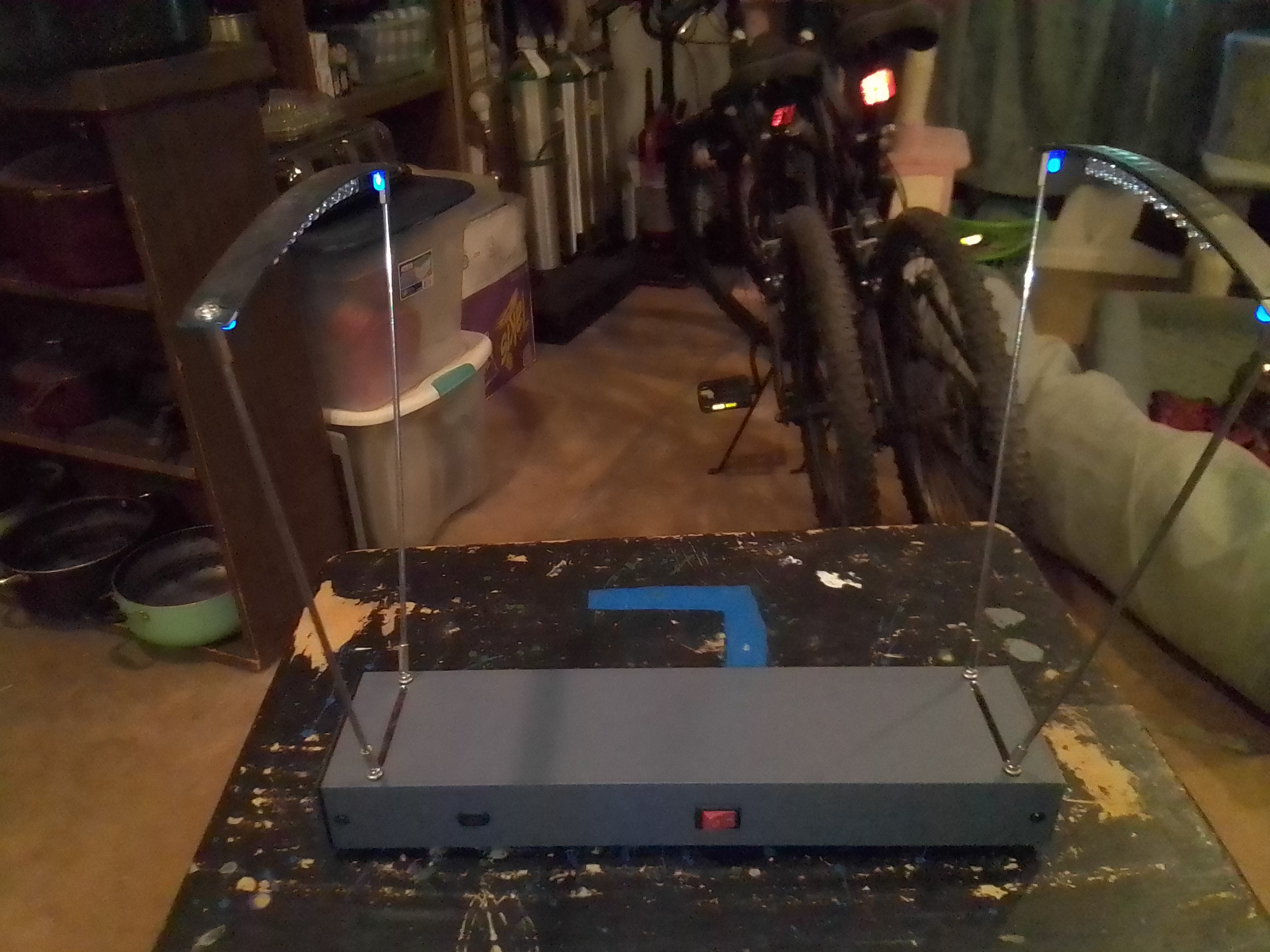

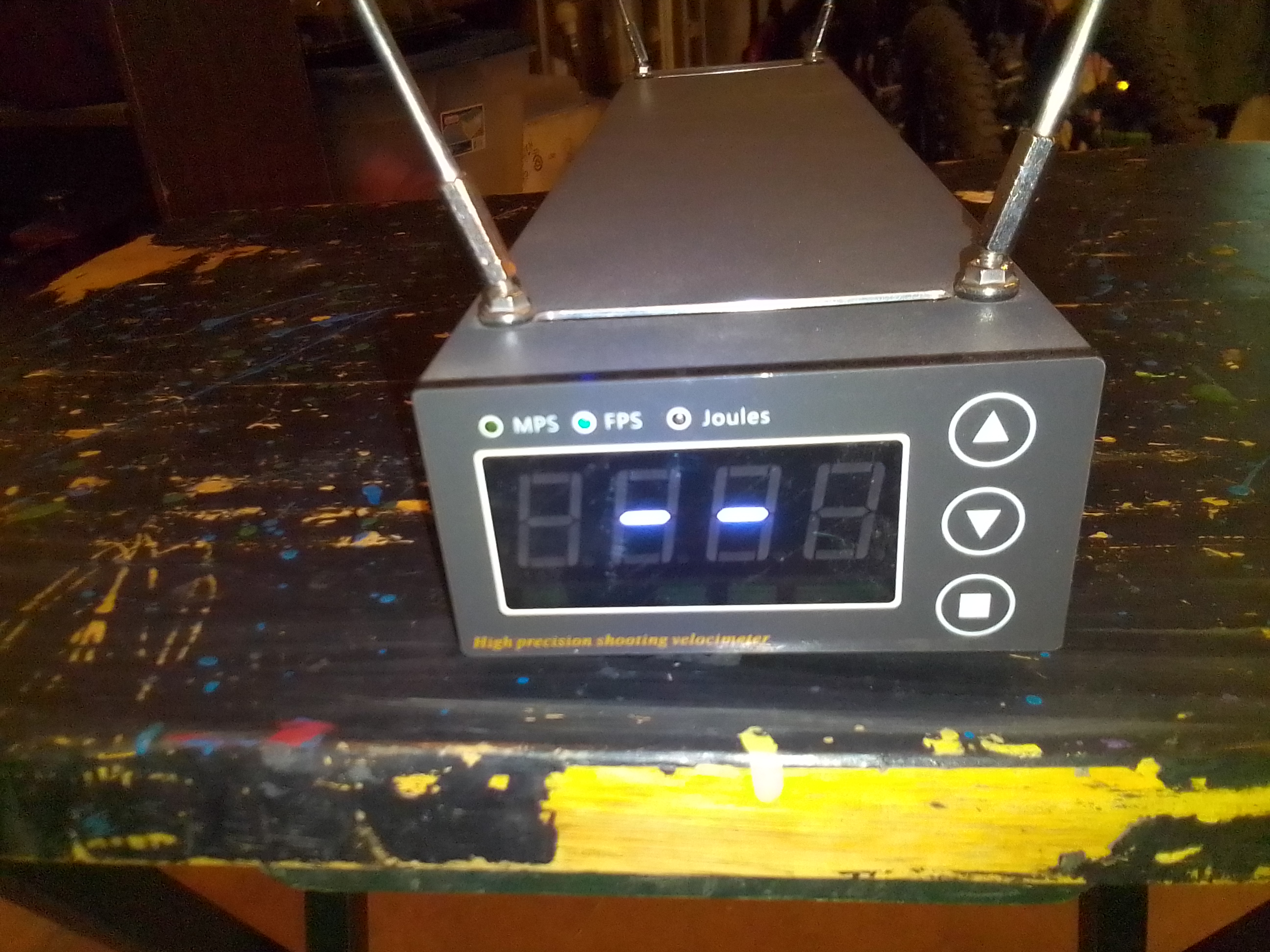

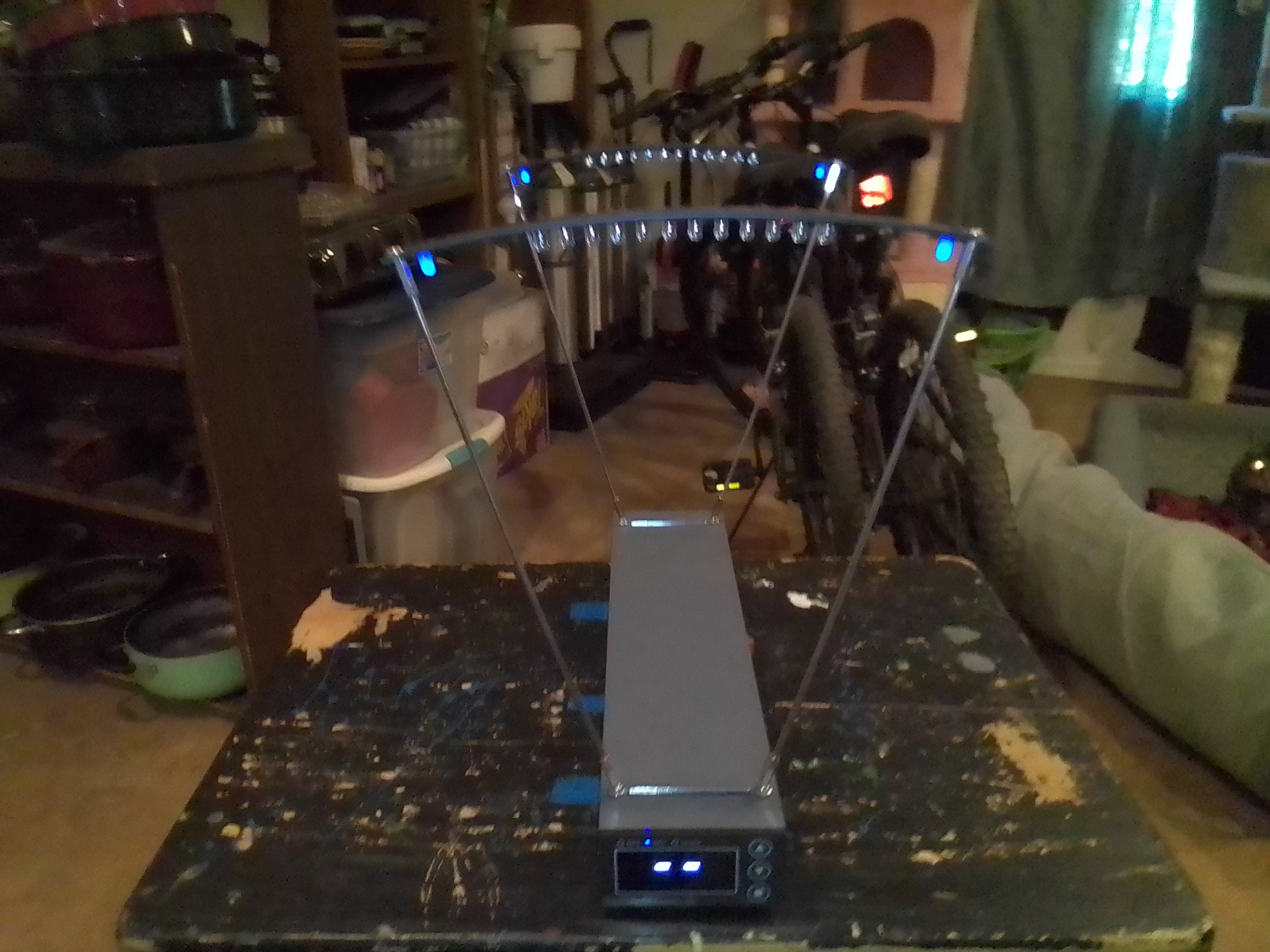

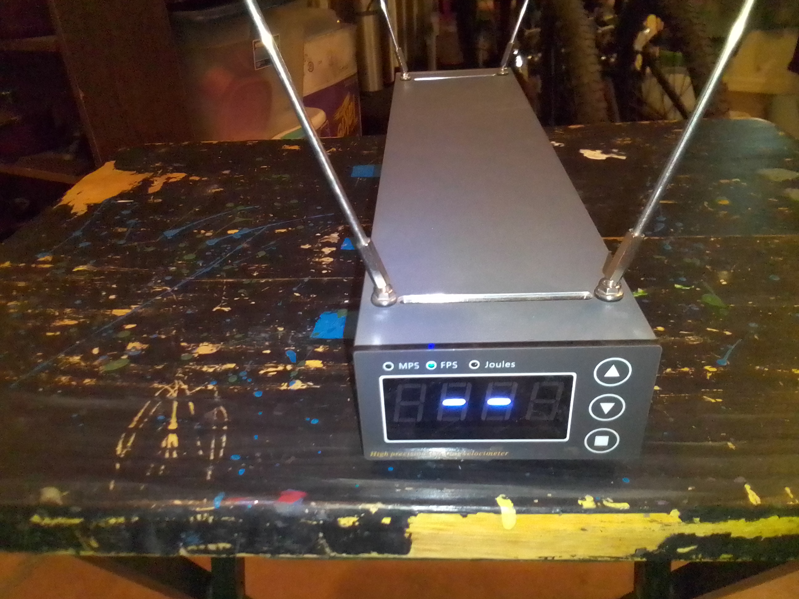

Appreciate any help guys. OV.View attachment 569501View attachment 569503View attachment 569499View attachment 569500View attachment 569502
Over the years I learned 2 things with optical chrono, primarily with powder burners too. The sensors have to be clean and dust free, the reflector hats or light source on the wire triangles benefit from a black shade. Light interference is the number 1 reason I bought the fx radar chrono. Also my friend put a 22-250 thru his optical crony I was mooching. 😂
I do not have a clue what is going on here. I have two of these and have found them reliable. I wonder if looking into the slots; are the receiving sensors well centered in the slot? Are the illuminating leds directly over the slots? I am thinking maybe a slight misalignment is giving you problems.
I use a little handheld turbine (sorta a hair drier without heat) to blow out the sensor slots from time to time and store the chrono with a little card over the slot to keep dust out.
Something is cockeyed, in my experience these work pretty well.
