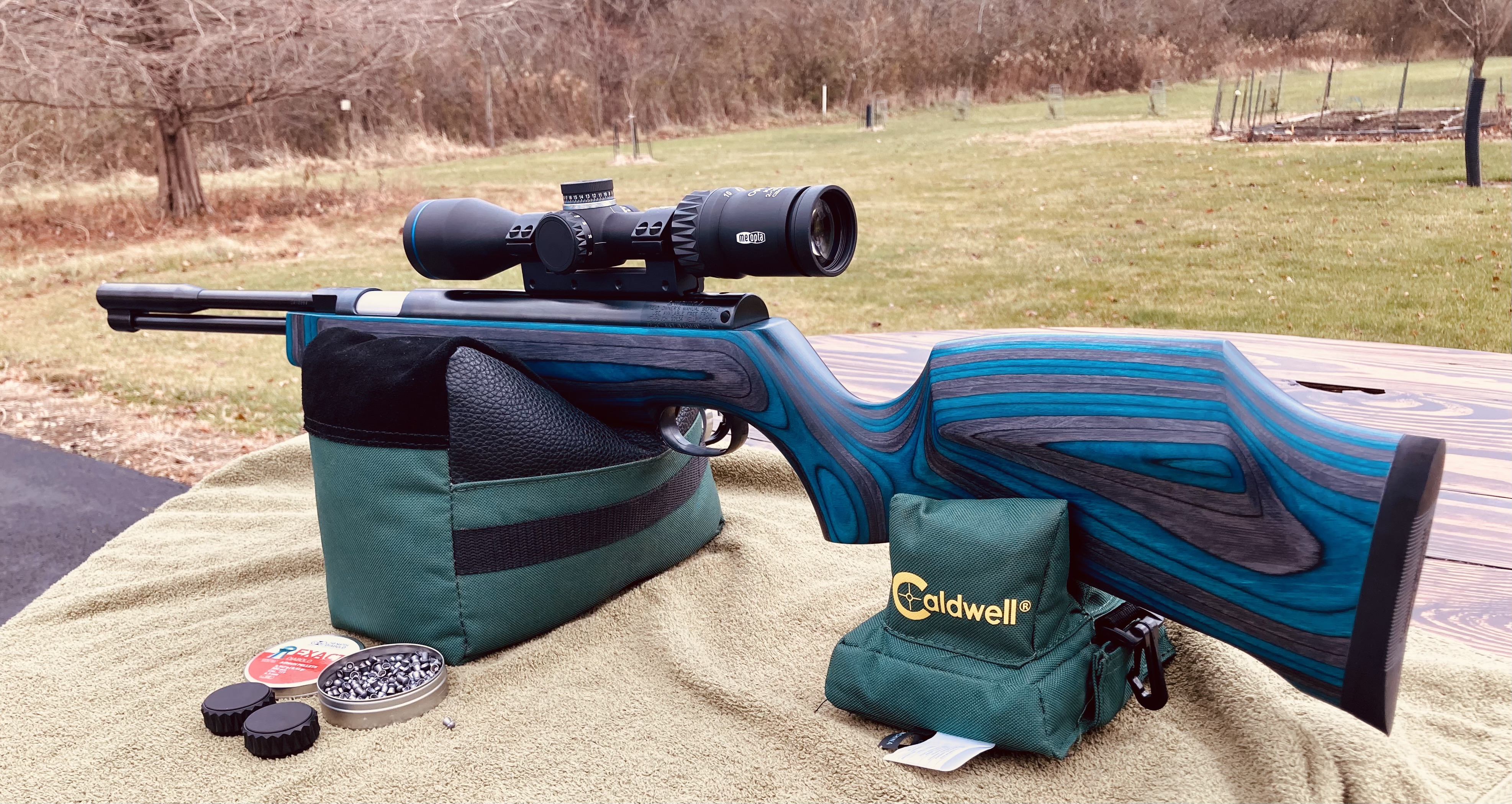

HW97K 177 new vortek Ho spring, piston seal , breach seal. High of 895. Low of. 874. Over 14. Fpe This is a great improvement from 11 fpe. My HW95 Lfield pro 177 New vortek Ho spring ,piston seal, breach seal low 835. High 844 over 13 fpe this is lower than the ARH spring. Which produced over 14 fpE Both are shooting great , both have around 200 pellets down the tube Since new springs
Good outcome and I’m glad that you are pleased with both guns. Also worth noting that although both guns have the same power plant and Vortek internals, you are getting some variation in power. The inherent mystery of spring guns 👍
