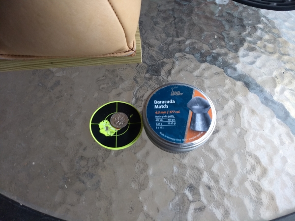

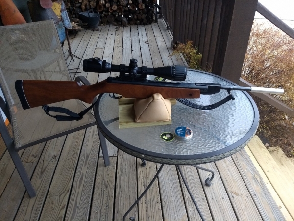

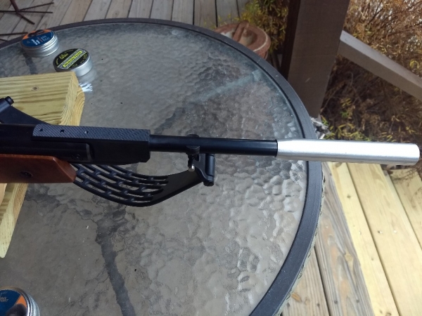

This is the model 45 with the 34 action. I chopped the barrel down to 14 inches recrownd and put a sling on her. Now I have a sweet German carbine for hunting. Shot two groups tonight in the cold this is the 20-yard group. It was under a quarter inch the 30-yard group was about nickel-sized. Both shot off of front bag sitting. So excited! She has kept all her accuracy. I did the brass screw
crown with the grinding compond. It worked excellent. Couldn't be more pleased. I've got a 12 foot pound vortek kit coming for it. But I don't know if I want to ruin a good thing! Shooting at 14 foot pounds right now.
