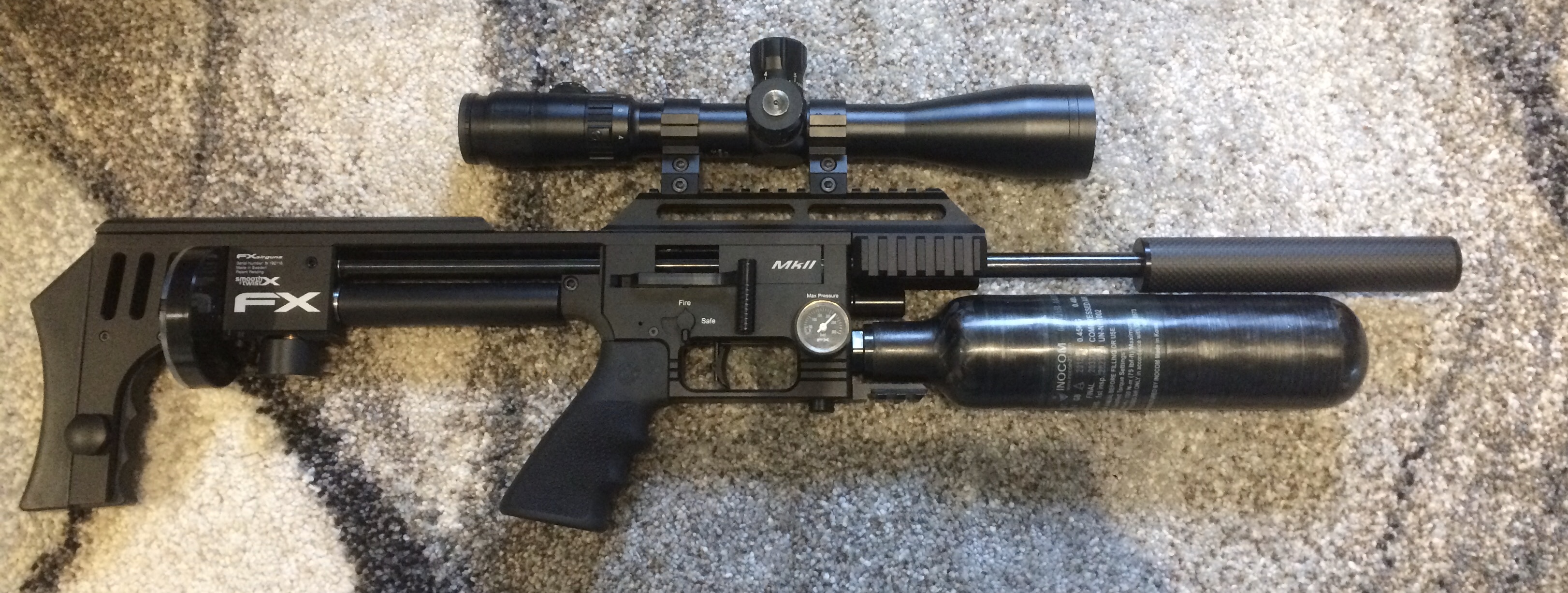

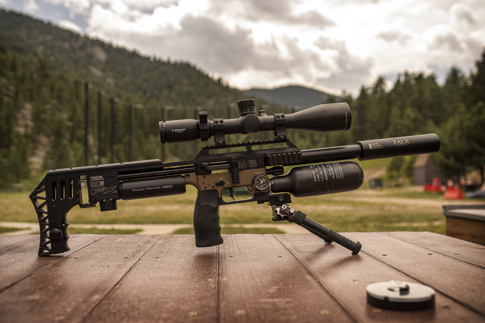

Went with the STO Falx myself.
Liked the thought put into the noise suppression with actual baffles compared to just felt and washers. I also liked that I can buy separate baffle stacks when improvements are made.
Sound suppression is very good at 30 fpe that I am shooting right now out of an FX Impact M3 Compact .22. Once I tune up the power for slugs, I'm sure it will still be very quiet.

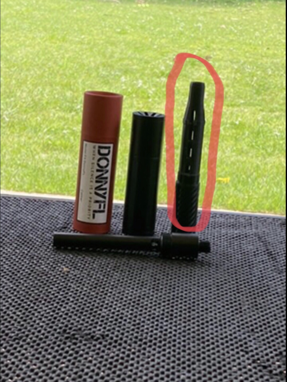

I am also a DonnyFL guy. Since I am not a physics or math person, when I look for a moderator I generally ask Donny. He generally tells me which moderator he thinks would work best to minimize the muzzle report for the particular airgun that I am looking at. I have several Tontos, a Sumo, a Shogun, a Tatsu and a Ronin. I have no real data aside from sound meters for relative readings which I do not consider especially accurate, but they all really quiet my airguns. I've been happy with all of them and would not hesitate to ask for advice from Donny again for my next airgun.

They don’t have it listed on their website, but email DonnyFl, he might be able to help you out with an adapter.

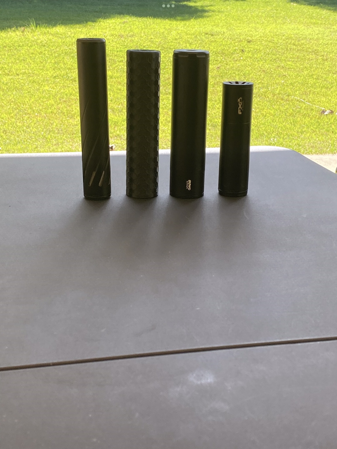

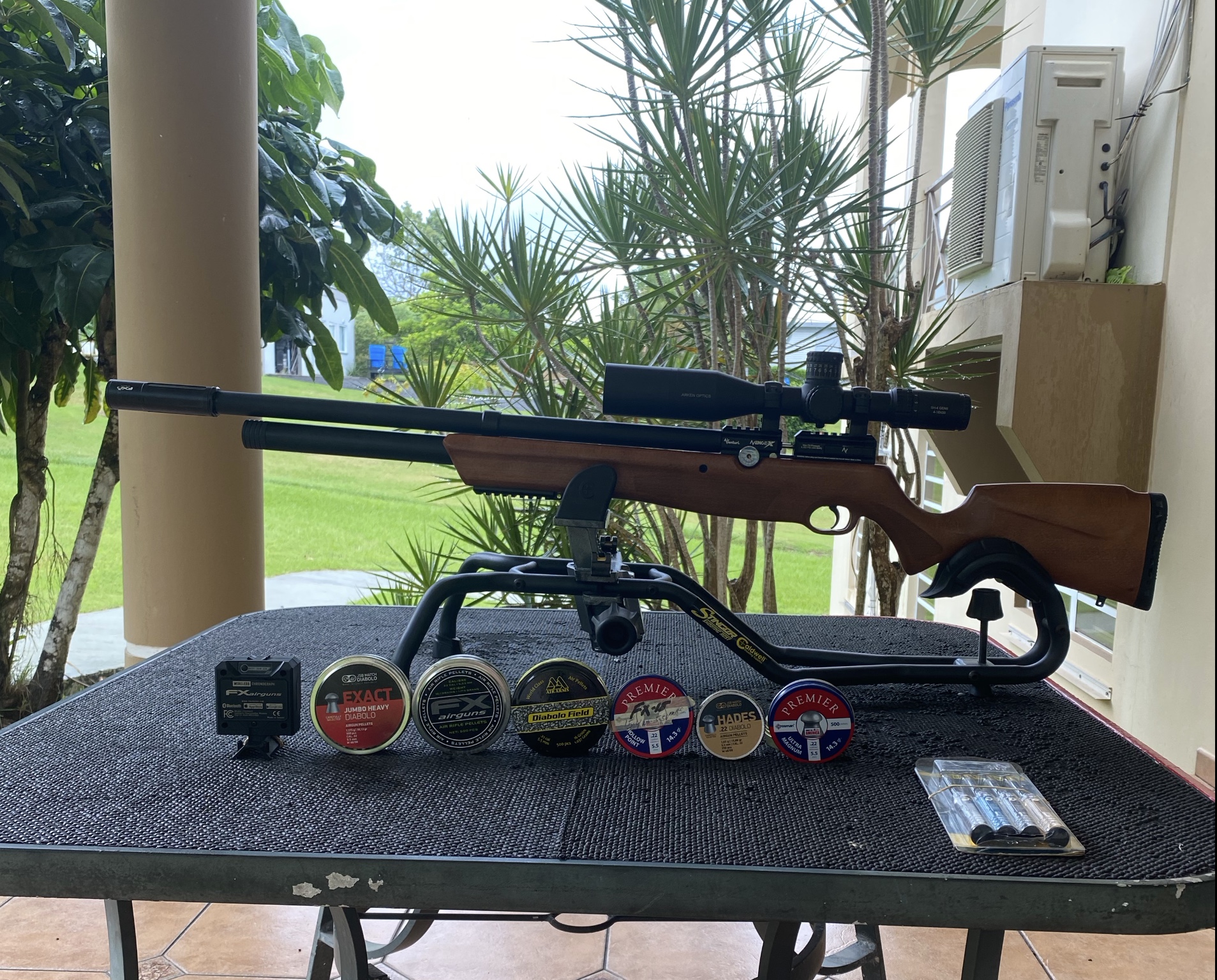

Since I live in a extremely quite semi-private neighborhood and only use my airguns in my backyard I have done a lot of testing with different moderators. In one of the pics from left to right are the Hugget snipe, the 3D printed Buck-Rail, the DonnyFL Sumo and FX moderators. In another pic you can see the DonnyFl FX next to my other 3D printed Cameron moderator. From my experience starting from the most efficient to the least in this same order are the Hugget snipe, followed by the DonnyFL Sumo, the FX and the two 3D printed moderators the last ones.
