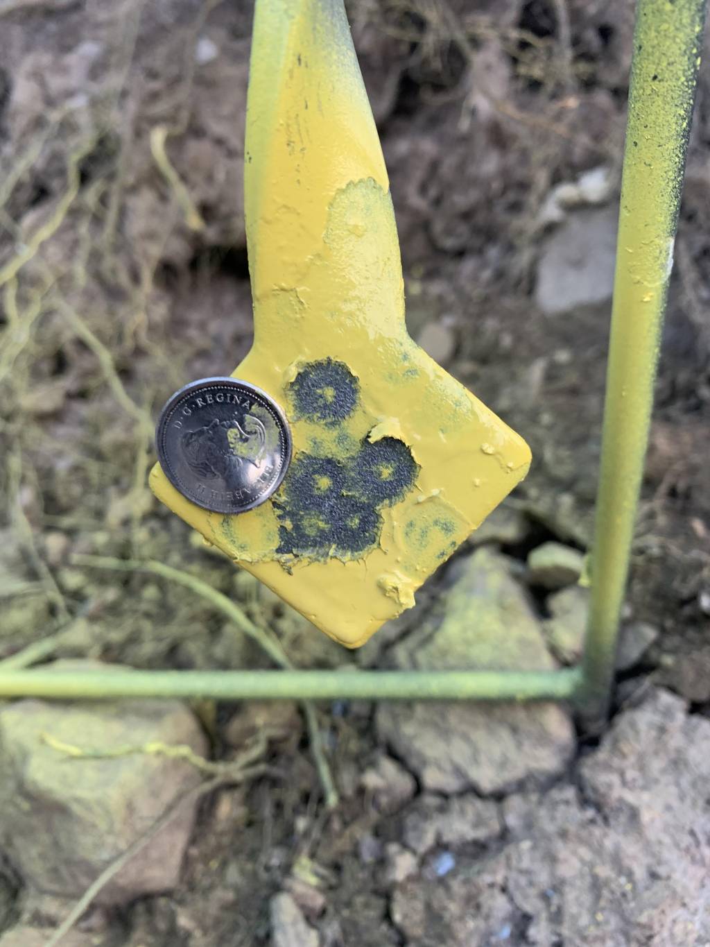

HW 98 .22. You’ll be taking back stuff you didn’t even steal. Meets all criteria. Very accurate, easy to operate and quiet. Crow
Not greatest shot. Had 10 min. 25 yds. Pulled one. Out of box (700-800rounds) Destroys squirrels 🐿 and starlings.

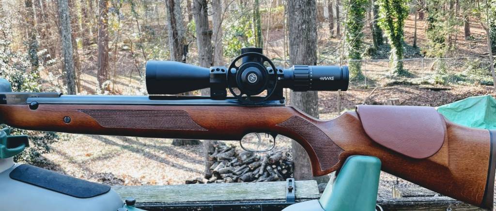

The only Weihrauch rifle that I have any experience with is the HW95L .22 which is a fine/accurate shooting gun. I am 82+ and really enjoy plinking from the back deck and i highly recommend this model & caliber. I am able to shoot MOS out to about 25/30 yards using the H&N FTT 14.66 gr pellets. My wife also enjoys shooting this rifle and the Hawke scope has the IR feature. This is my rifle.
