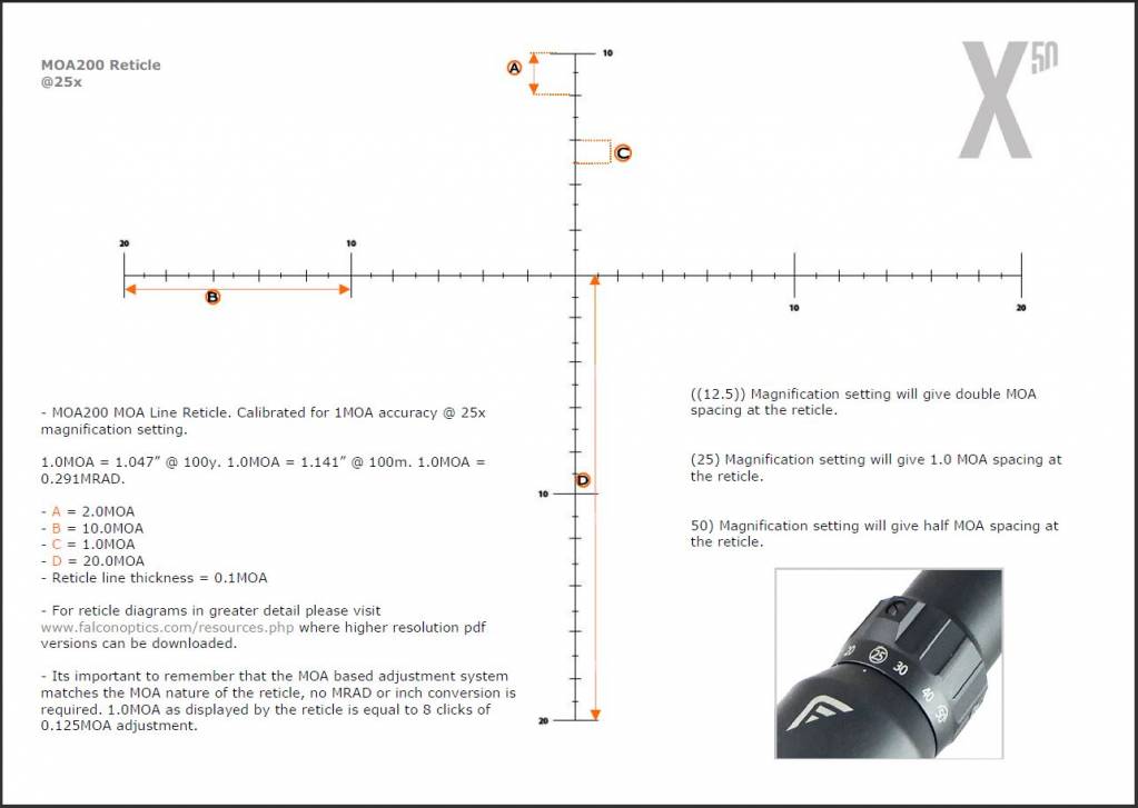

Falcon X50 SFP, crisp clear all the way to a max power, backing to about 40-45 power to see all four target rings in a view @100. Some reviews saying this scope is 1000 meters rated.
The reticle is simple FT not clustered, just perfect for a job what I am using it.

I read some reviews in the past that Sightron and Falcon using same glass and internal mathematics, but only Falcon is assembled in Japan and Sightron somewhere else in Asia maybe in PRC.
The Sightron exterior cosmetics is more fancy, the Falcon is more a simple design.
Within a same price range (Sightron has several variations in same power but higher priced models) the Falcon clarity is all the way to the end vs the Sightron which you can have it cristal clear only somewhere up to 40.
Definitely the x50 power is a game changer for 100 and beyond.
