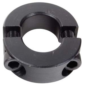

I think it might work, but you'll probably need one of the big ones that are used for galvanized or steel gas pipe. The little ones meant for copper just aren't going to have the compression necessary.Sounds like a good idea, l have one of those.
