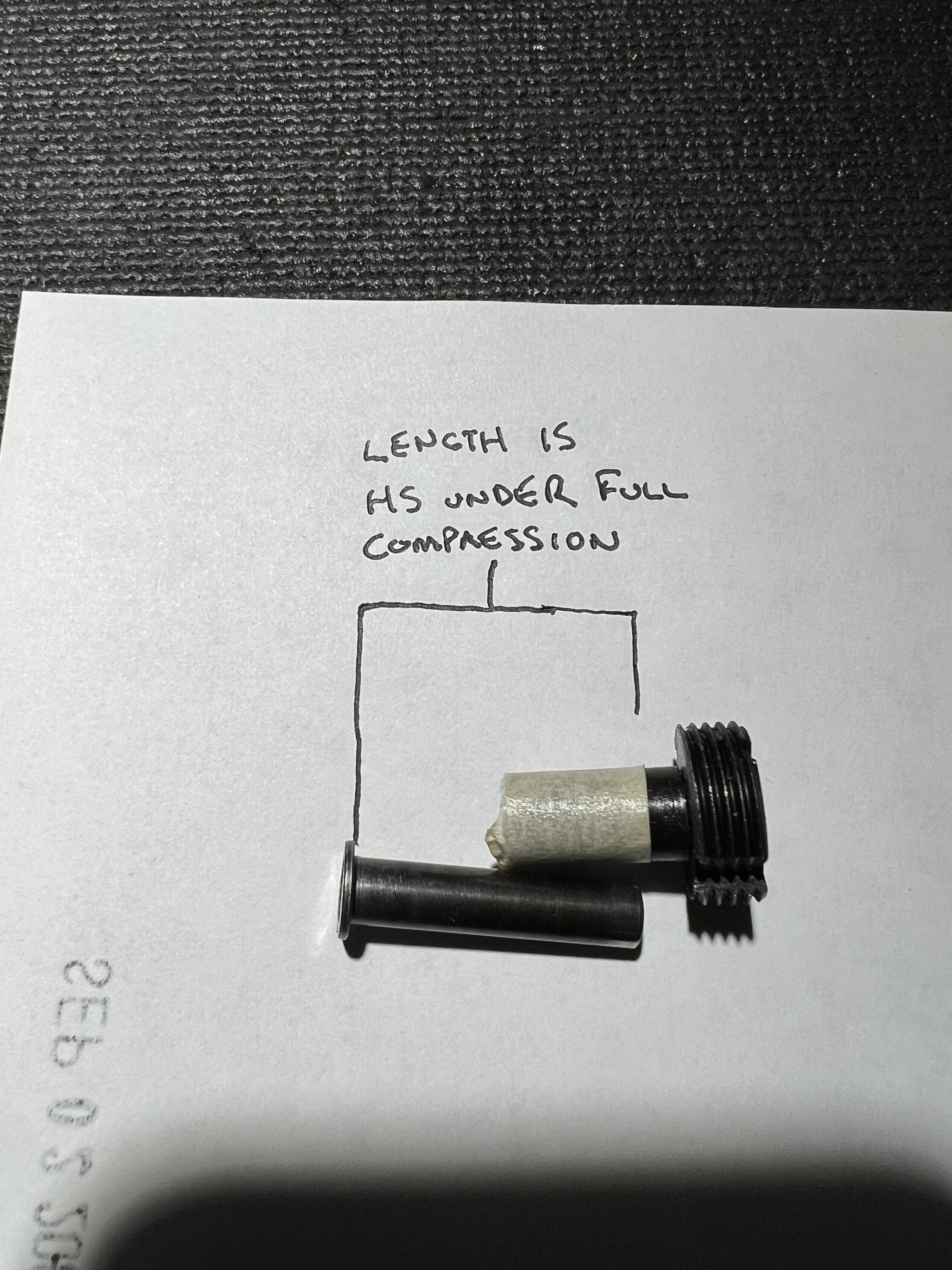

So you’re dealing with something like this. What if you use a weight like the other thing in the picture. It’s a hammer weight out of one of my RTI’s.
You will cut 90% of the stub off because you’ll still need a small post for a guide. But at least you’ll get the max hammer weight possible. Just need spring OD, ID and compressed measurements.
I had something similar in mind. This setup would add the weight and it just transfers the spring guide onto the hammer side vs the adjuster. Nice!

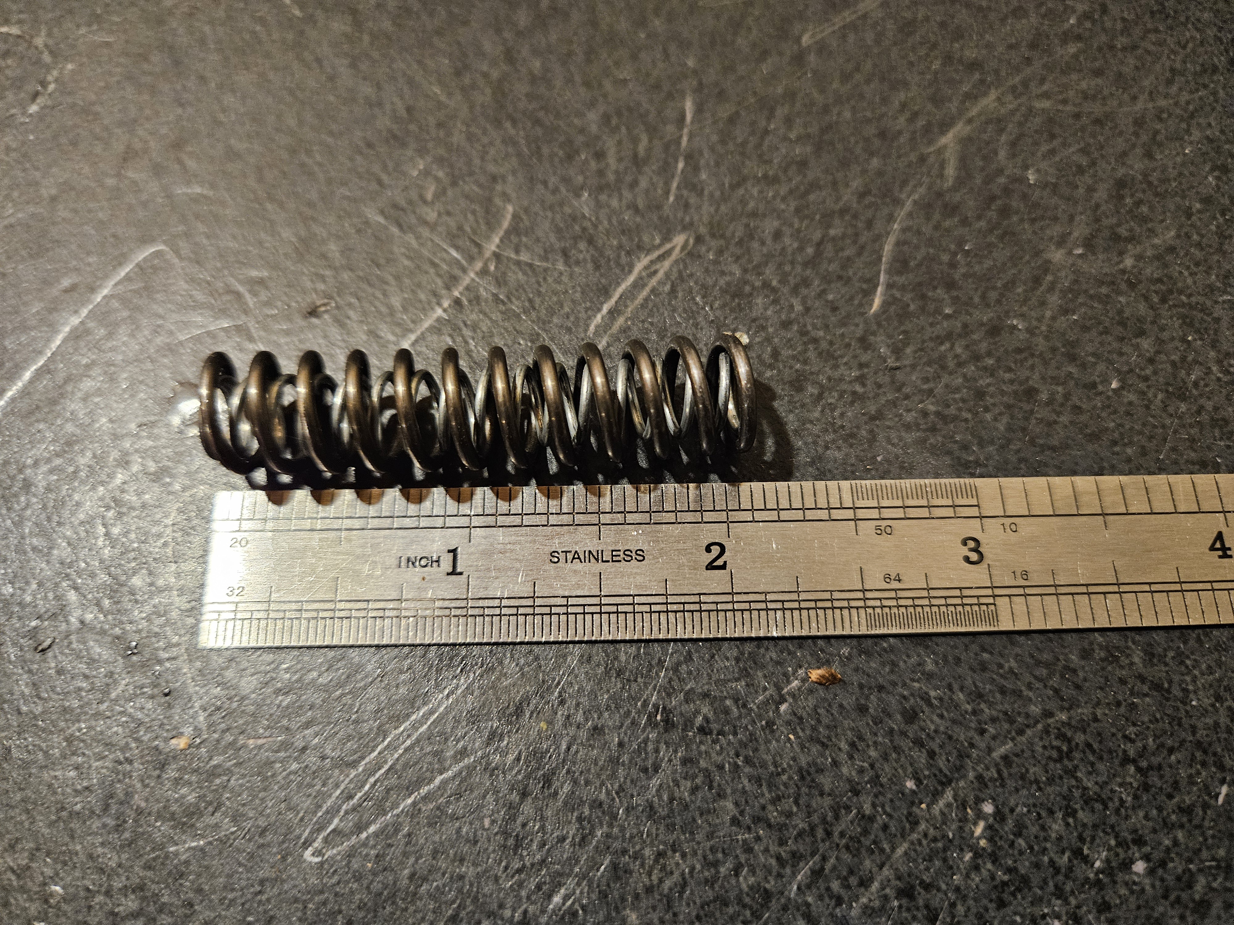

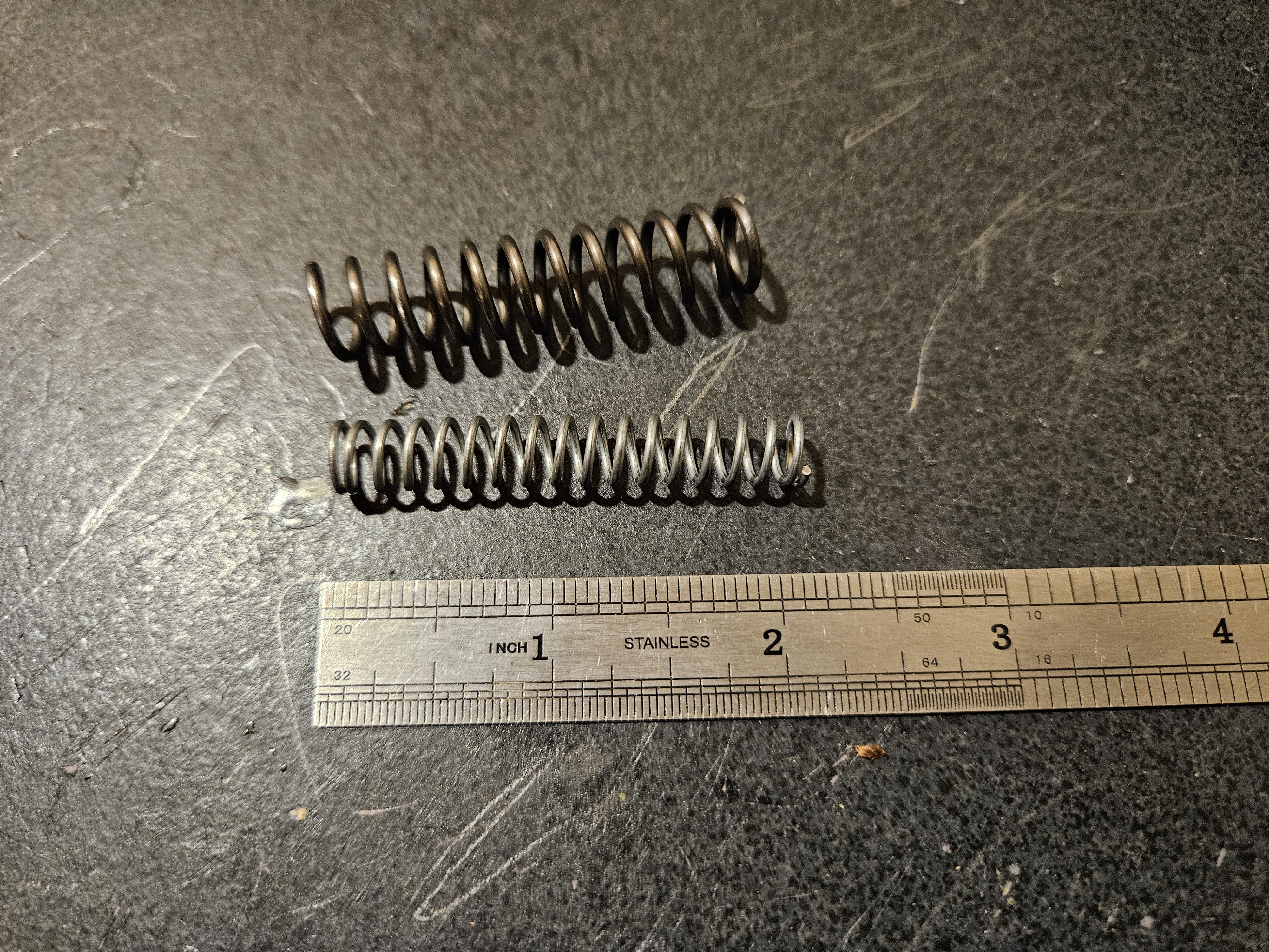

Here are the current springs that are in it.
You can imagine how hard this thing is to cock, even as a side lever it's ridiculous.

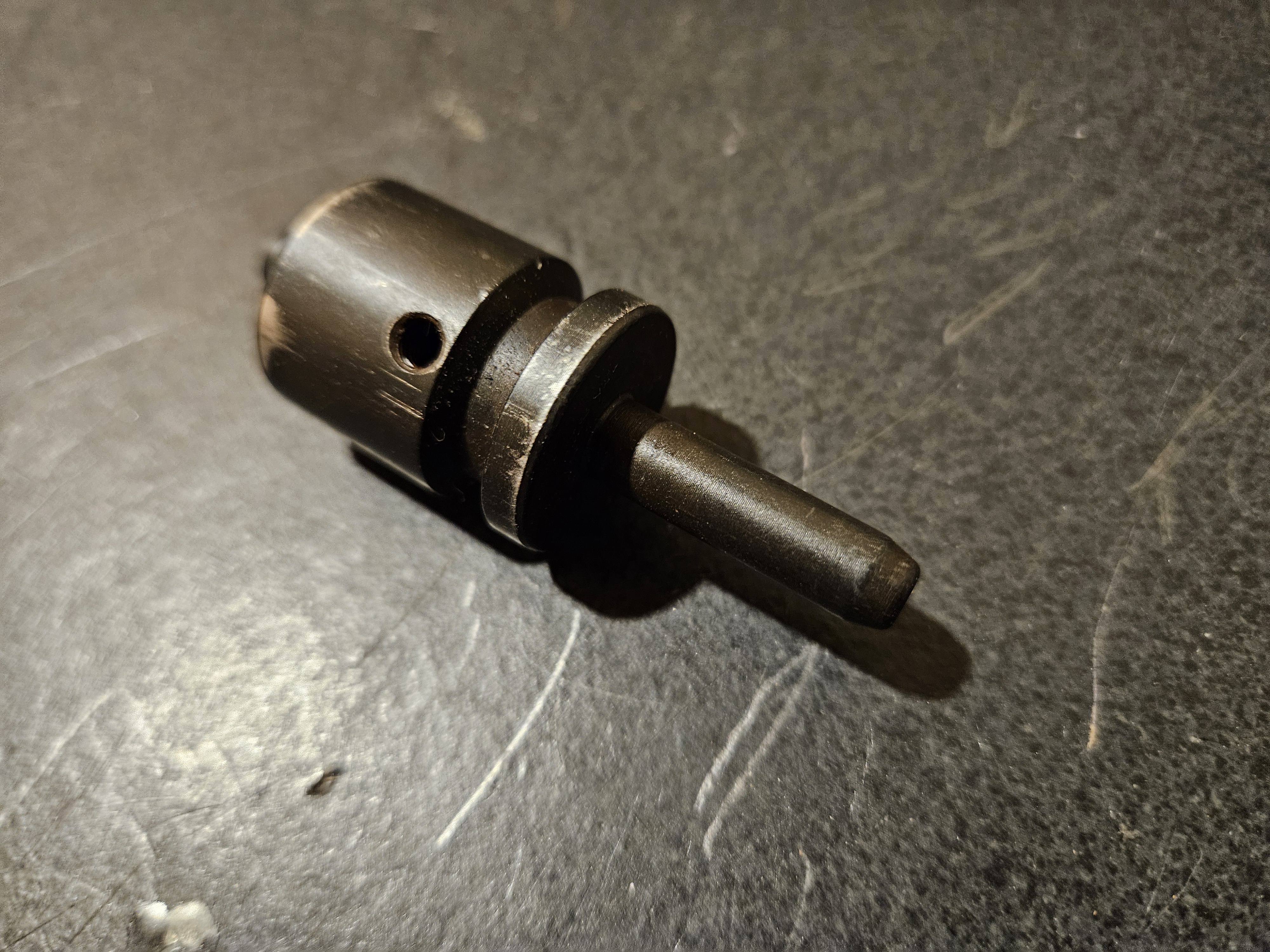

I'd like to get down to one spring and a heavier hammer. I do have the old hammer from my beeman 1358 with the spring guide that's on the hammer. I could cut it off and turn it down to fit inside the Kral hammer.
Looking at the travel you have to work with, I don’t think you can add much weight to the hammer. Even if you cut down the guide and make one like the one in my picture. Cracking a valve at 300b and getting enough dwell for a 23” barrel is no joke. You may have flown too close to the sun with the tiny receiver.

If you could measure the hammer weight, throw/distance of travel, and both springs OD, their wire diameter, and active coils (I could count these from the pic above as well), I could give some current hammer energy data, and likely what needs changed.

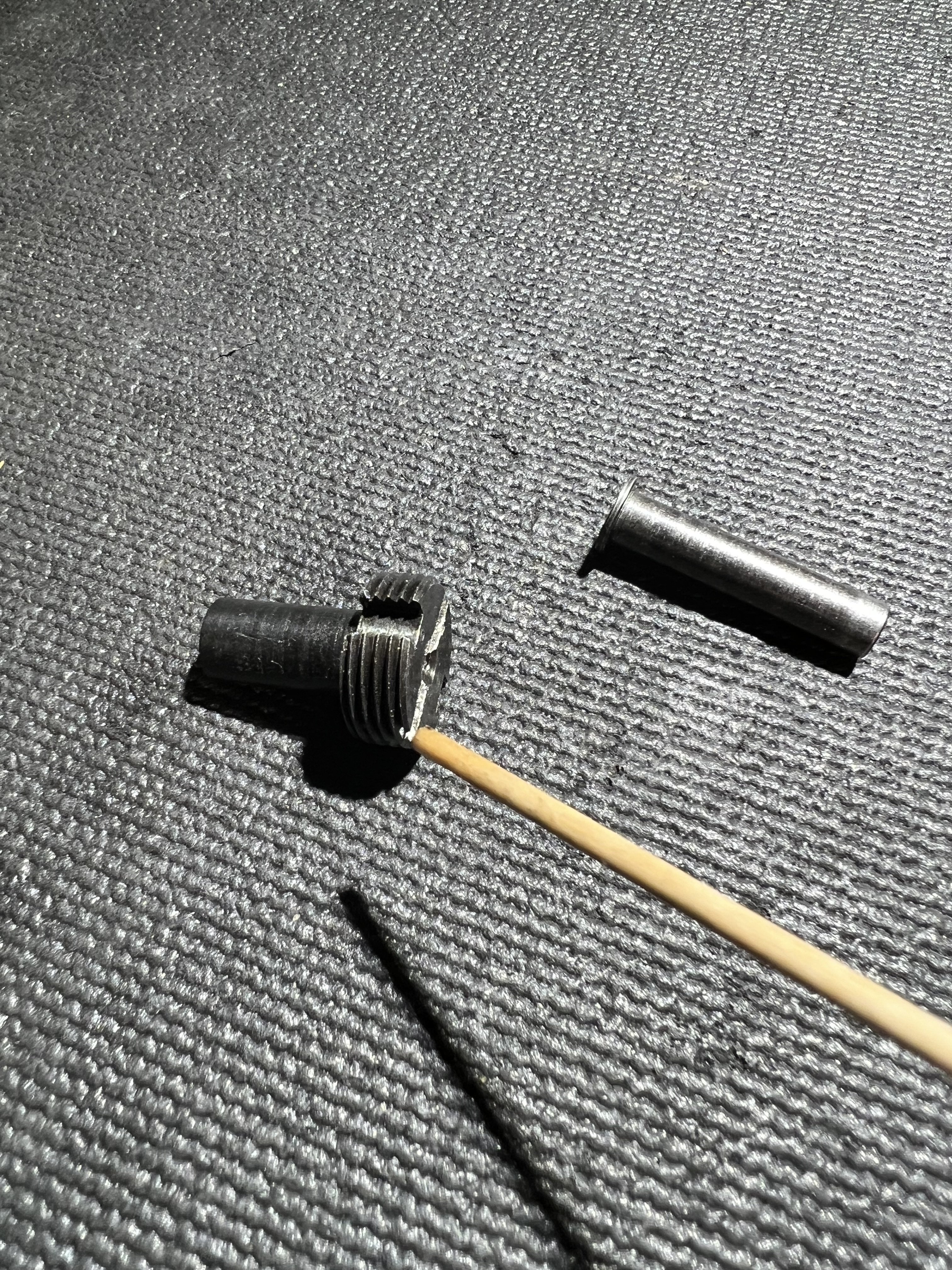

Take a picture of the back of your block and where your HS adjuster goes in. It looks like it’s held with a screw. Just a screw from the bottom?
