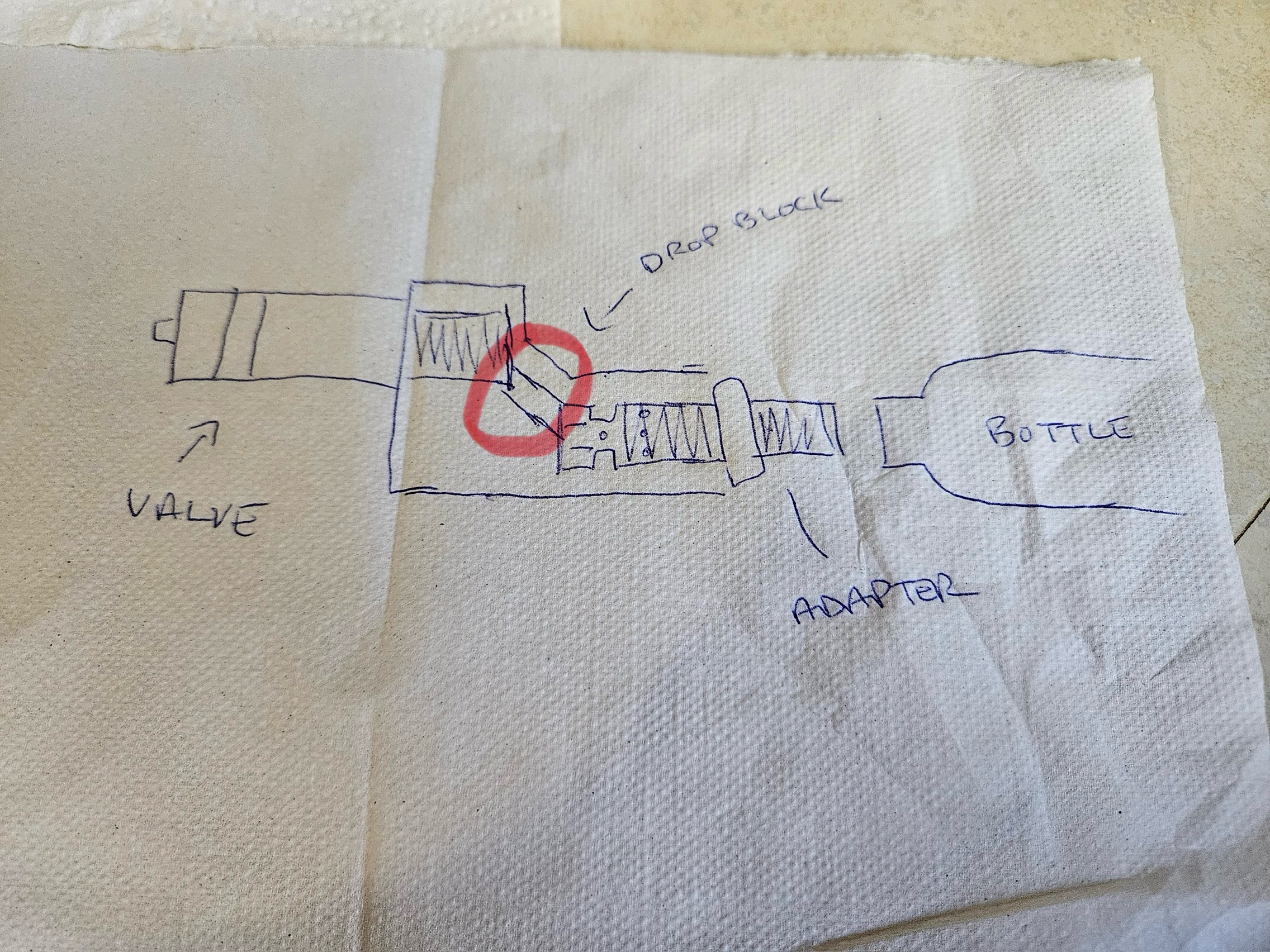

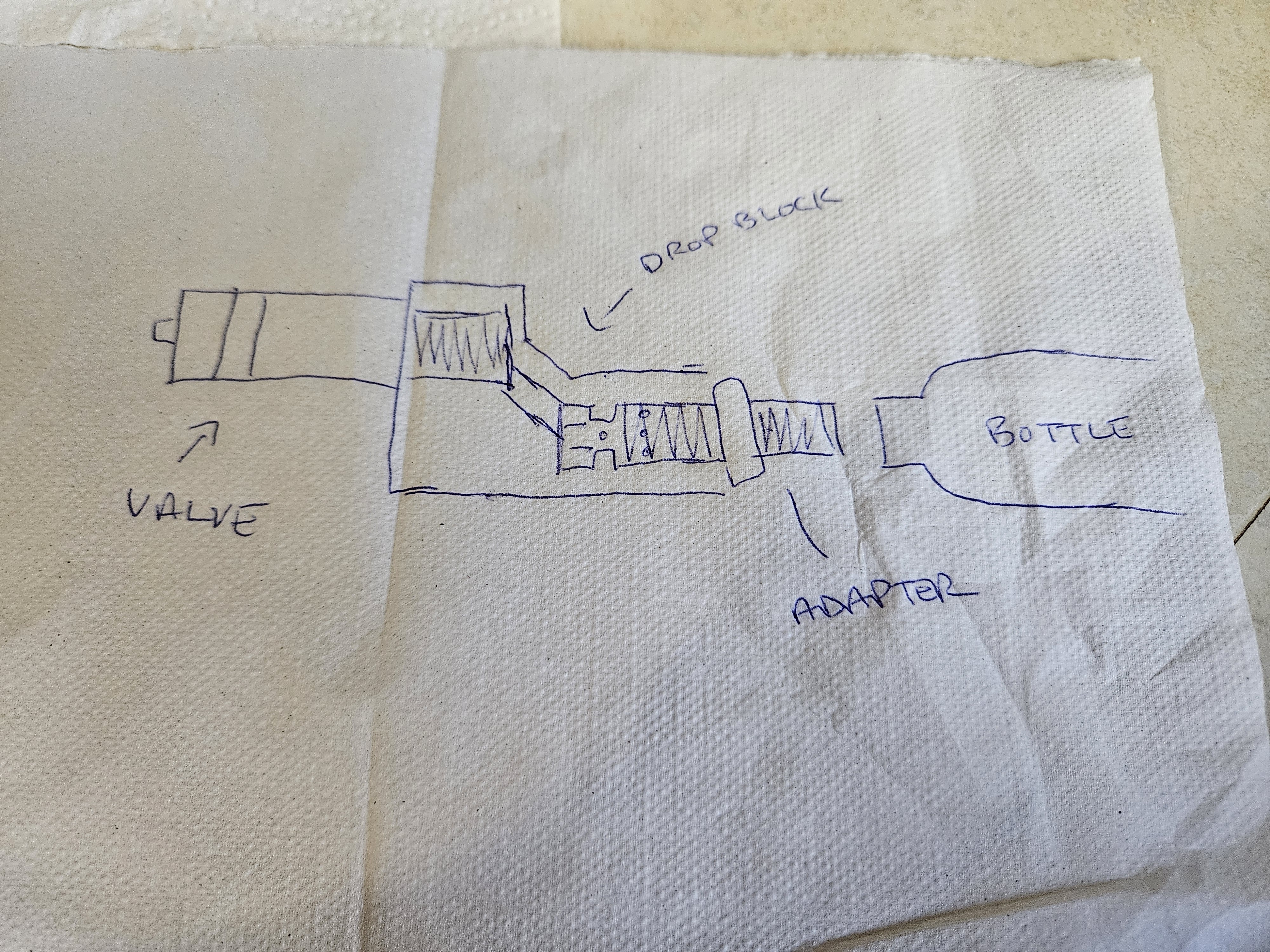

This is what it looks like.
I might cut that front section off so it gives a cavity before the angled transfer area that goes up to the valve. Plenty of threads on the other side to bite. Then I could open up the adapter section to probably 3/8".

That looks like you came over to my house and drew on my napkin with a red marker!

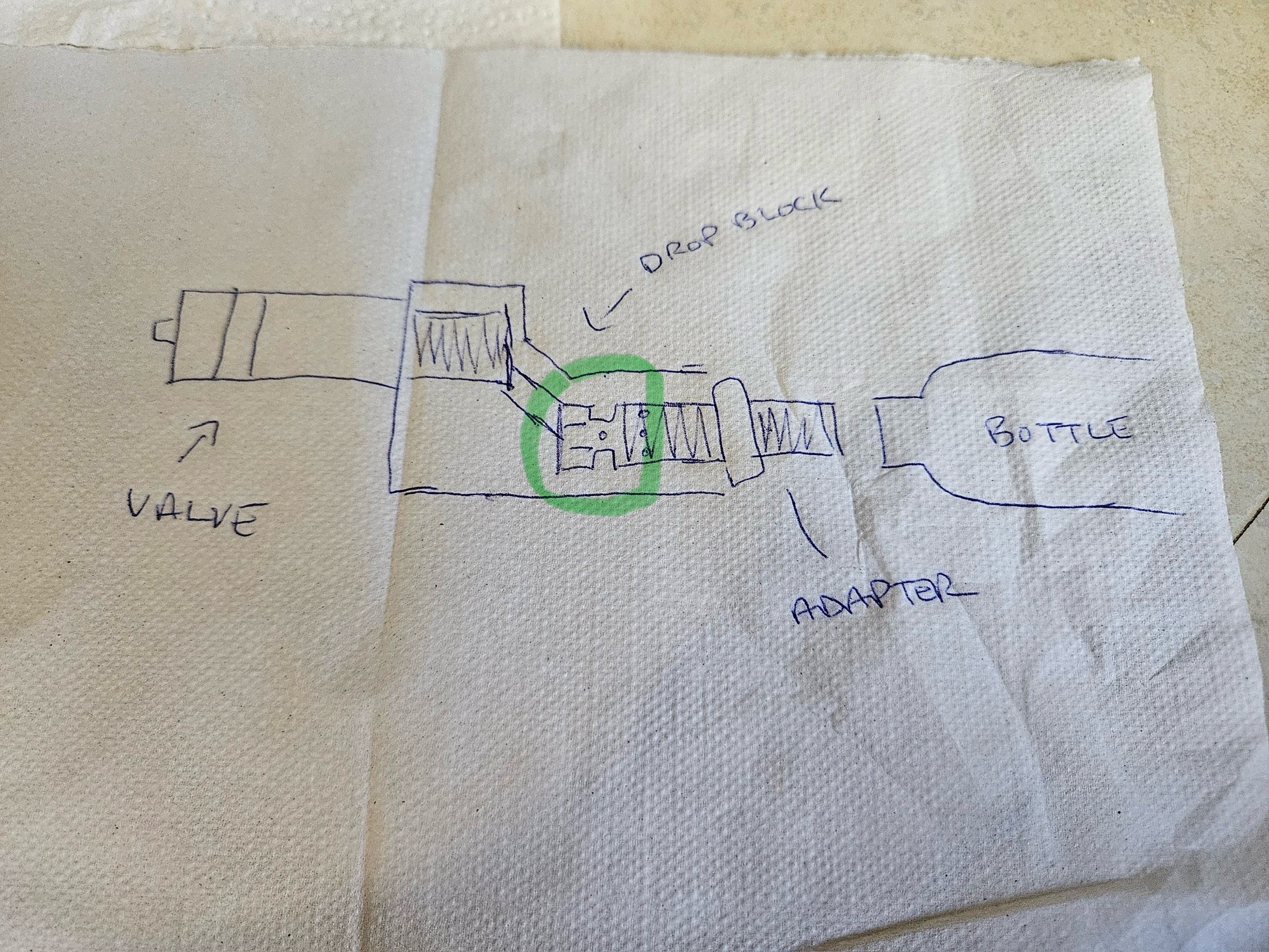

I just cut off that silly like front part of the block/bottle adapter and ported it up to 3/8". I got it all back together and no leaks, walking the bottle over to the action, and the bottle to adapter o-ring blew out. Nearly soiled myself.
It was a limp noodle, guess going from zero psi to 300 BAR all in one fill overheated it. The Yong Heng is getting a workout today!
Gonna draw on your napkin again. So you cut this off? And yes, full fill to 300b will generate some heat. Hopefully that’s what pushed that oring.
Yep, that's what I cut off, so there is more space before the transfer tunnel area. I actually LOST power. It's now only in the 715 fps range. Checked the chrony, it's spot on with my other guns.
That transfer area has got to be the limiting factor here.

One possibility is that your valve now is fighting more pressure during the shot cycle opposed to the prior arrangement which experienced a ton of pressure drop, which means less hammer strike was needed. Can hammer strike be increased?
