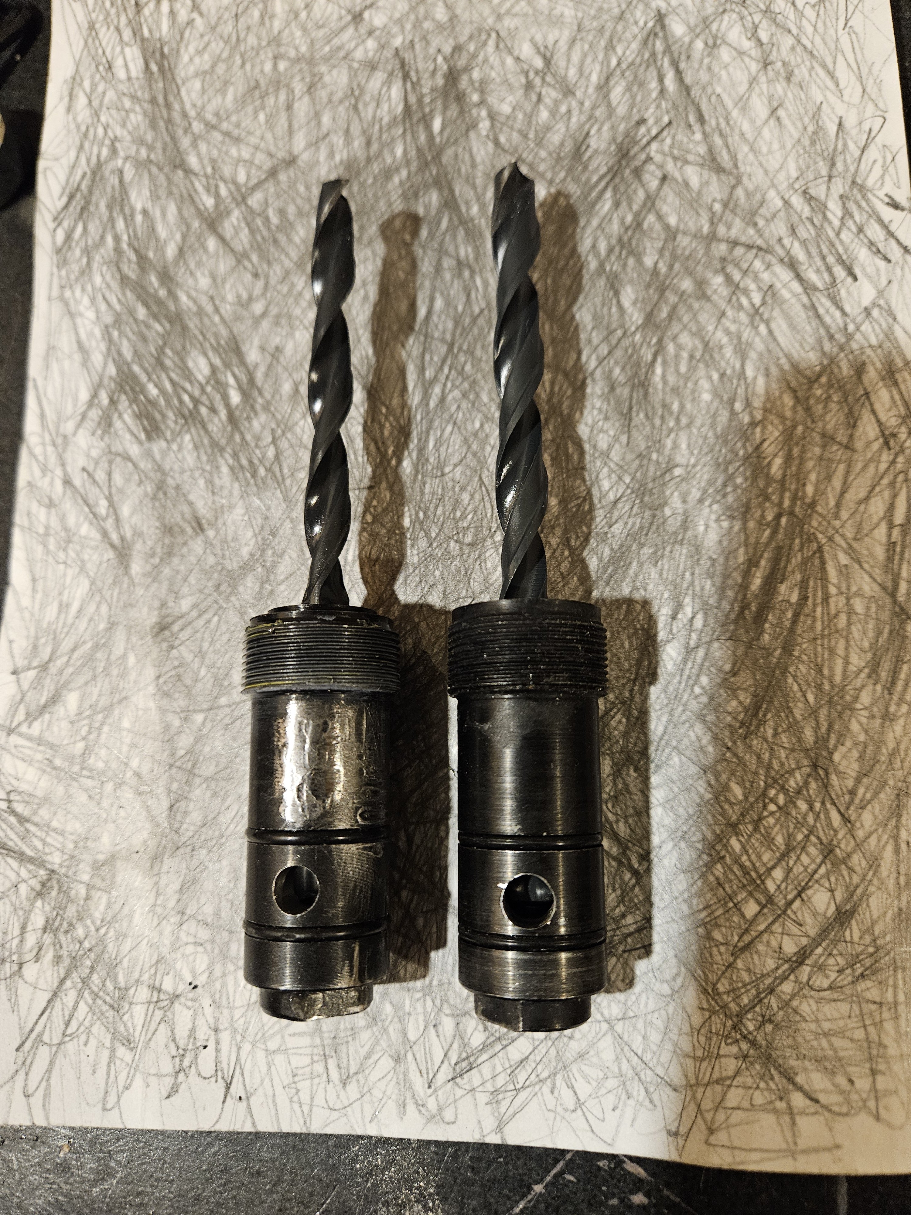

Took the action apart again and measured. The stock ports on the barrel and bighorn valve are 6mm. I currently have the block and another valve off a jumbo ported to 1/4 or 6.35mm

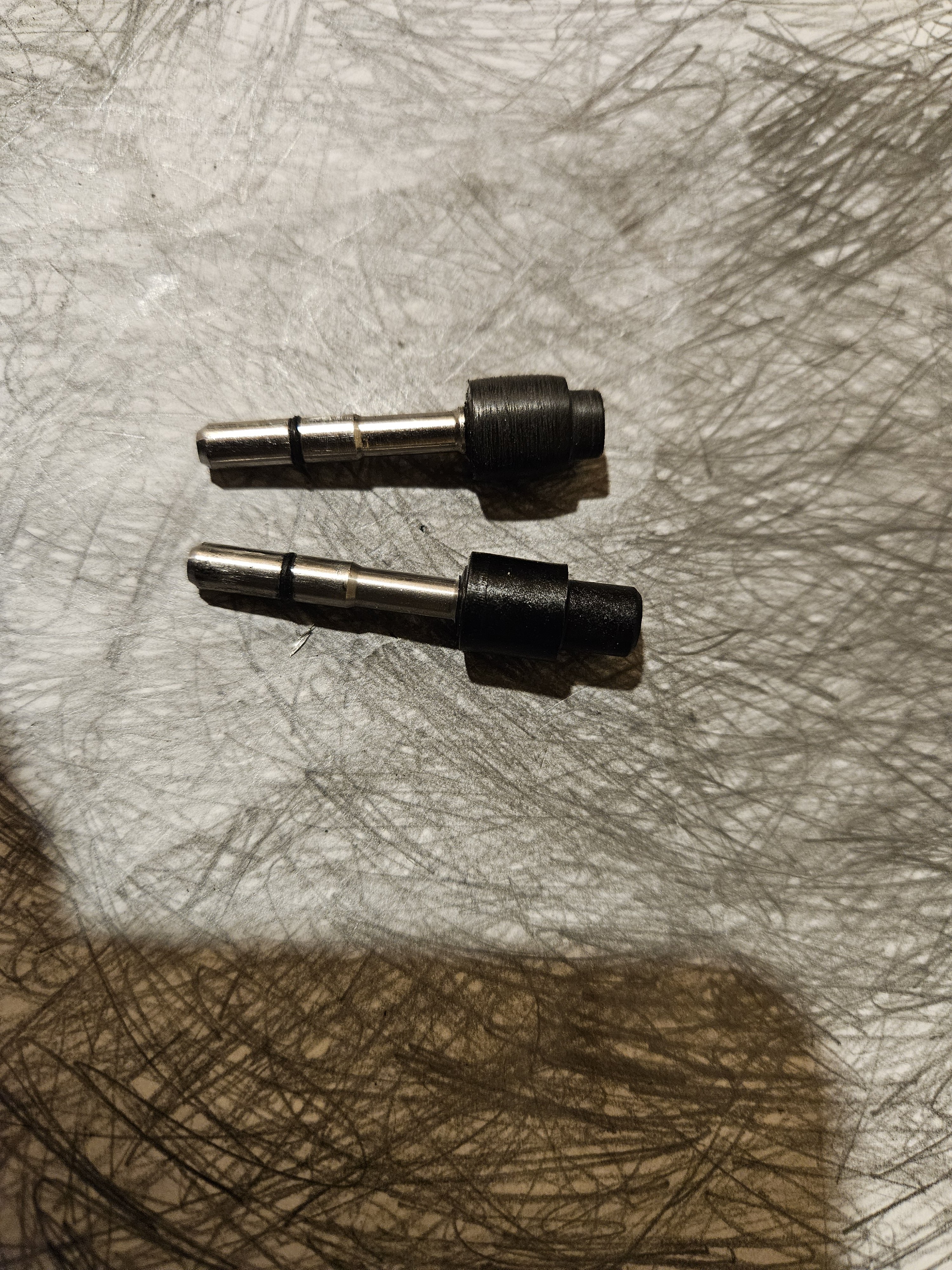

I turned the jumbo poppet down to match the bighorn poppet which is smaller OD. The throat was about 7mm on the bighorn valve, and I ported the jumbo one to 5/16(8mm). The internal volume of the bighorn is actually smaller than the jumbo valve.
I then ported the bottle adapter piece that goes between the drop block and bottle. Stock hole was 6mm, it is now 8mm. The thru hole to the valve I cannot go any larger, it's currently a loose 1/4", but can't get the next bit in it all the way. So probably 6.5-6.6mm

I was going to just swap the BH valve poppet and stem into the jumbo valve, but it's just slightly larger OD stem. So that means the jumbo valve stem will be lighter. Hopefully it doesn't break!
Another thing to note. The throat on the BH valve (on the left in the pics) doesn't stay the same size all the way to the exhaust port. I drilled all the way to the end of the the throat, but not into the stem seal area.
