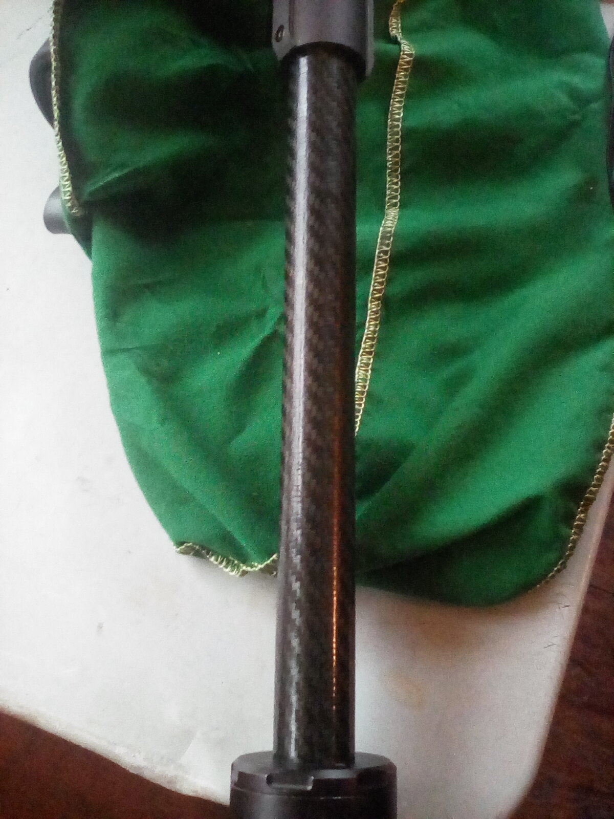

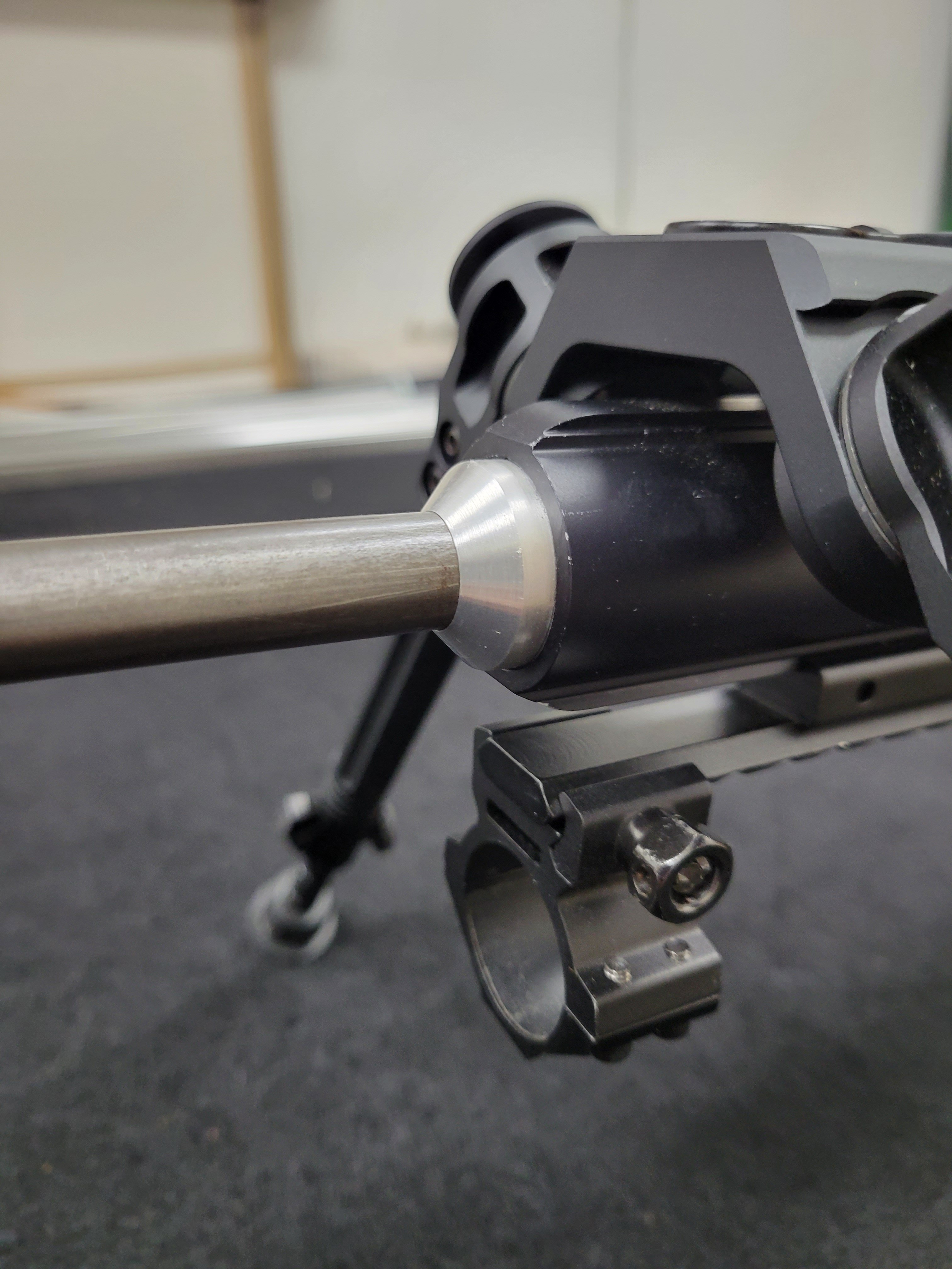

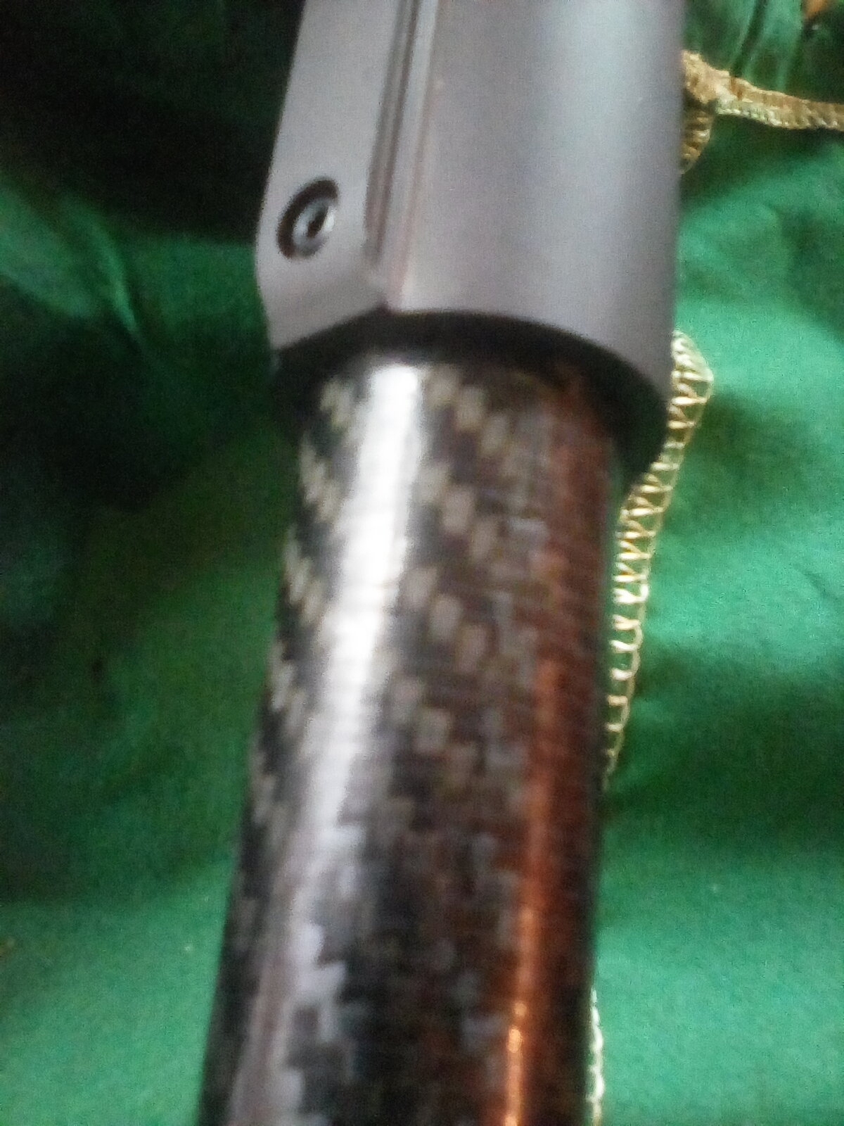

Hi sorry for the late reply , Christmas is busy season ... las bushing solid aluminum 2" long tight to the frame, tight to the barrel.
I used a .250 thick carbon fiber tube making full 1.00 in diameter. It runs into factory front bushing..tension with Donny fl. I use the two front screws to tighten to take any vibrations out.. Been using for three years.. CF tubes pretty reasonable on ebay..you can tension other ways also.. Mine is a Texan but I'm sure you can do same kind of CF tube full length on condor... Full 1.00 diameter Cf tube barrel looks great.can't scratch or hurt surface hardly. Weight isn't hardly anything.. It stiffened up thin factory AF barrels..
