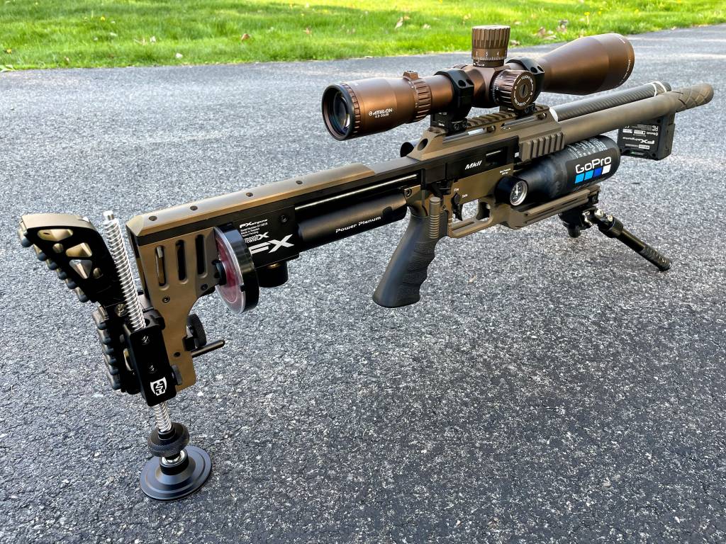

I like shooting between 100-175 yards. I can do it accurately with my M3. But I loveeee the longer barrel. I have the .30 cal Sniper set up and man it's awesome. I would hunt with this setup and plan on it, personally not a big fan of the compacts, My .25 impact II I have the compact version but the sniper set up is my favorite.

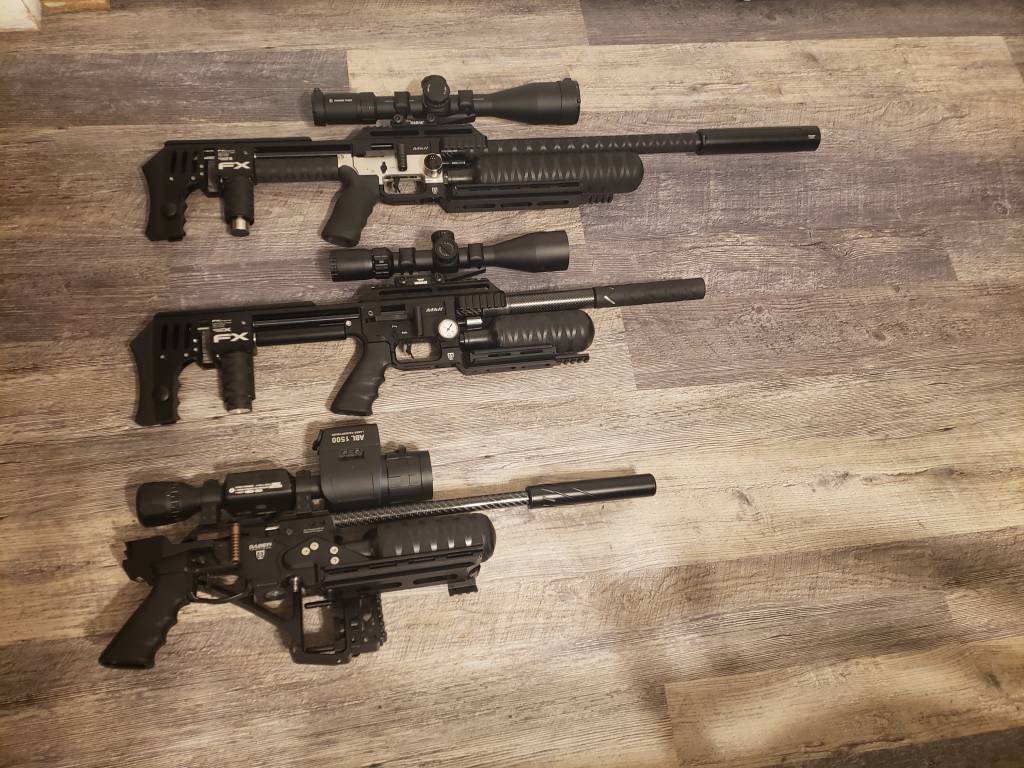

Not an available config, but I went with the 500mm compact to get the smaller bottle then built the 600mm liner. The compact is great for projectiles under 30 grains. The 600mm barrel is great for 30-36 grains. I use the 500mm barrel to shoot hades and hybrids at 950, then switch to the 600mm heavy liner to shoot the heavier projectiles/slugs at the same speed. The small bottle carries more than enough shots. I get a full mag with either barrel setup. Reg set at 150 Bar. I do have to adjust my power wheel once I switch between barrels. Here is a picture with the small 300cc bottle and 600mm heavy liner, Donny shroud, 0DB compact suppressor, all burnt bronze Cerakote.

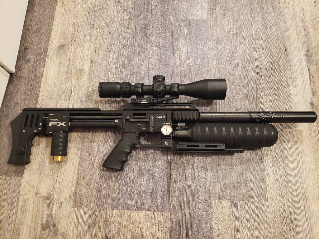

I Really like your Compact.
Is that a Hugget Mod? or which...I have a Sumo...is your Mod quieter?
Love the Small Bottle wrap......& small bottle is plenty for Hunting/Air/shots

Thanks and the wrap is a pain to get on but really like it, Ernest turned me onto it and put it on a lot of stuff it helps with grip and protection. I have the sumo and it is slightly quieter but I went skinny so I can use any of my bottle sizes, I can't speak for the m3 and its shot count but the speeds you are looking for may only get you a mag give or take if that's enough I think you have made up your mind. With all the setups I have I am probably going to get a wildcat compact in .22 for a grab and go woods walker and keep the weight down.

@CheckUrSix, sorry about that. I didn't provide caliber info. I saw you were talking about 25 cal, so I just started with that. Mine is a 25 cal, and I've been testing NSA/H&N/Knockouts in the heavy liner. I can get the MKII heavies up to 1000 fps with the 600mm liner without too much effort, but the knockouts only to about 970. If I try to push them any faster, the platform gets loud and violent.
To answer your question about getting the Knockouts close to 950 on the 500mm liner, I'm not sure you really want to do that. You might get close, but there is about a 100 FPS difference between the 600mm and 500mm liner just based on length. I was pushing the MKII Heavies about 930 with the 500mm liner, and it was kind of loud, and my MKII was cranked all the way up. With the Knockouts being a slug, there will be more resistance in the liner, and you might only get like 900 FPS out of the 500mm liner, maybe a bit more with the slightly larger plenum and valve setup? My testing was at 140 bar and not where I'm at now at 150 bar. So, you might get close at 150/160 Bar.
I haven't tried to push the knockouts through the 500mm liner yet, so not sure, but this is a projection based on my observations with other projectiles. For example, I can shoot 950 with 26 grain Hades in the 500mm barrel, and I swap over to the 600mm Liner, and I'll be shooting almost 1100 FPS without touching anything. So, if I can shoot the knockouts at, say 980 with the 600mm liner before the gun gets loud. Switch the 500mm liner, subtract ~100FPS, and we are looking at around 890-900 FPS.
When I started tuning, I used pellets to get the speeds I wanted, and I noticed that once I put in the slug, the slugs eat up another ~20-30 FPS. It was a great way not to waste slugs and get me in the ballpark. Hopefully, this post helps you or someone out.

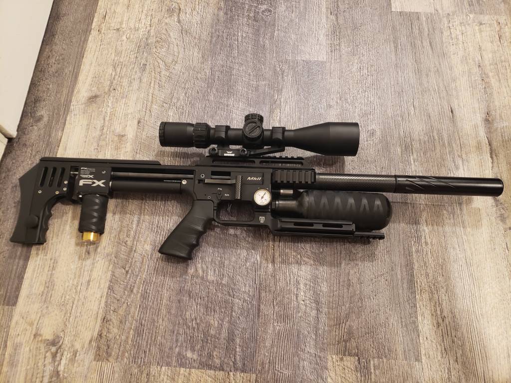

@checkursix 500mm length is great for walking around, but to be honest, I would walk with my 600mm but probably not so much with the 700. I've tested NSA slugs in the 500mm liner with some success up to about 50-75 yards, but only the lighter ones 26.8 and 29 dish base. The hybrids are pretty good but a bit on the pricey side. The hades are what I will typically shoot out of the 500mm liner because I can get them moving pretty quick, and I don't have to tune the rifle for really high power. Expansion on the hades is probably pretty good though I've never recovered one. I only shoot at chipmunks and squirrels, and I would say 100 percent of the time I get a pass-through on chips being they are so small, but if I hit a squirrel facing me in the chest area, the wack sounds louder than the rifle, think firecracker, and generally no pass-through that I could see. A side shot on either gets me a pass-through.
If you go with a 600mm liner, the weight that seems to be the sweet spot, for me anyway, is 30-34 grains. The H&N 30-grain slugs will shoot past 1000 FPS without much effort and the 33.5-grain NSAs are pretty good. Both of these projectiles will probably result in a pass-through due to the lead type not being as soft. I was looking at trying out Griffin or VarmitKnocker slugs for actual hunting as they both offer 30-grain dish/flat base in a softer lead (so I've heard), and I think would be great projectiles.

I'm shooting the Hades around 950 on average with the 500mm liner with my MK II. I set the reg at 140 Bar. I tune it to shoot 980 in power wheel #5, then click down to #3 or #4 on the wheel and turn the valve stop in to just outside line 1 (Slug power kit spring is weak), and it brings the speed down to around 940-950 FPS. Like you, I only shoot the Hades no further than 50 yards, really only around 25-30 yards realistically. At 50 yards, a 5 shot group will fit under a dime. Any further than 50 yards, they start to spread out, but that can probably be tuned out by slowing them down a bit more, but not for my use case.
