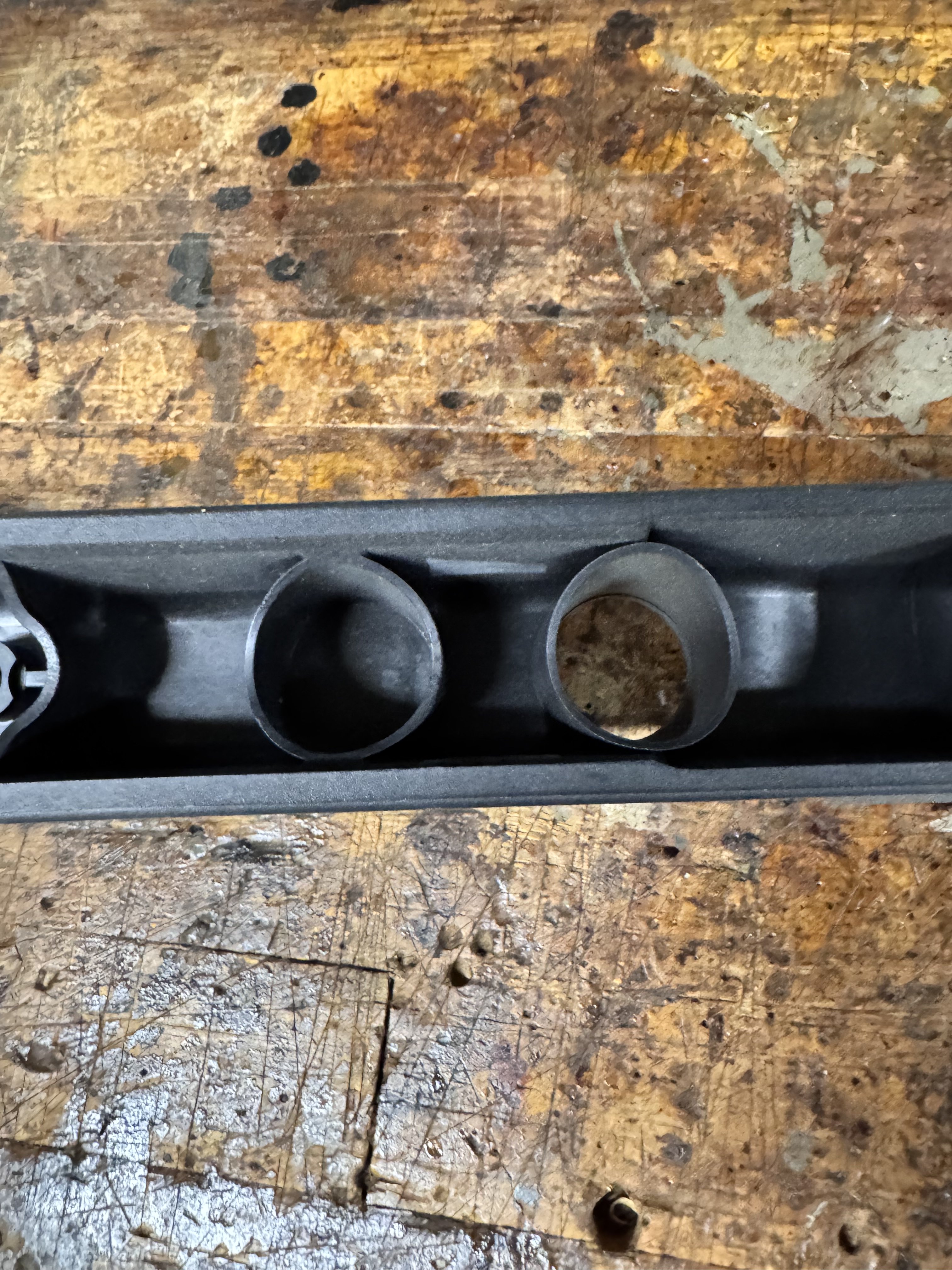

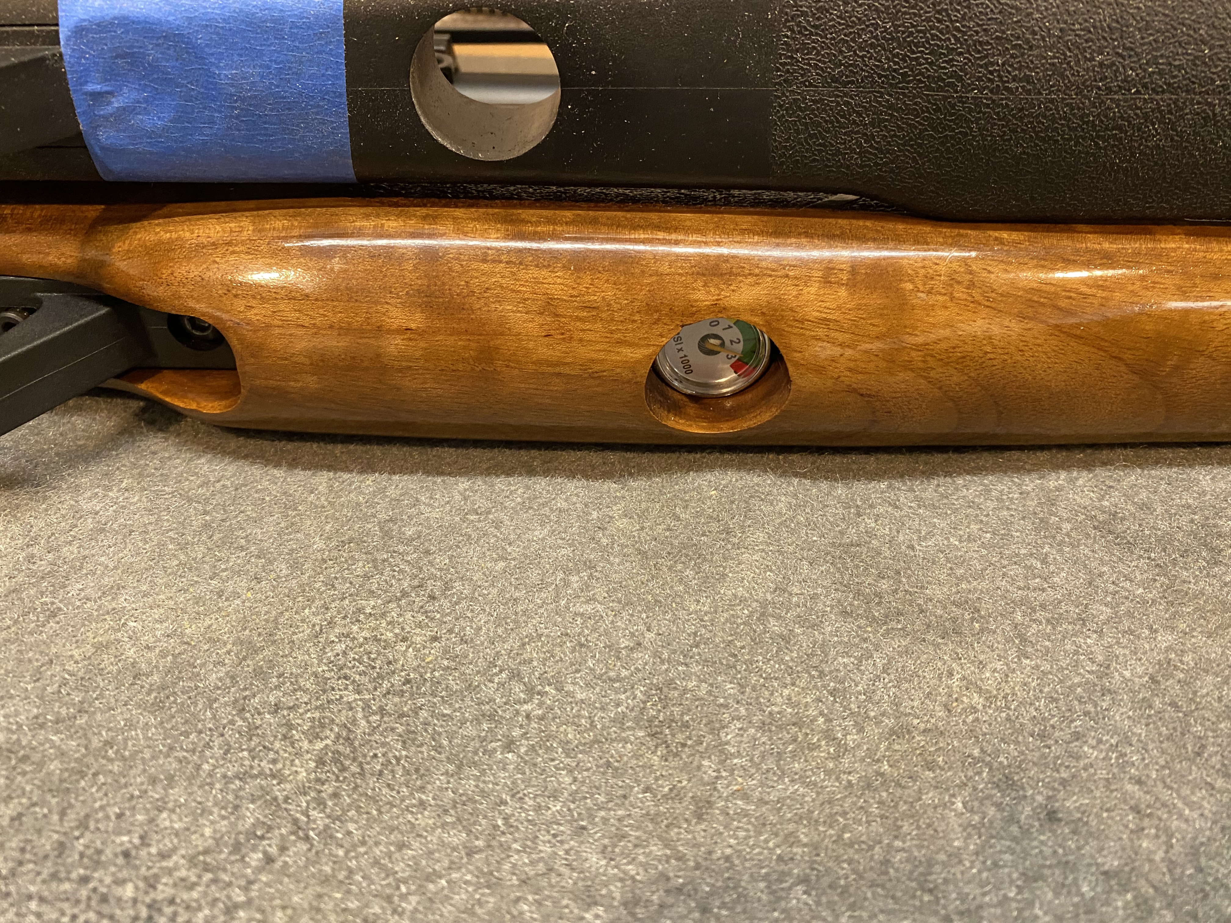

Just be aware that the Boyd’s stocks for the Marauder are for the gen II Marauder not the factory regulated rifles ie the Marauder F&T and SAM. The gauge on the Marauder F&T and SAM will not line up with the hole in a gen II stocks. This is because regulator for the F&T and SAM is between the gauge and valve so the gauge was moved forward to accommodate.
Here’s a gen II synthetic stock on one of my F&T rifles.

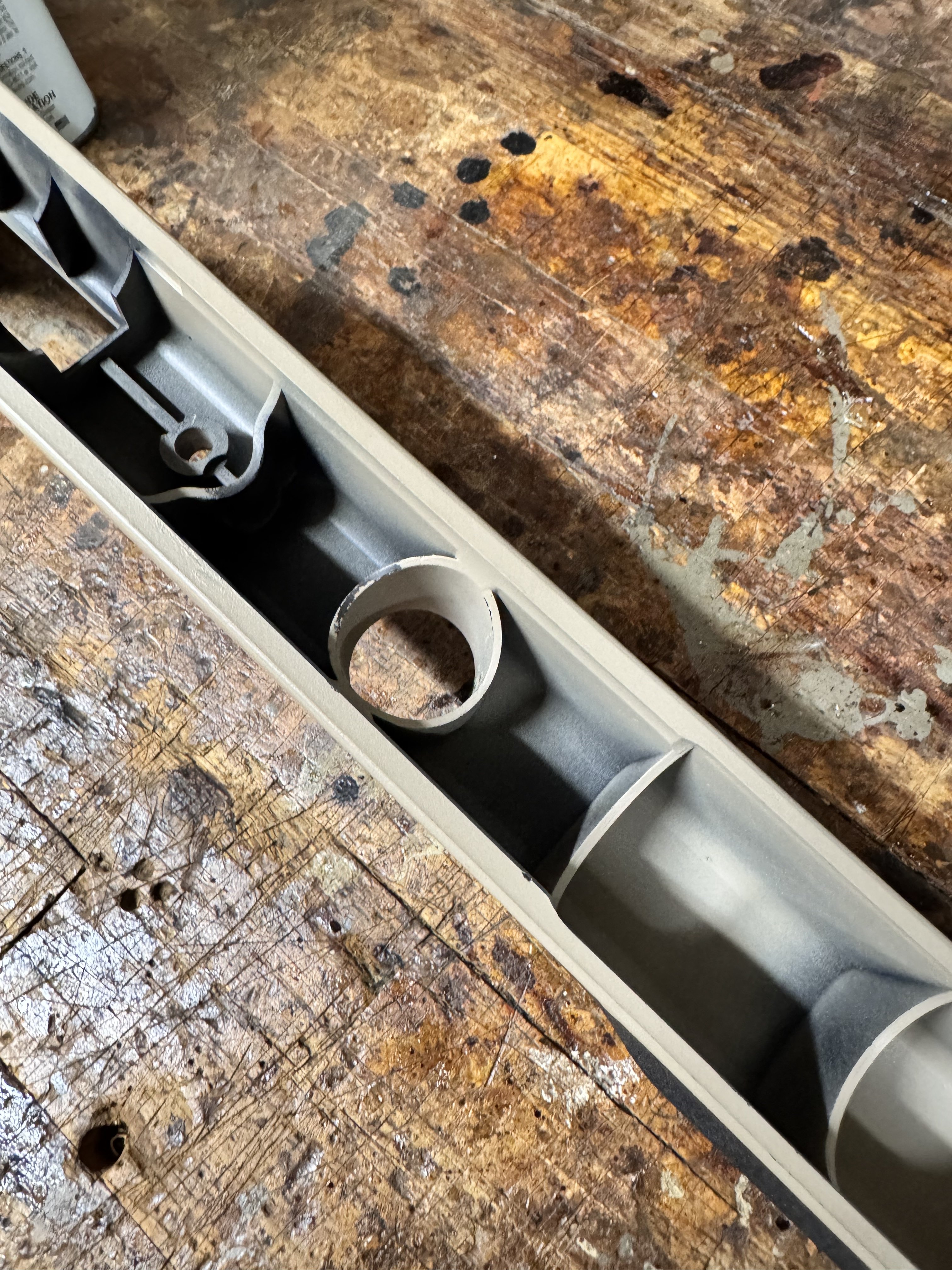

Or drill a new gage hole in thw Boyds. I think the synthetic stock even has the boss in it already.
Yes new ones are now, but only the stocks that were made for the past five years I think it is now? The synthetic stock was updated during the SAM project. Any GEN 2 stock older than that will definitely have a single hole and even some a year after will as well from depleting inventory.
