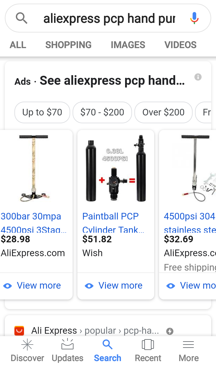

The Aliexpress $29.50 pump is significantly easier to pump (for ME) than the Benjamin pump. In fact seems easier to pump (for ME) than my FX and Air Force and BSA (Old Hill) and my Hill MK3. Yo!

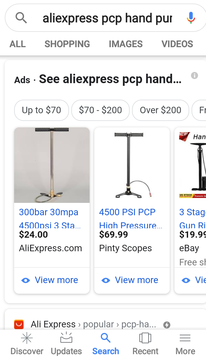

Like others have said, the Chinese pump is only $30. Not $60. If you paying $60, you getting rip off. I owned and used a chinese pump and a Benjamin pump. I would say the Benjamin pump is a bit smoother to pump but not worth the price tag. The reason the Chinese pump is better is, it gets the job done for $30 vs the Benjamin pump that does the same thing for $160. Not sure how much the Benjamin pump is now but when I got it back in 2011, it was $160 from prymaid air. Then I also got the hill pimp mk4 which is better than both but at a price tag of $280.
