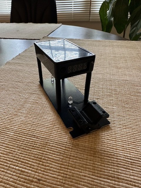

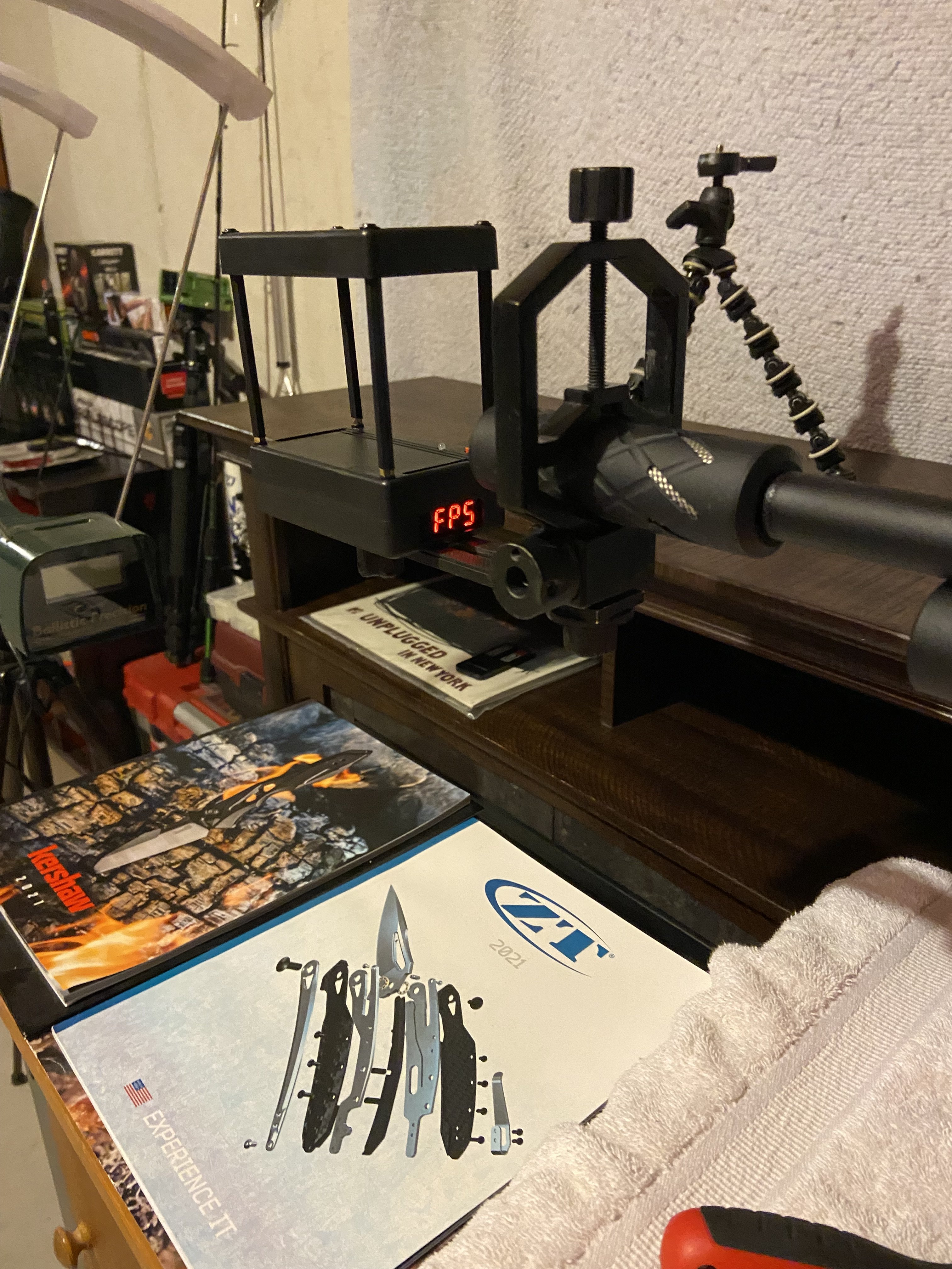

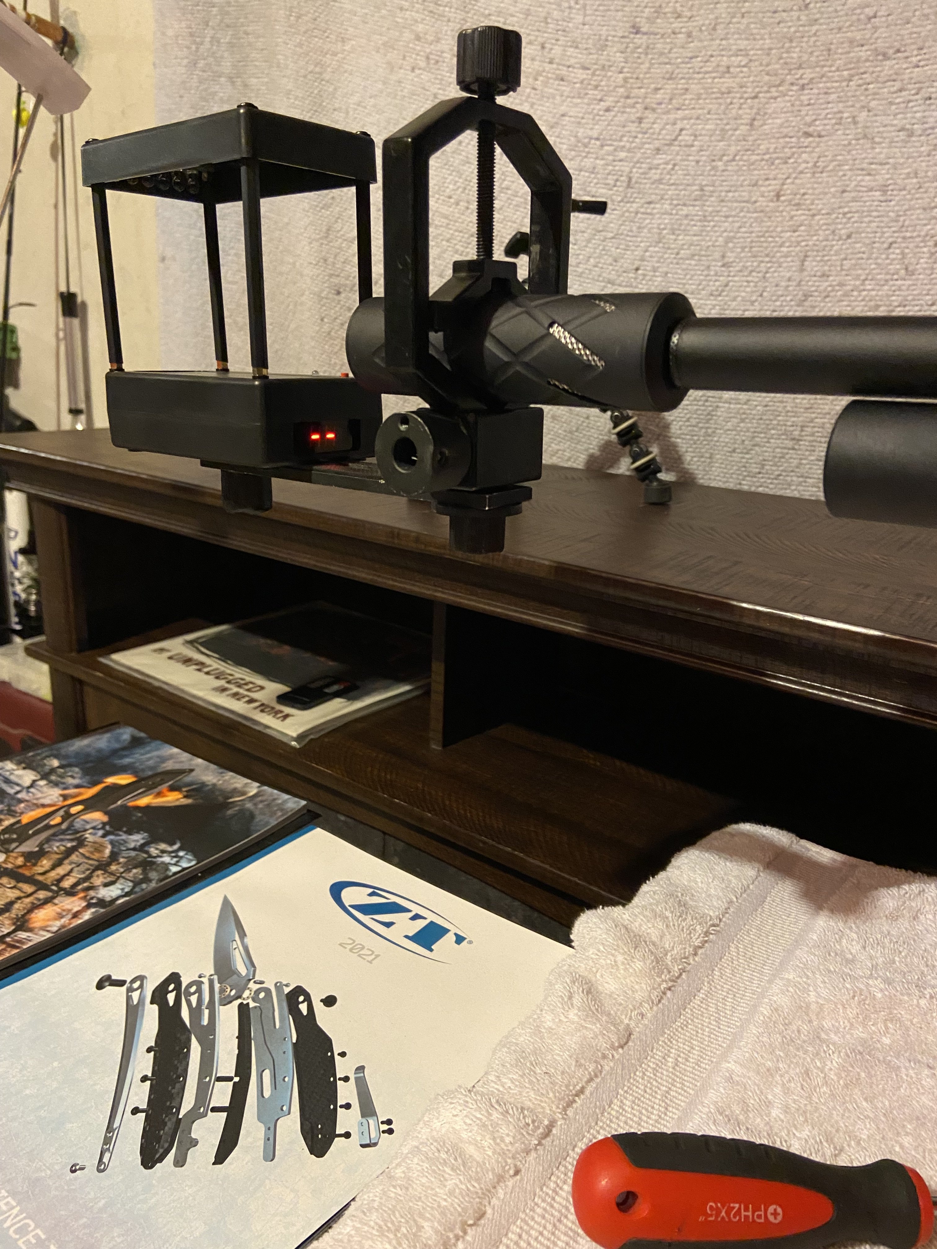

I have the same one. I just use it on the shooting bench and shoot across it. The only thing you have to do First is find a charger fore it (doesnt come with one, just the cord? ) and Secondly, after turning it on when it starts up, if you want FPS instead of MPS, push the start button again and the display will go to FPS, then youre set. Just turn it off at the end with a long press, or let it time out.

Or you can buy from Alibaba. Probably cheaper but slower delivery. I have had 3 - shot one tripod mount. They all recharged the battery with a simple USB power cord. One end lights up a little to show battery status (red means it needs charged, green means it is fully charged). My replacement tripod mount measures in fps. You have to press the power button during the startup sequence, however, when it displays "fps". It is supposed to be possible to get them to play back their readings but I just write it down. Easy once you get in the habit (and avoid studying the impact of the last shot until after you record the velocity).

My version shows SU, which is standard units (metric), and I press the and hold the button and it then will show FPS to change over fps and ft-lbs.
