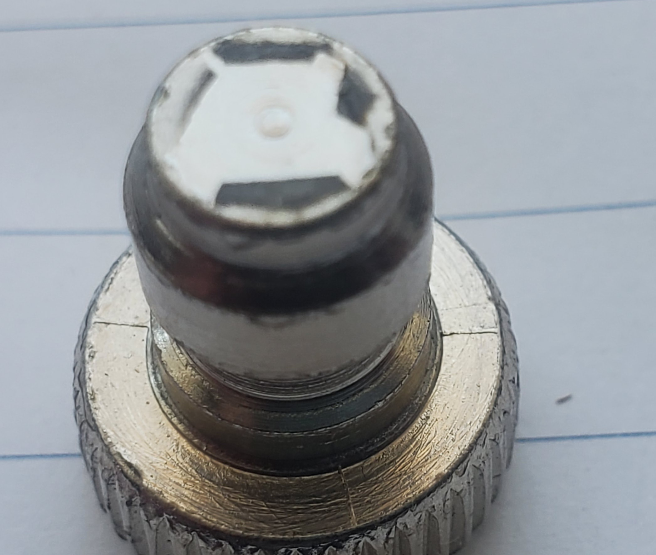

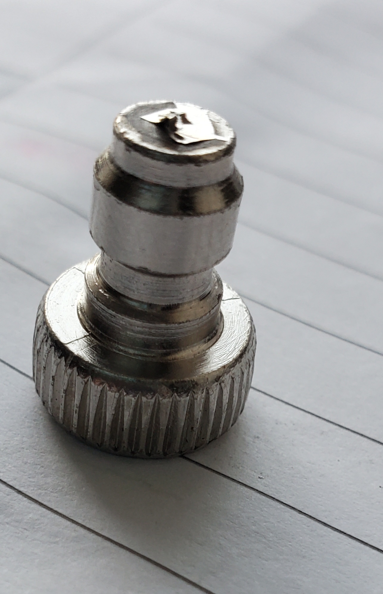

As always check your fittings for wear each time you use them. I got a portable compressor as a back up in case I ever run out of air when I'm out shooting. I have a medium fill tank. Yes I have air anxiety. I wanted to run it the poop out of it in the first 30 days incase there is an issue I can return it. Well no problems with the compressor but look at the line cap!
I peeled up the chrome on the piece.
Apparently there is a chrome plating that is peeling. I hope nothing got into the guns. At least I put a filter after the fill port.

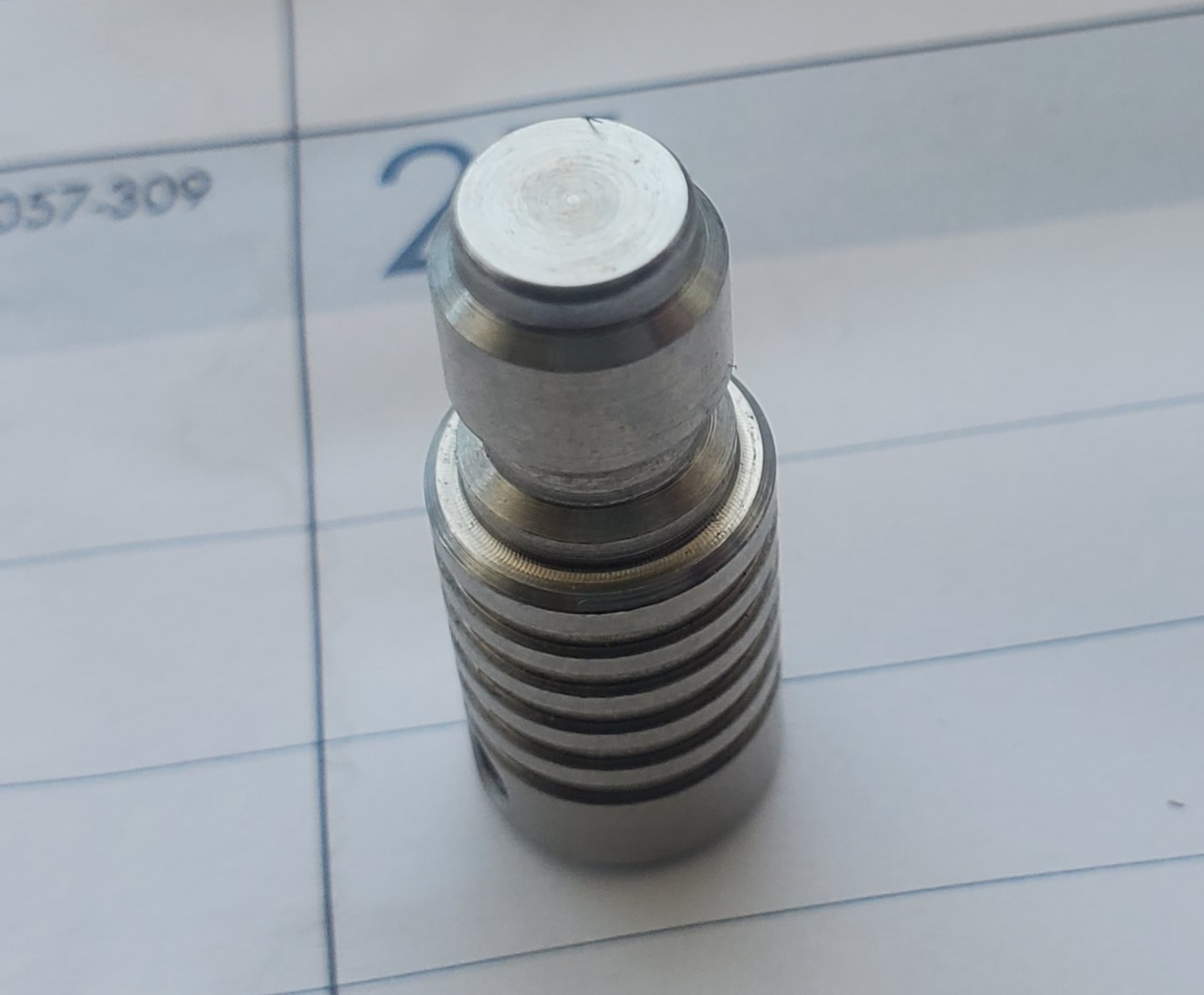

Here is a machined item I use instead.
