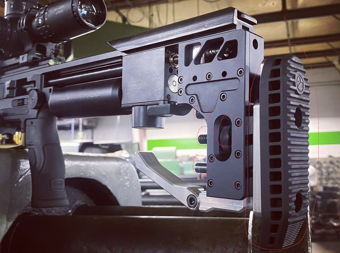

Here are some pictures of the probe carrier, notice the box way guide.
View attachment 326625View attachment 326626

Yes, while the KLS-2 is robust, it does have the downside of not having quick LOP adjustment. The KLS-3 and L-tech solved the lop inconvenience with the adjustment wheel. An interesting thing about our adjustment rod and wheel is they are made out of 2023 instead of ss or other steels. So very light. At some point when I get the time, I do want to switch the guide rods from SS to a carbon fiber rod; and I'm hoping to make it cross compatible with the current M8 threaded 8mm diameter ss rods for easy swapping.
