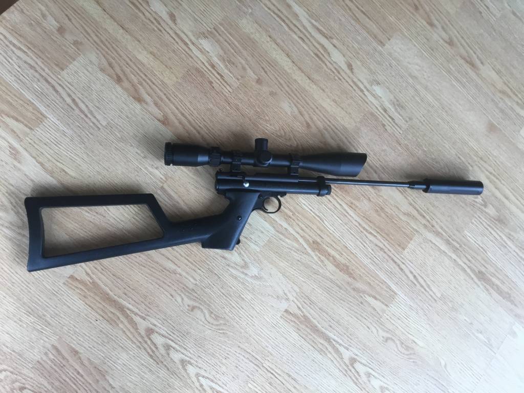

- the pp800 multi-shot is powerful, silent, and amazingly accurate after some mild tinkering. Mine came with a valve leak
. I did not like the grip either. Solution instead of returning it: also got myself the co2 version with a synthetic grip. That 100 usd package included a shoulder piece and an interchangeable long barrel as well. Put the valve unit (plus stem) into my pp800. Same for the grip. All perfectly interchangeable. Also threw in an 80 bucks Robert Lane regulator. Polished the barrel etc... Result for 350 bucks: a cool repeater pistol with sleek grip, silencer + optional shoulderpiece. Plus extra mag, long barrel, spare short barrel, silencer etc. waiting in the wings. This pistol would not have looked out of place in the upcoming James Bond movie. Not pellet fussy, adores the JSB Jumbos. Even only equipped with a basic red dot (no magnification) it loves terminating those shrieking parrots at 25 yards.
