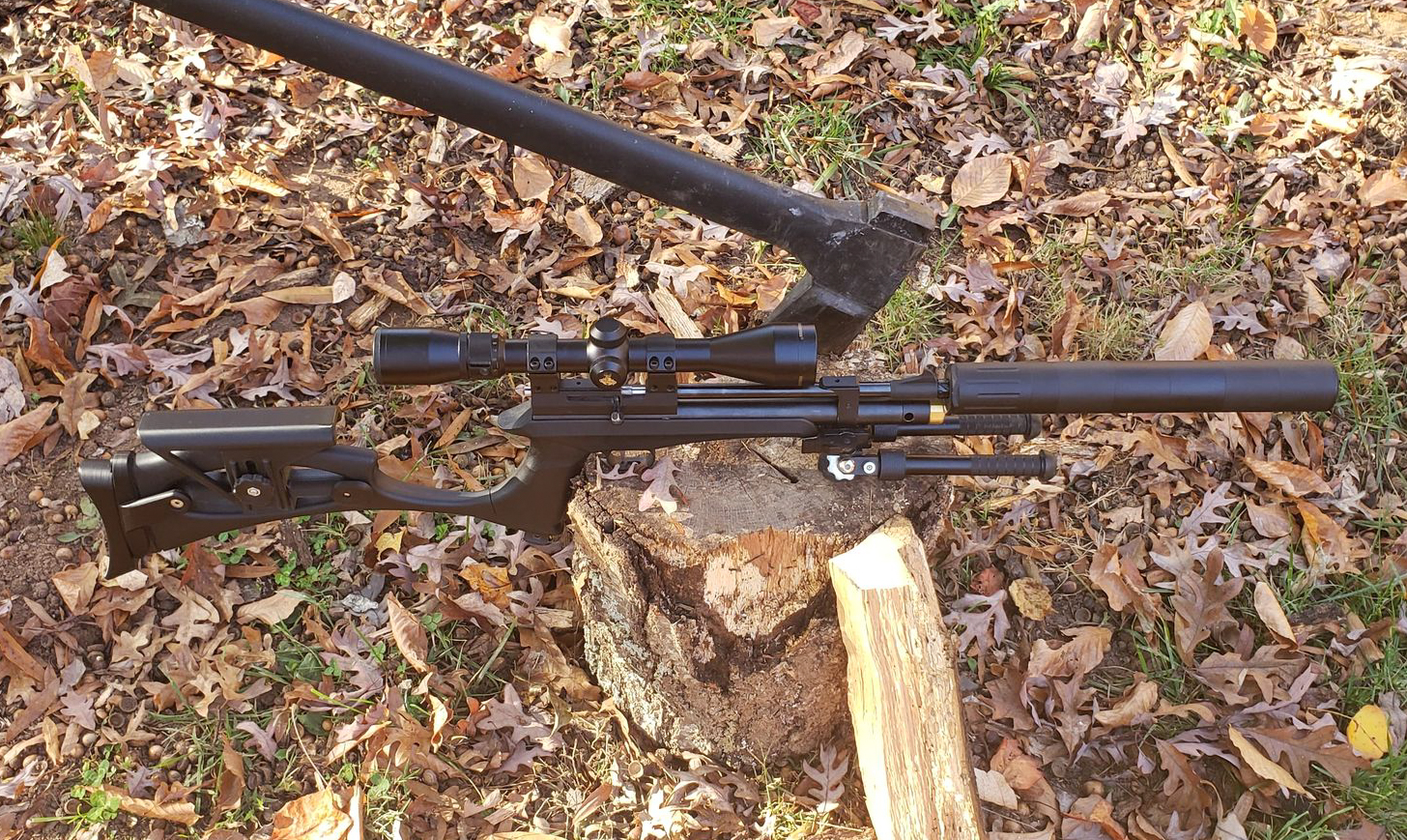

LGD---Please TELL us about that buttstock on your Chaser rifle! Looks pretty custom for sure! Also, I like the way you mounted your red dot on your PP800. Keeps the receiver area nice and clear for loading.
The stock has add-ons made by Bob Pattenden in the UK. They are not illegal to export, but he refused to ship them out of the country due to it being somewhat of a legal Grey area. I did manage to find a buying/shipping service to buy the parts for me from his ebay site, and then ship them. I since tried to have the same company buy a scope lense filter, and they canceled the order. Which seems absurd, but I think they got stricter on what they will and won't purchase.
Thanks for the compliment. I think i used a stormrider barrel band. That gun also has a Cothran valve I managed to fit to it. Gets approx. 2 shots per fill, is comically loud, honestly deafening. Still dead nuts accurate, and 50fpe from short barrel.
