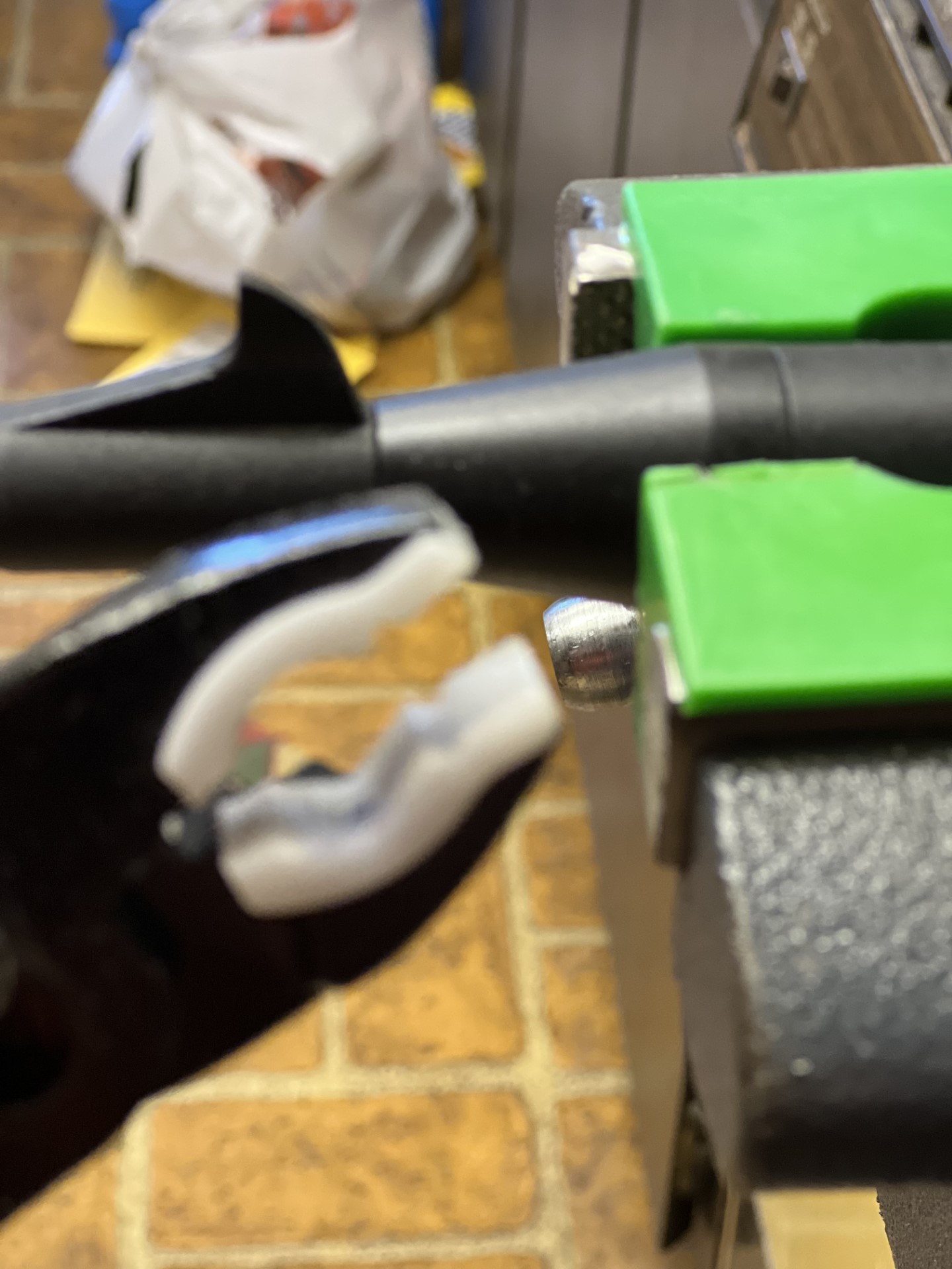

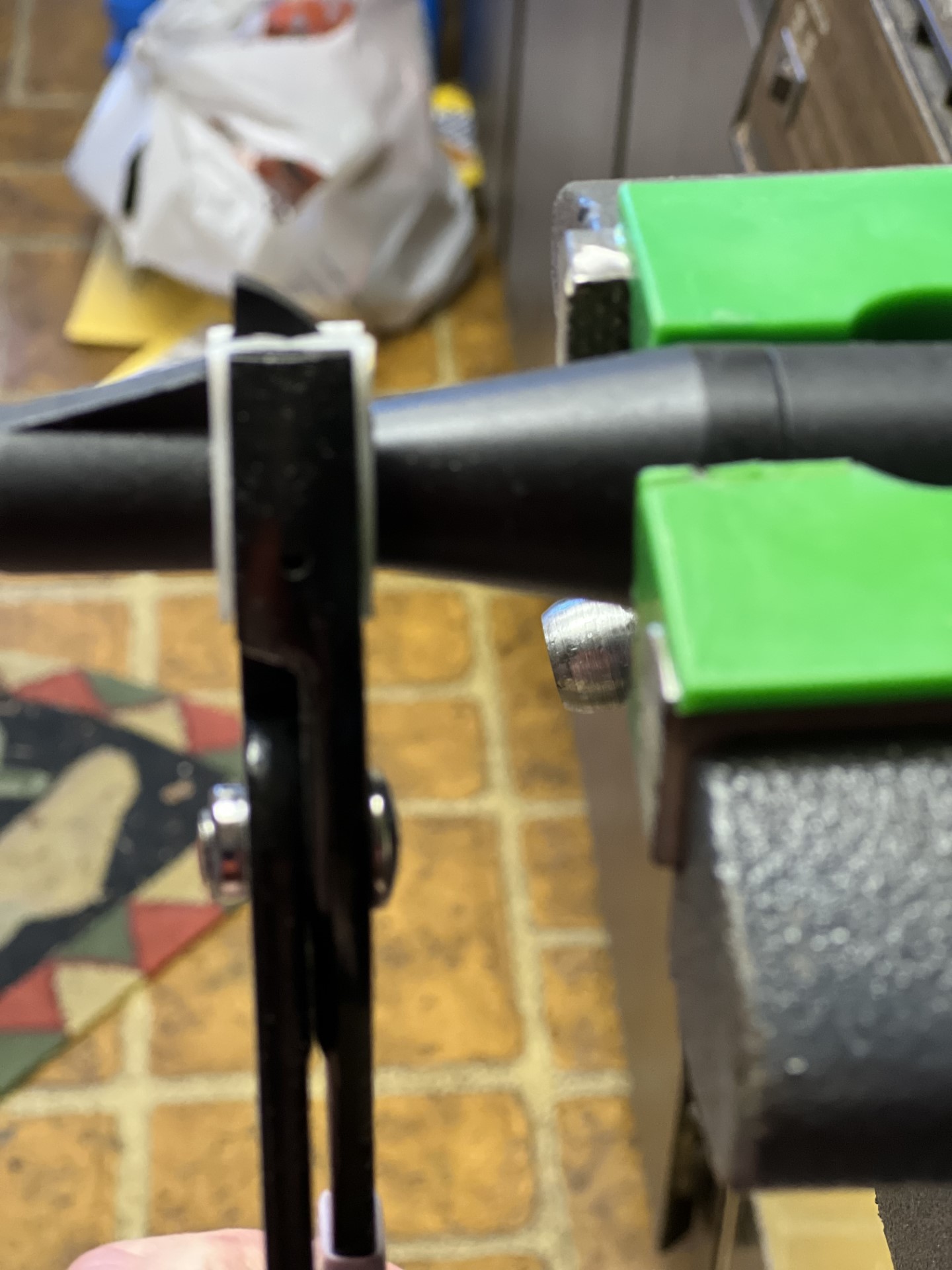

here is the setup and pliers i use
Marflow777--- Hey, I have those exact SAME green vise jaws(y). I need to pick up one of those soft-jawed pliers though... I have seen them at my local plumber supply house. Pricey, but worth it I'm sure for tasks such as THIS one! I'm gonna purchase them for sure, and try removing that moderator again. Also, as an aside---MUCH thanks for the barrel o-ring sizes info on the Airbud/Chaser.
