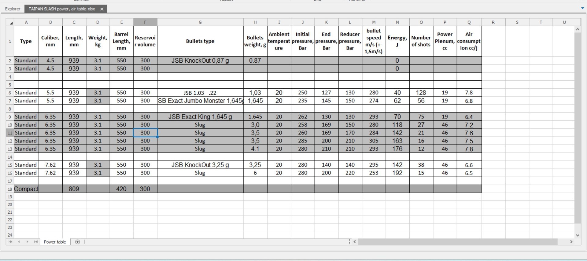

Taipan Chart for Taipan Slash testing.

Taipan sent this to me the other day. I ordered the .22 and this caliber and the .177 and .30 have limited testing compared to the .25.
Notice the fill pressures ( initial pressure bar ) are all under the max 300 bar.
The .22 had only 235 bar onboard for the test, got 56 shots just below the reg pressure and the shot count seems it would be quite a bit higher with a full or close to full fill.
I would probably keep mine under 300 B as well but not as low as in the tests.
