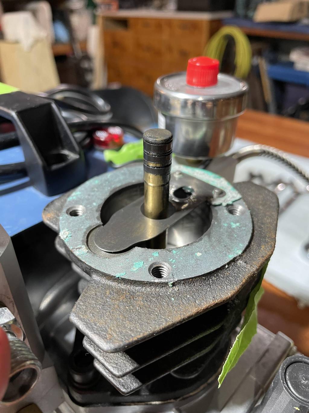

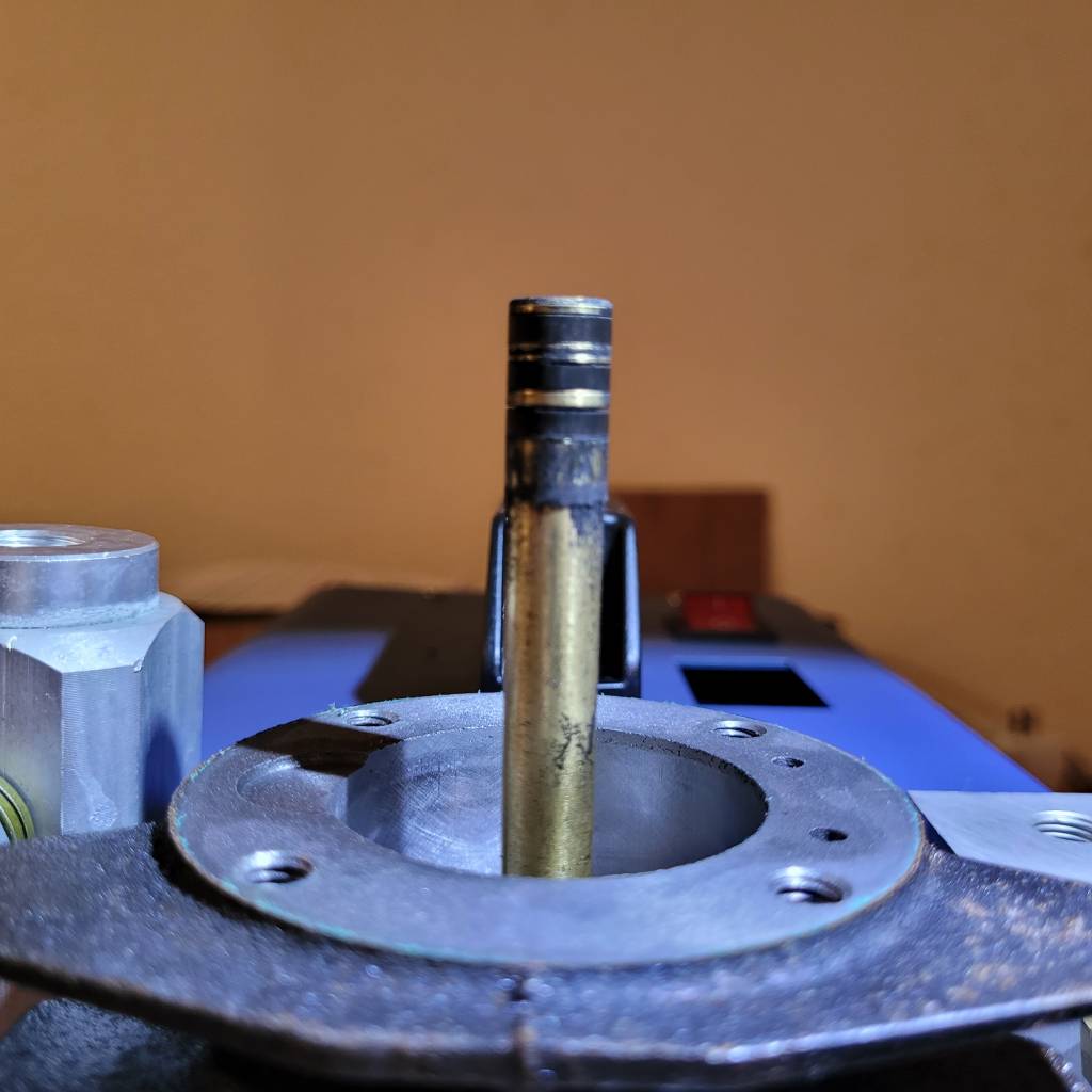

This is how mine looked at between 10-15 hours, the first couple with royal purple and then Chemlube 751 for the rest. No major buildup and was easily wiped off with a rag. I got it back together Thursday night, and received my new compressor on Friday, so I haven’t tested it yet. I did notice that the head gasket was not cut out for the reed valve, and the valve sat on top of the gasket, which surely wasn’t correct, and the new gasket has the correct cut out. I still have a new piston and rod assembly, as there was no wear, even the 2nd stage rings measured the same as the new one. I credit using the correct oil, and keeping it cool 😎 during use with the lack of wear.

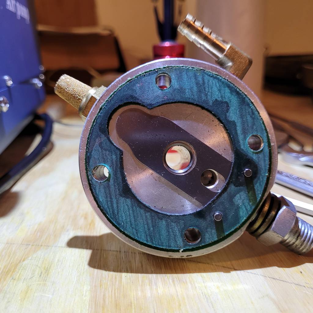

Second stage was mostly dirty on bottom ring. Not sure if that was caused by assembly or something else. I only have about 10 minutes total run time. My gasket goes over the top of the reed valve. Is that correct or is it suppose to be cut out?
Thanks for your help...
Well, now I’m more confused, yours looks like how mine was…however the new gasket is cut around the valve, which makes more sense to me. The new one does leave less meat at the edge of the cylinder head, perhaps a weak point? Mine worked fine with the same gasket as yours, but looked funny to me, as it had to form around the edge of the reed valve to seal. Sorry if I just added more confusion.
