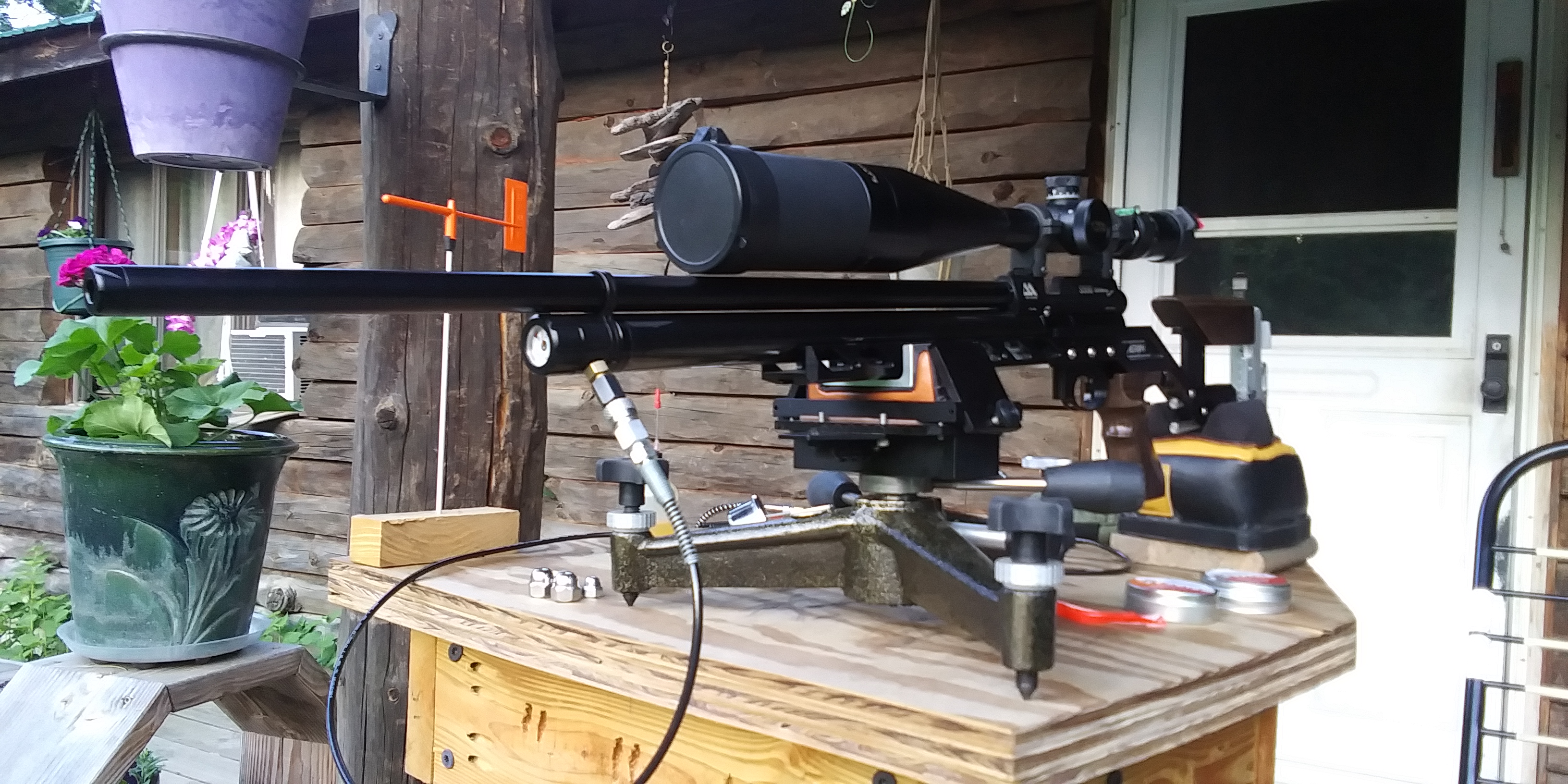

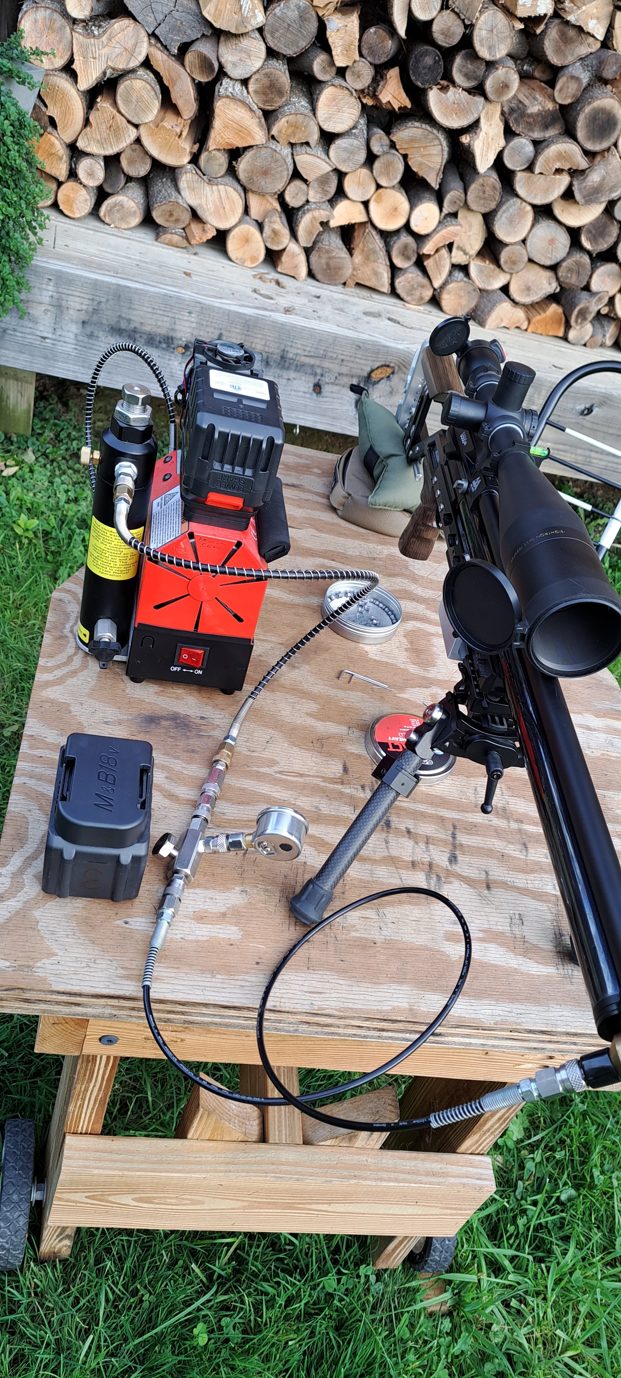

Switched to Lane Quick Fill probe kits on my older S4/5xxs. On my newer factory regulated S5xxs I continue to prefer the Banjo fitting.
I mostly shoot tethered and the Quick fill and Banjo connect the hose at a right angle to the gun. Much more convenient than sticking out straight or using a right angle elbow.
