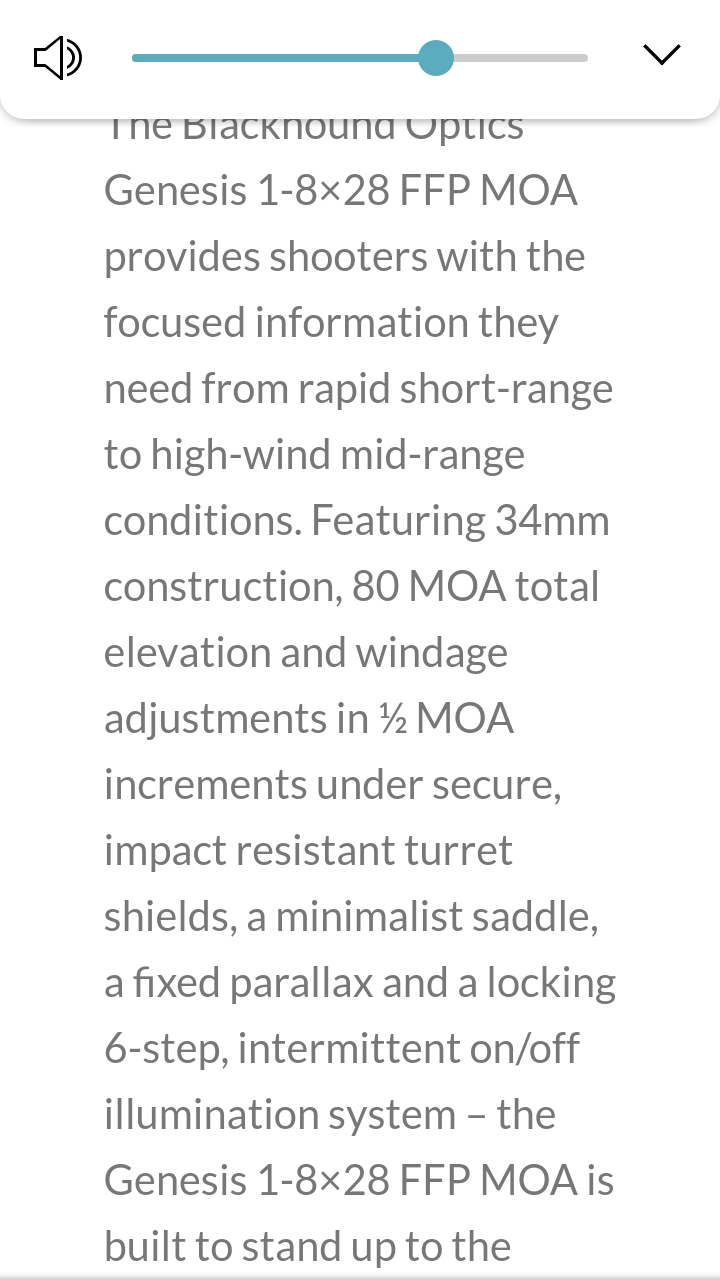

Description RAPID SHORT RANGE . . .
Dude . . . actually you may be onto something here. Thank you. I will pursue this with the vendor. I do have the eyepiece (ocular) set to my eye - I do wear glasses and admittedly my vision isn't great BUT . . . . Setting the ocular as you, and most everyone in here knows, is ONLY to get the reticle focused - it's pretty much a one and done thing and frequently unique to individual shooters. It should not (does not) have any effect on what you see through the front (objective).
How is "SHORT RANGE" defined? I'll pull it out of the box again tomorrow and diddle around with it / look to see if perhaps I missed something ( is there somewhere else where I can adjust focus? ) I'm guessing not on the latter BUT . . . . who knows. Assuming not - I'll be calling the vendor on Monday to get their definition of "short range". The way they describe it as you point out from their own web site makes it sound as though it would be mounted on a short stubby weapon used by . . . I dunno Jack Bauer and CTU (lol - from tv series called "24") when they raid a terrorist cell in some run down motel. Short range - urban - room to room. Not 100 yards.
