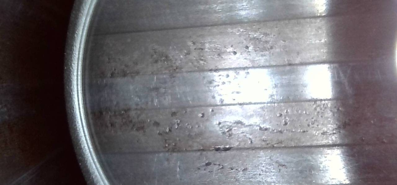

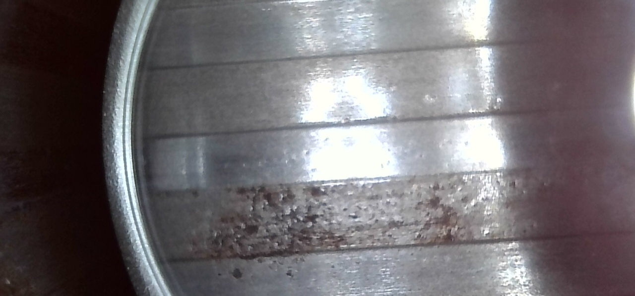

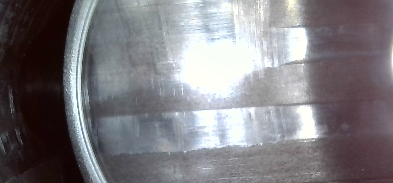

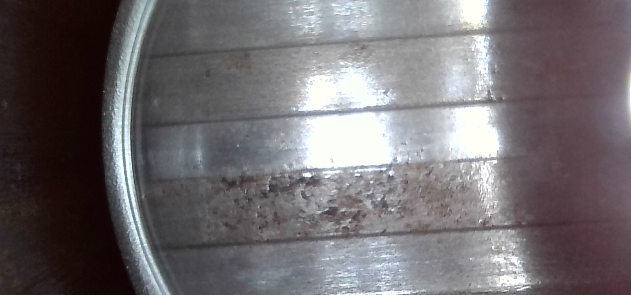

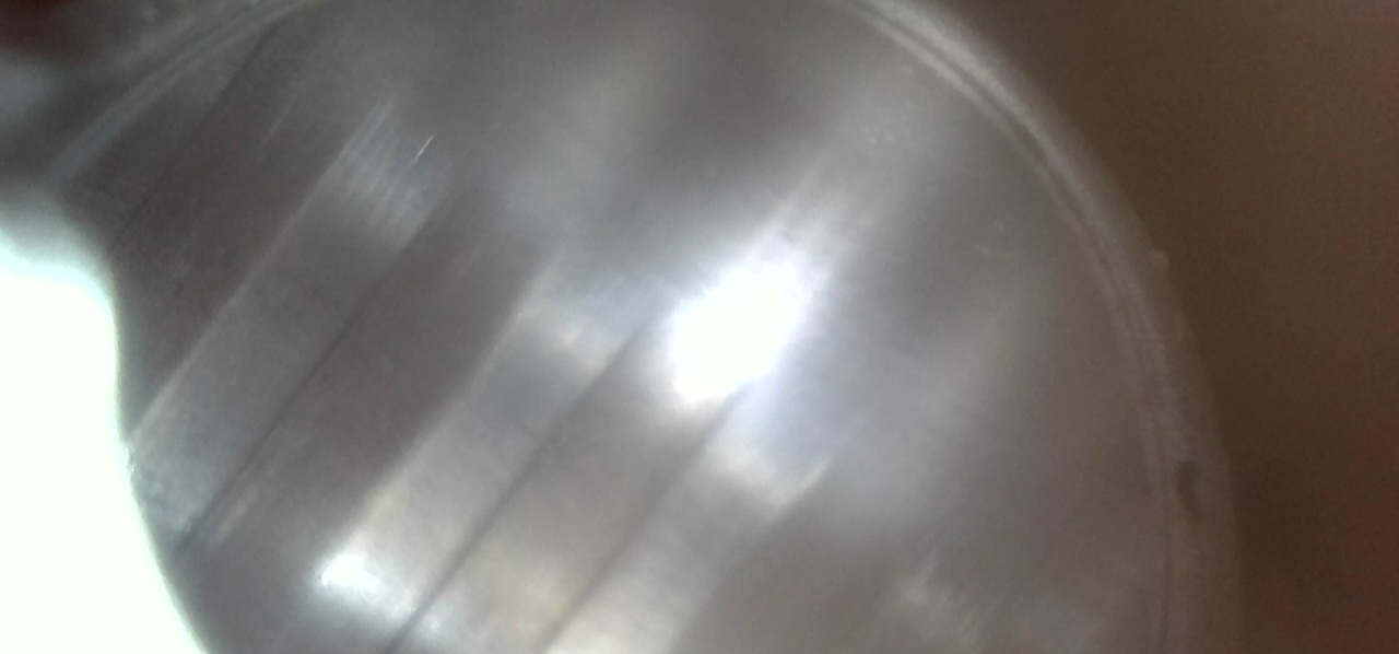

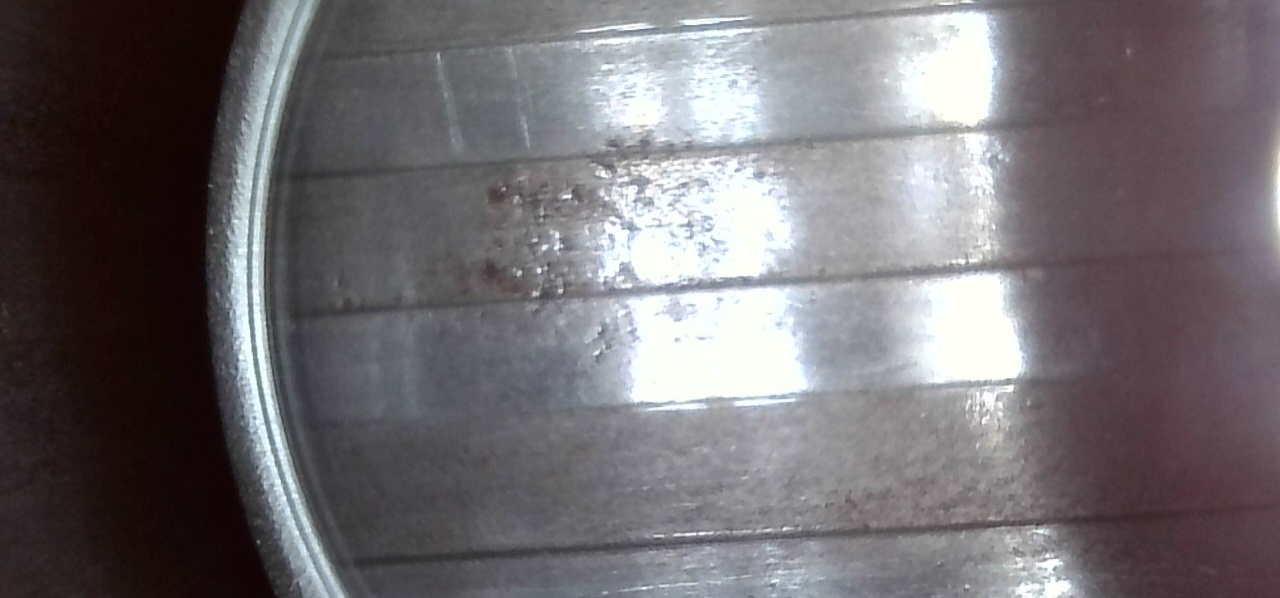

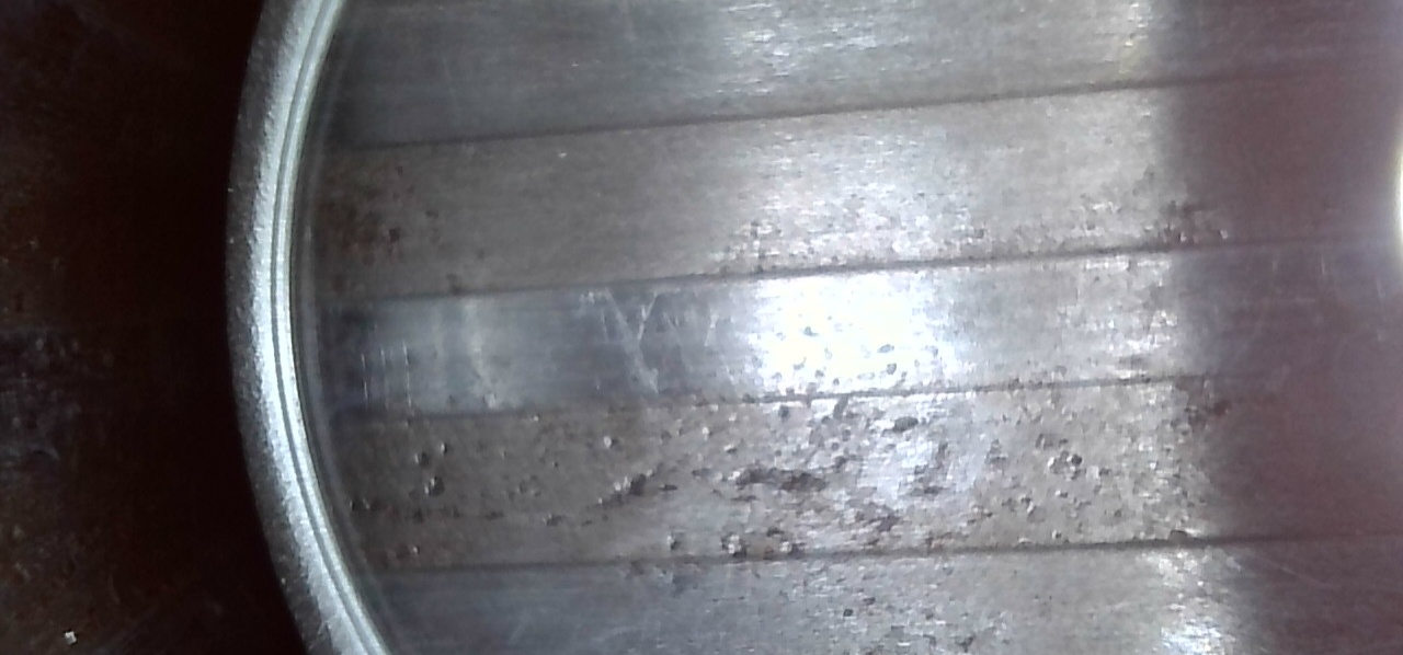

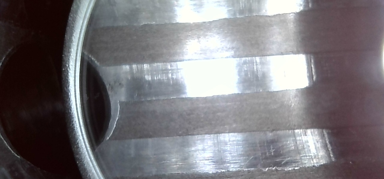

Chamber was cut off alignment with the bore and throat angles were very rough. Lot of bad places down the groves and lands also.
For a $1000 gun I don't believe the barrel should have made it out of the factory. Local gunsmith just shook his head and said "Get a new barrel."

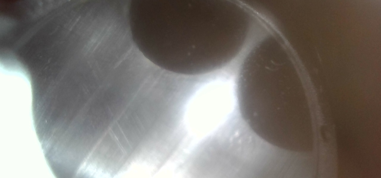

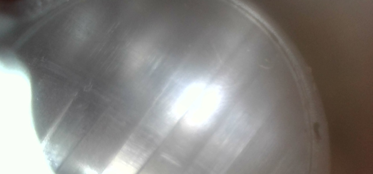

Not being able to afford that I've cleaned the chamber and throat up with a wood dowel and lapping compound. Stopped when I did so as not over deepen the throat since not much precision with a dowel.
Seems to be shooting better but had a trigger issue and waiting on a new trigger rod and set screw. Mine's worn from far to many disassembling. Once that's fixed I'll likely do some fire lapping.
Anyway here's the look see. Before, After, then just a few of the bore.
