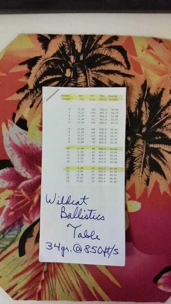

To let you know how well this works let me tell you guys about a recent trip to the range with my .25 Wildcat. Since I now have a regulator that is totally consistent I did everything I described above and went to the 100 yard rifle range. (My Wildcat is currently set up to shoot the 34 grain JSB pellets at an average velocity of 850 ft/s, and my scope is zeroed at 50 yards.) While waiting for a cold range to put out a target frame, I used my Athlon Midas rangefinder to range a white rock on the hill that was about the size of my fist. I ranged it at 117 yards...my Chairgun Pro ballistics table printout said I needed to holdover 70 clicks...so I dialed in 70 clicks elevation and put the crosshairs on the white rock....when I pulled the trigger the white rock disintegrated right before my eyes! Perfect!
Then I put out a target frame out at 75 yards...my printout says 21 clicks holdover...I put 21 clicks elevation on my scope and Bingo! dead on point of aim! Same for 100 yards...my little printout called for 48 clicks holdover and Bingo! dead on again! So then I ranged a white piece of styrofoam from a cartridge box up on the top of the hill at 130 yards...the printout says holdover 88 clicks...I put the crosshairs on the styrofoam and hit it eight times in a row!
And that my friends is why I went to all the trouble of convincing Huub Andriessen to make me a regulator for my Wildcat that gives me the same average velocity each and every time I pick up my rifle to shoot it. It used to drive me crazy when my Chairgun Pro ballistics table printout stopped matching reality because my old regulator kept fluctuating up and down all the time. For me personally this was completely unacceptable...I have spent a lot of time and money and work on my Wildcat and Streamline to get both of my rifles to shoot not just accurately, but super consistent so that they both exactly match in reality the wonderful Chairgun Pro ballistic tables. For me it is like winning the Lottery to put the crosshairs on a target using the ballistic table to predict the amount of clicks necessary for holdover, and then when I pull the trigger hit precisely dead on!

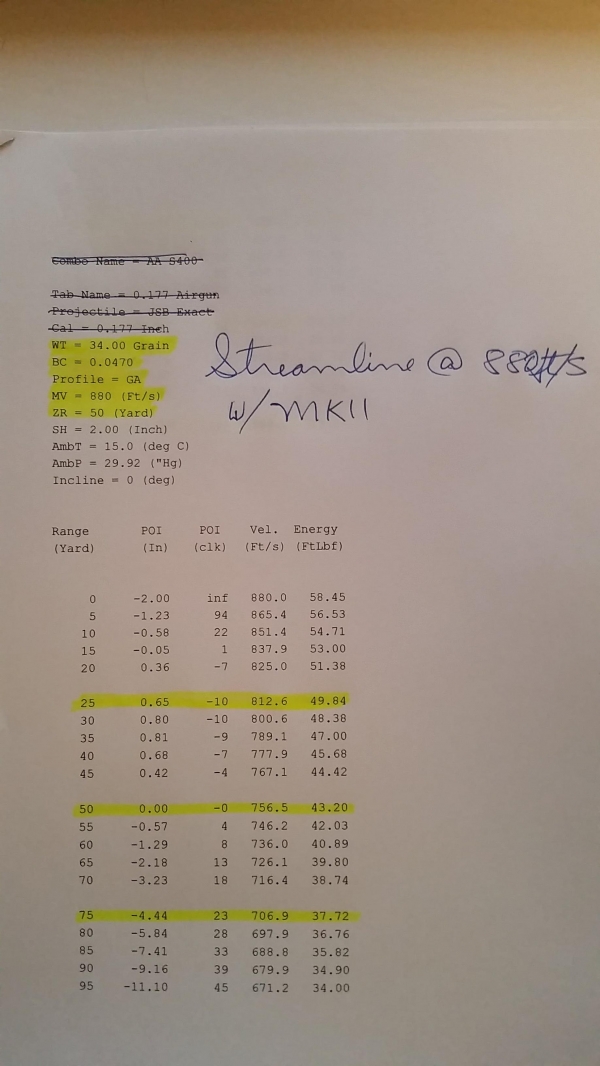

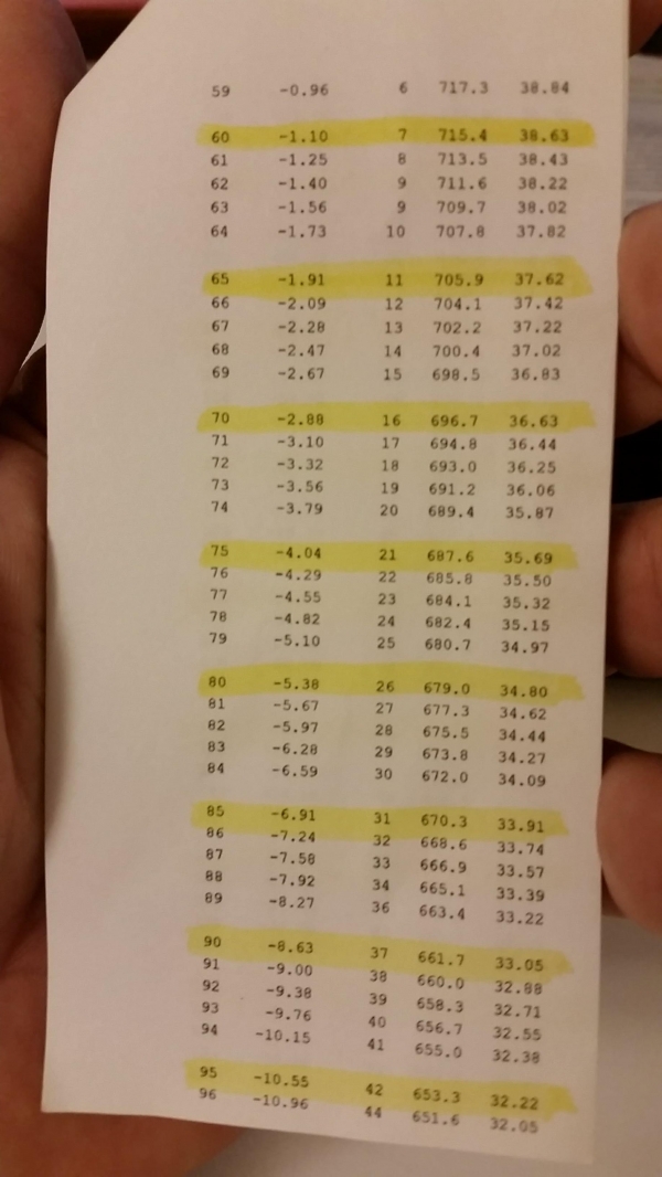

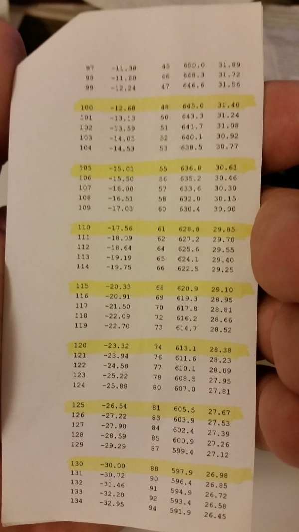

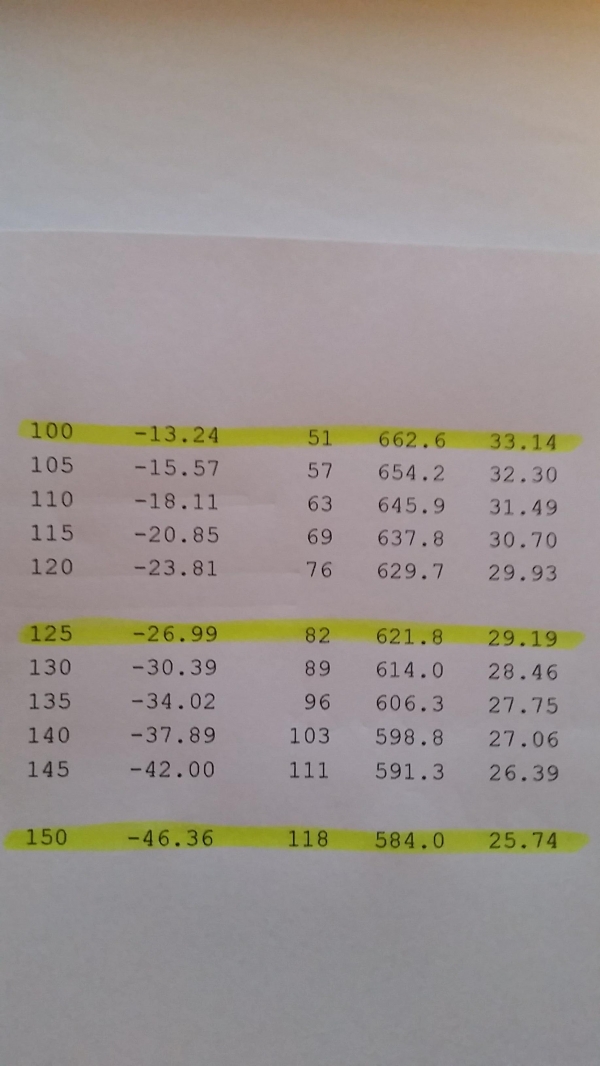

Here are a couple pics of the little range card I made using Chairgun Pro: Good luck making your range cards with Chairgun guys! :)
Thanks Glem.Chally...if you like the ballistics table for my .25 Wildcat you are going to love the one for my .25 Streamline! Now you see one reason why I feel .25 cals. shooting 34 grain pellets are far superior to .22 when you consider that my rifles have more energy left at 100 yards than most .22 cals. have at the muzzle. And my Streamline has a power adjustment wheel to lower the power one to two steps lower if required. Very versatile, lights out accurate, and far less affected by the wind than .22 cal. For me it isn't about buying an expensive rifle and hoping it lives up to expectations...for example I would prefer to buy an inexpensive violin from a pawn shop and tune it and tweak it until it plays like a Stradivarius. For me at least half the fun is getting my two rifles to do what I want them to do. Check out the ballistics table for my Streamline...and remember at this velocity it is giving me 1/2" groups at 75 yards and 1" groups at 100 right now. :)
Very impressive. Those range cards look very similar to my .30 Bobcat shooting the 44.75 grain JSB Exacts at 880 fps. My zero is at 50, and my drop at 100 yards is approx. 13 inches also. Good downrange energy, and your ammo costs 1/2 of mine! ;) I think the 50.1 grain shooting at 845 fps has almost the same drop with a 50 yard zero, so its BC is somewhat better than the .30 cal. 44.75 or the .25 cal. 34 grain. I know how much time and effort it takes to get that range card just perfect, very nice work Chuck! Thanks for posting...
