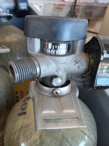

Post up a pic of the valve on your new tank, particularly the thread portion. Or a link to the ebay ad from which you purchased it.
Unless your valve is leaking or damaged all you really need is an adapter to Foster or directly to a hose that would have a female Foster on the gun end.

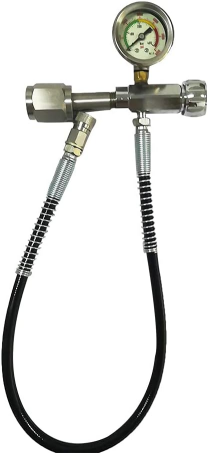

Since your valve does not have a bleeder, you will need a set up with a bleed valve like in photo.

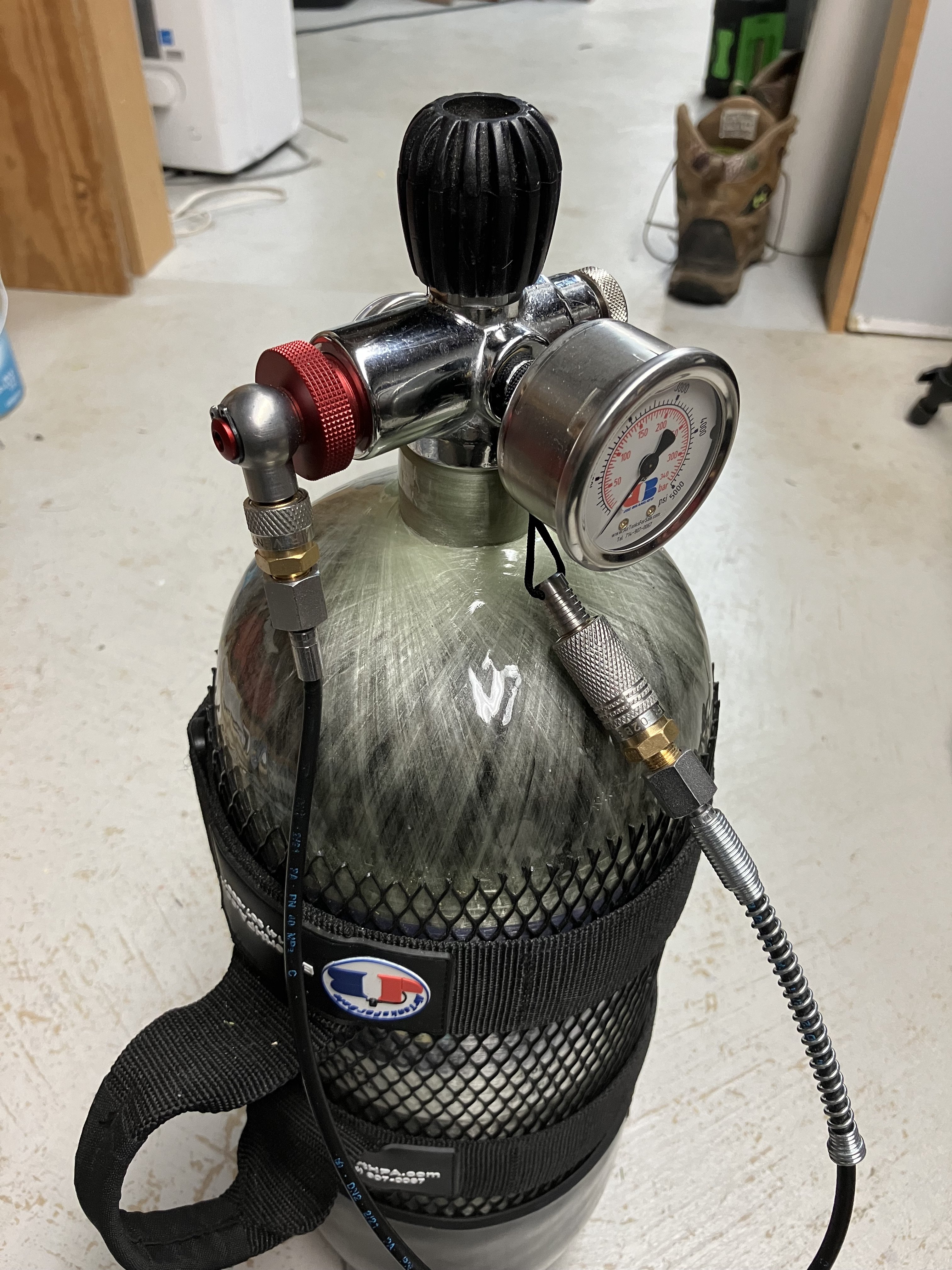

Other photo shows my Brancato tank (DIN300 valve) with 360° swivel fitting, double female Foster 18” fill hose and dead head plug to keep dirt out. I really like the swivel fitting because I don’t have a hose sticking straight out the side. I can leave the fill hose on all the time because it tucks down alongside the tank. That’s the only thing that keeps me from buying the Saber Tactical valve.
Another plus with the Brancato DIN300 is that it has a slow fill orifice for filling gun, but when you are filling the tank it allows a higher flow rate.

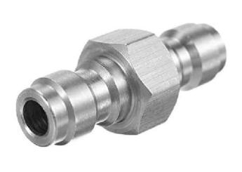

Double male Foster: Do a search on Amazon or eBay for ... double male Foster ... pick one.

The double male will be used to connect the filter(s) to either the GX CS4 fill hose or to your CGA347 paintball fill station fill hose.

The male-to-male coupler may not be needed, it all depends on how your system's fittings are set up. I only use one to join two hoses when the gun or tank is farther away than my short hose will reach. They are handy to keep nearby, for sure.
