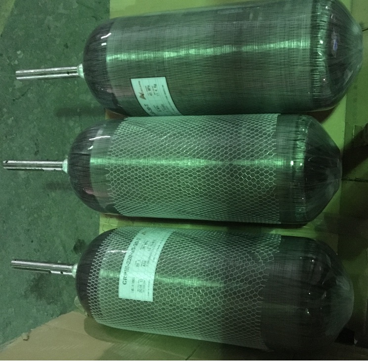

We use metric so I had to look up the L to CUFT conversion. I have 12L carbon bottle 300 bar, the free air would be 12x300 then giving 3600L, multiplying that by the listed conversion factor gives approximately 127CUFT.
Now I know that my 12L carbon tank is the biggest commercially availible in the market place produced anywhere in the world today, because I spoke direct to ACECARE who are the manufacturers in China along with Shenyang gas.
In fact the largest availible commercially here is 9L which is 95CUFT, so about what you guys are saying for your information the dimensions of the bottles are as follows;
9L 22" tall by 6.5" diameter approx
12L 22" tall by 8" diameter approx
pic below shows scale next to the typical 480cc Daystate/FX bottle.

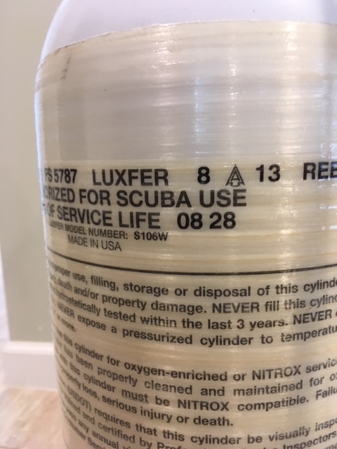

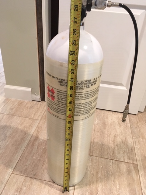

As mentioned above - Those Luxfer 106 tanks looked really nice, and I was close to grabbing one..
This was the source: https://www.diveseekers.com/Luxfer_Limited_106_CF_Composite_Cylinder_LALW106_p/lalw106.htm
DRAGER is another nice option - if you can find the BIG ones - especially in NOS consition.
