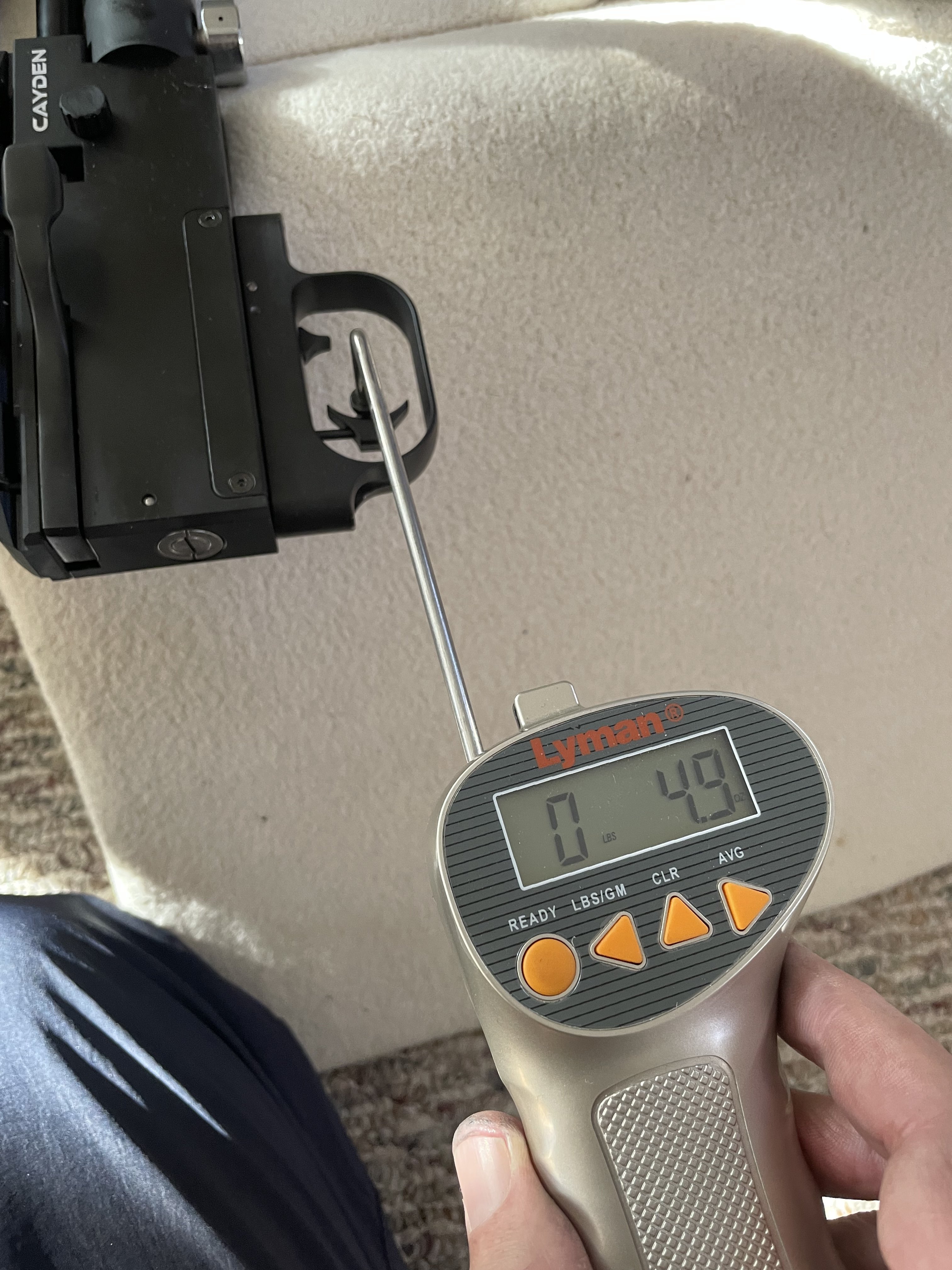

I’ve refinished the stocks in TruOil and did massive testing of optimizing hammer spring lengths. I previously did a trigger polishing on the Cayden - I got it breaking nicely at 11.5 ounces.

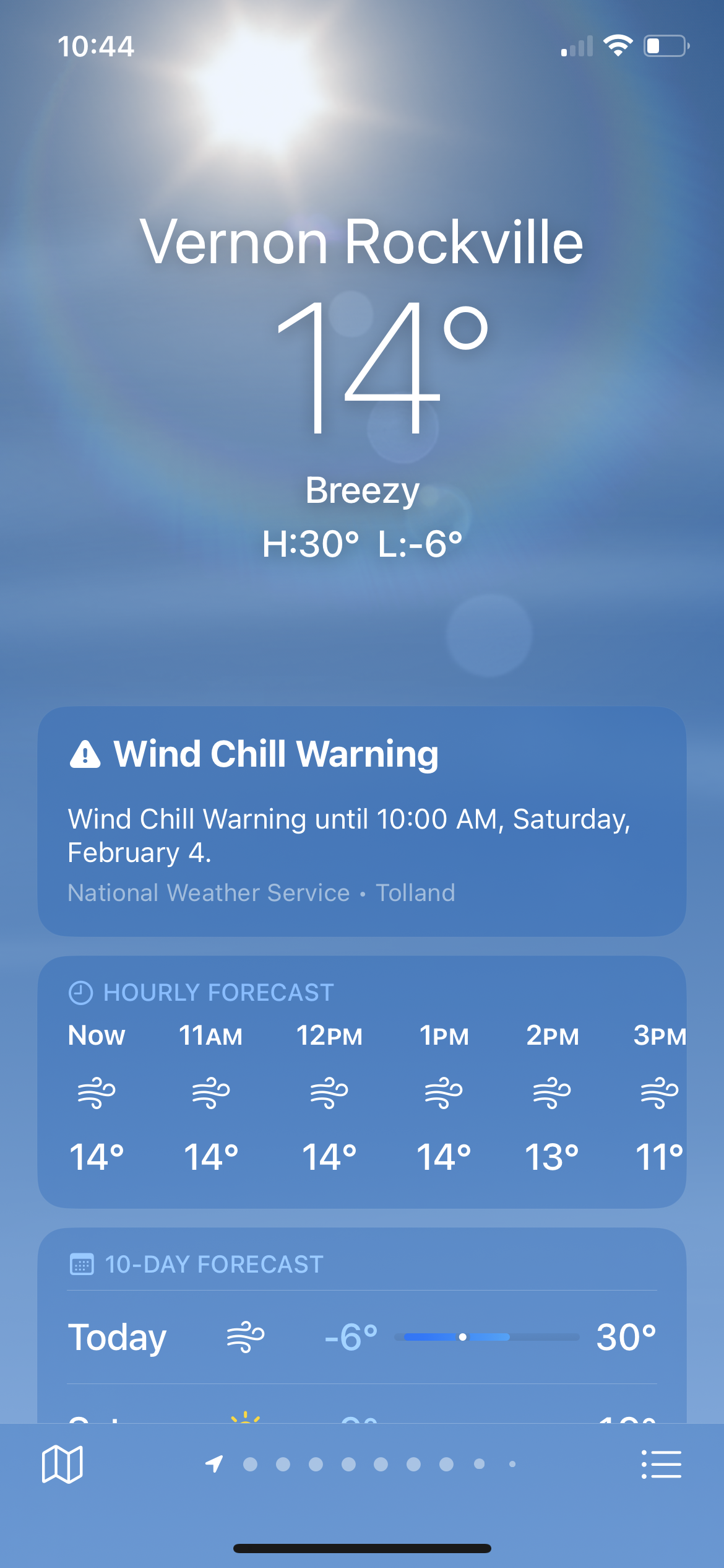

Anyway, today was 11 degrees with heavy wind warnings, so I figured I’d do more optimizing on the Cayden…

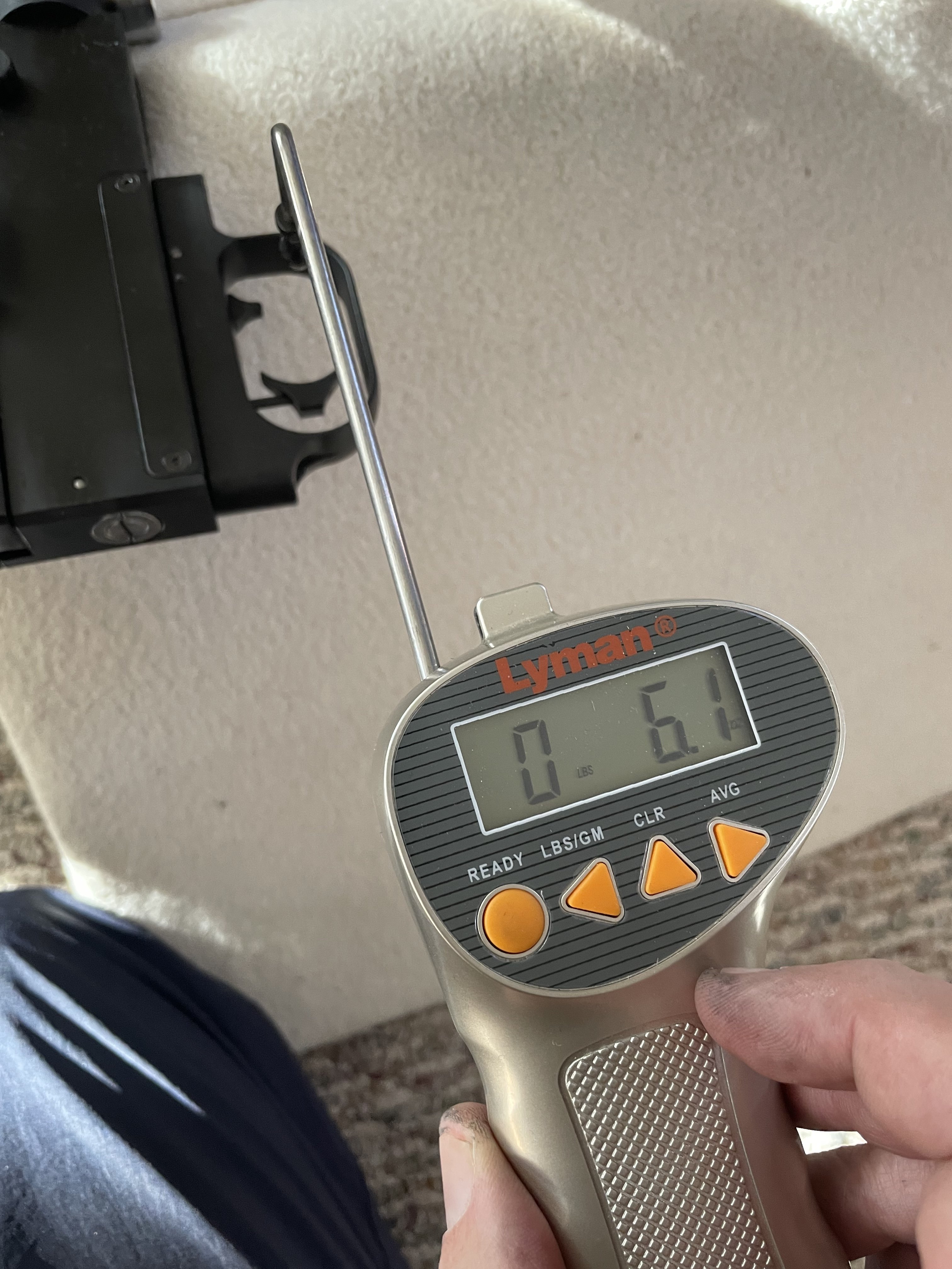

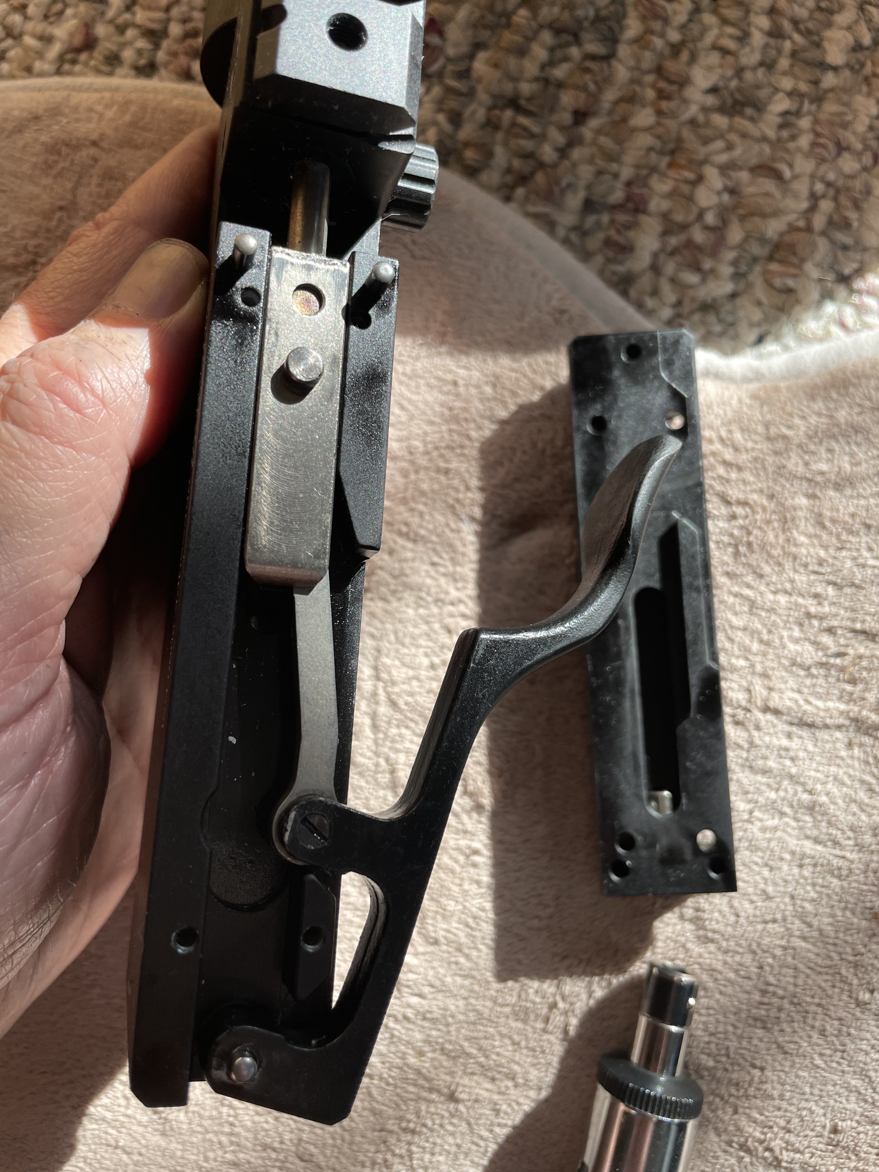

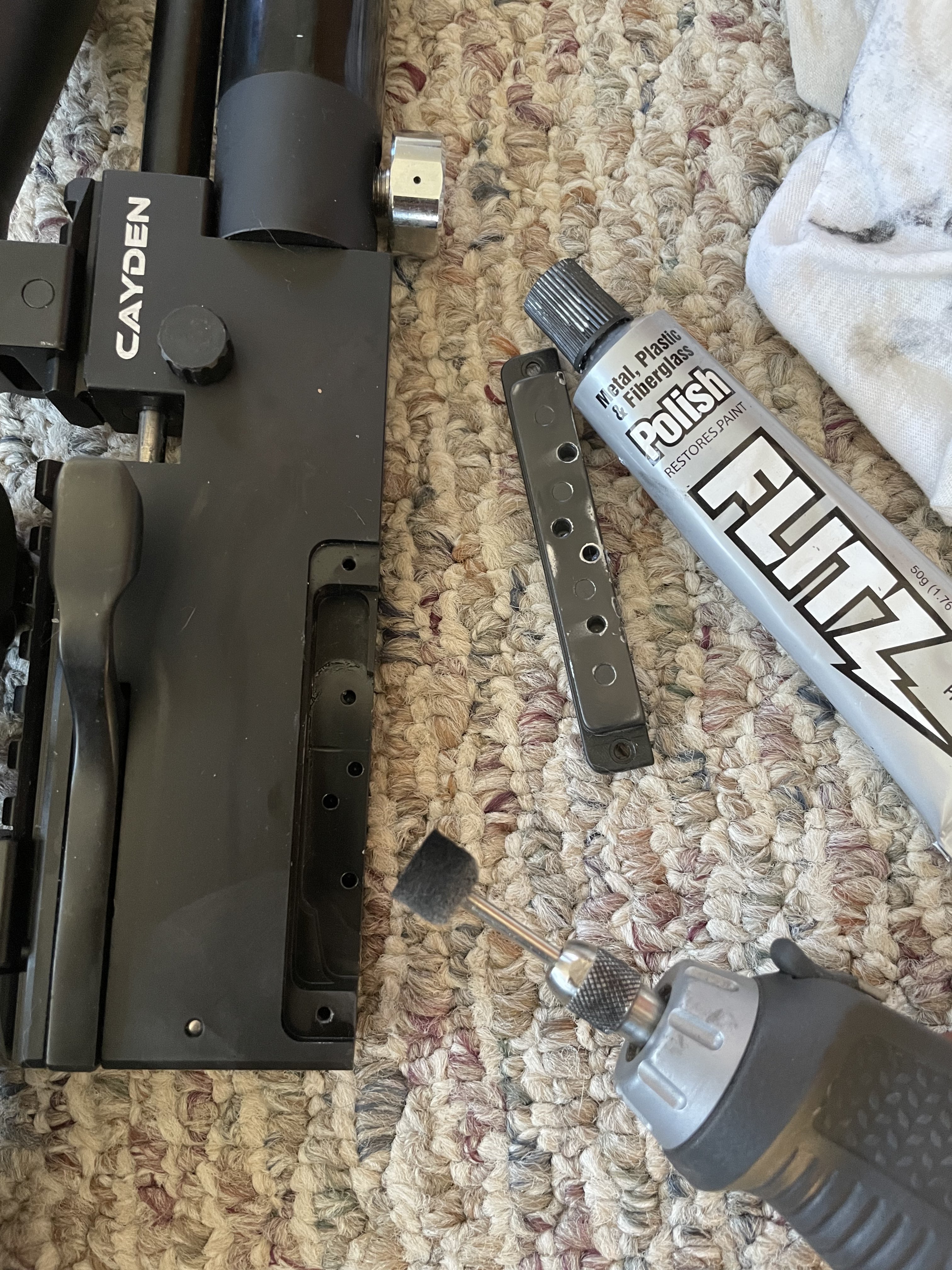

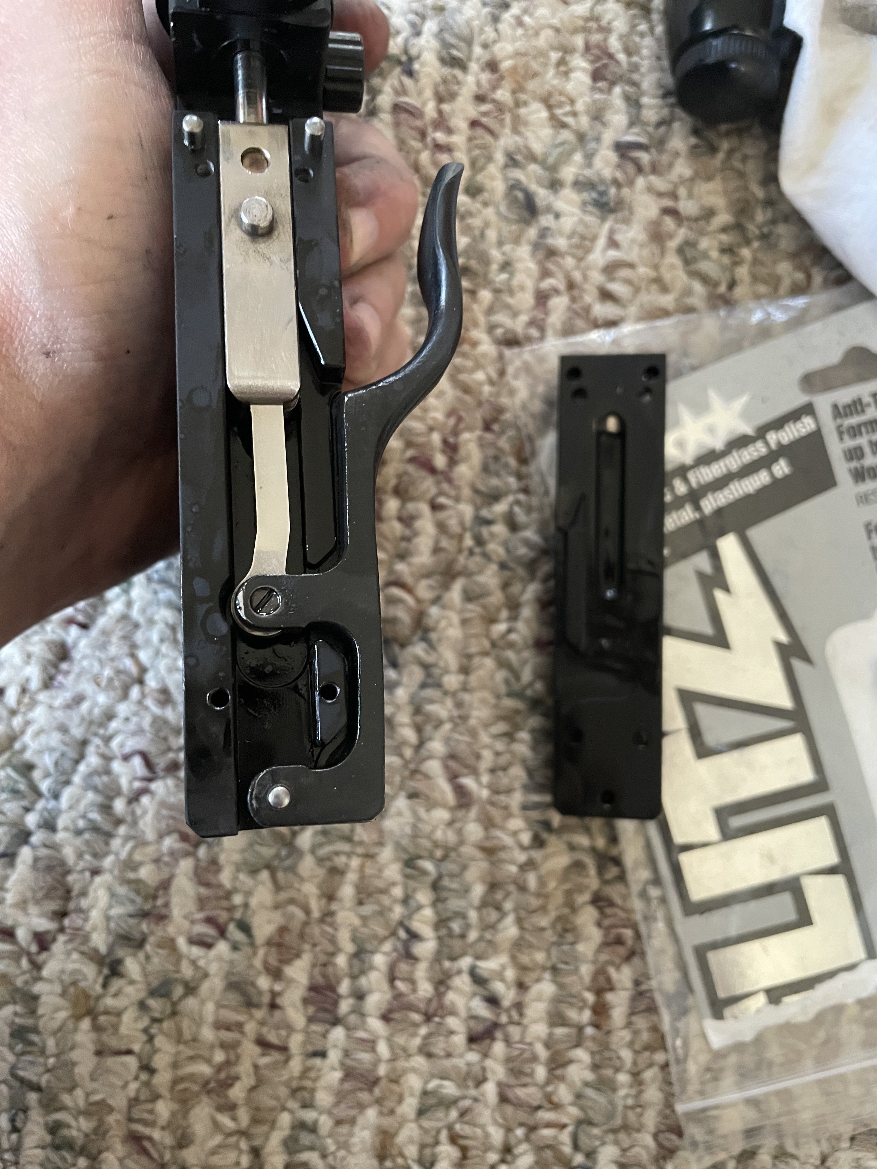

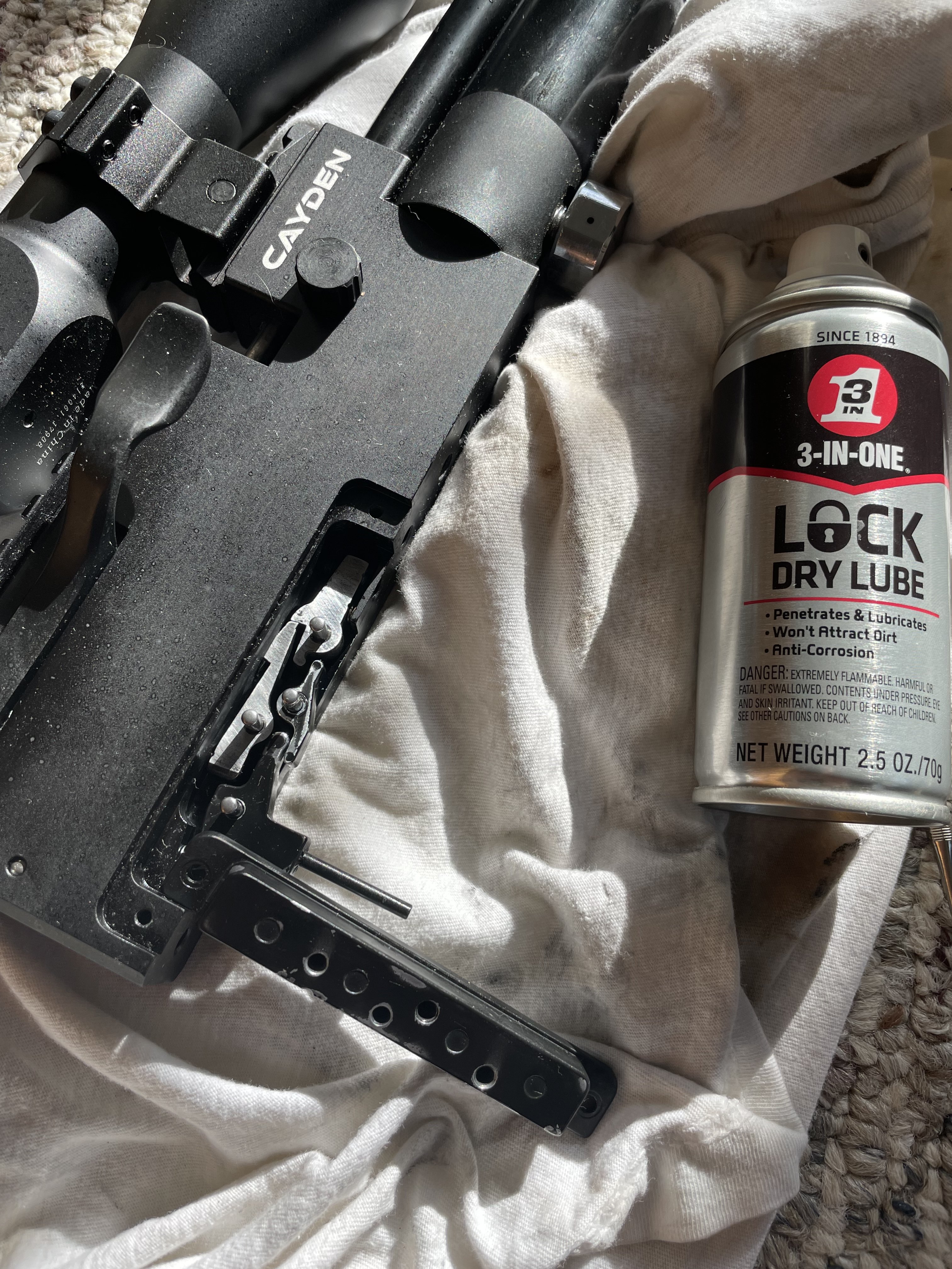

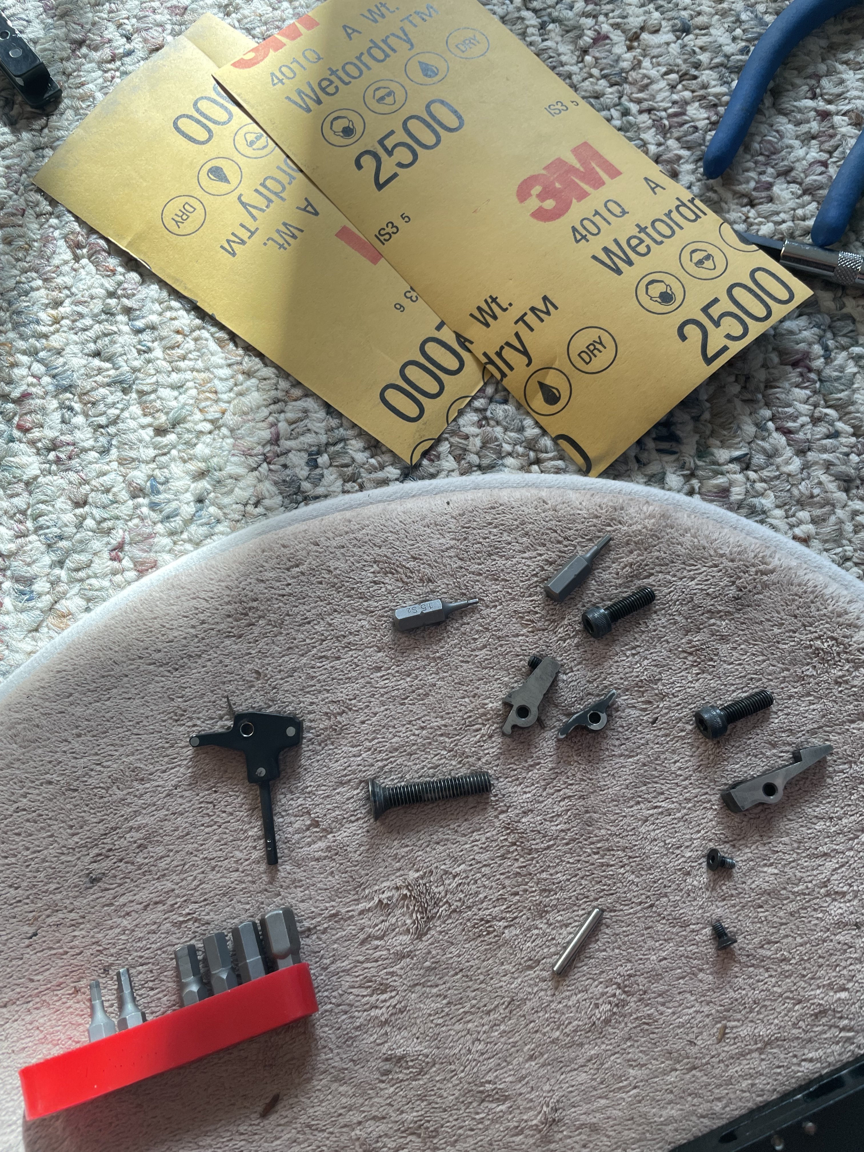

I tore the trigger apart and polished every sear, the pins themselves, the inside of the trigger breech - everything. Used dry lube instead of CLP FP-10 for a change.

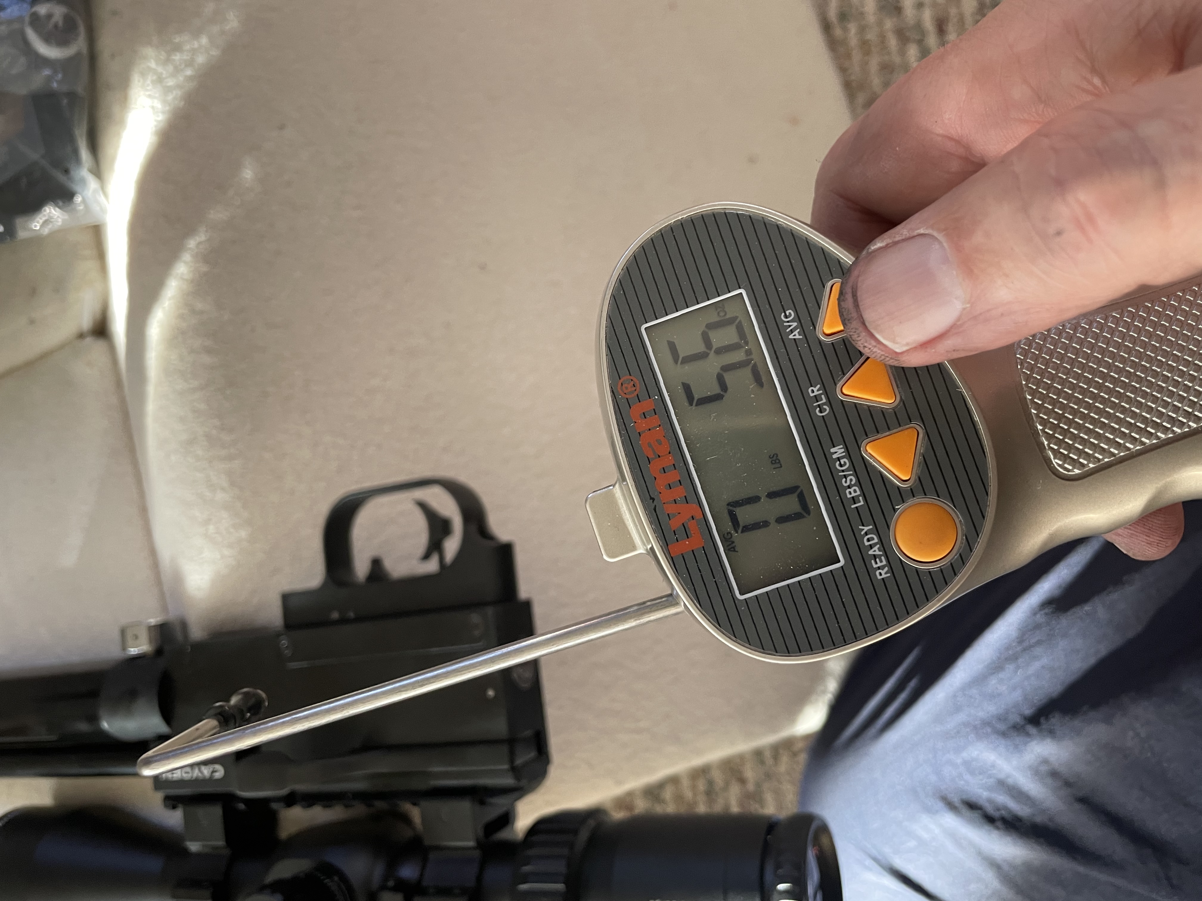

Put it back together and now I’ve got it breaking consistently around 5.5 ounces - and it passes the “bump test” . It shows just how far you can take these triggers with automotive paint sandpaper, Flitz and a Dremmel.

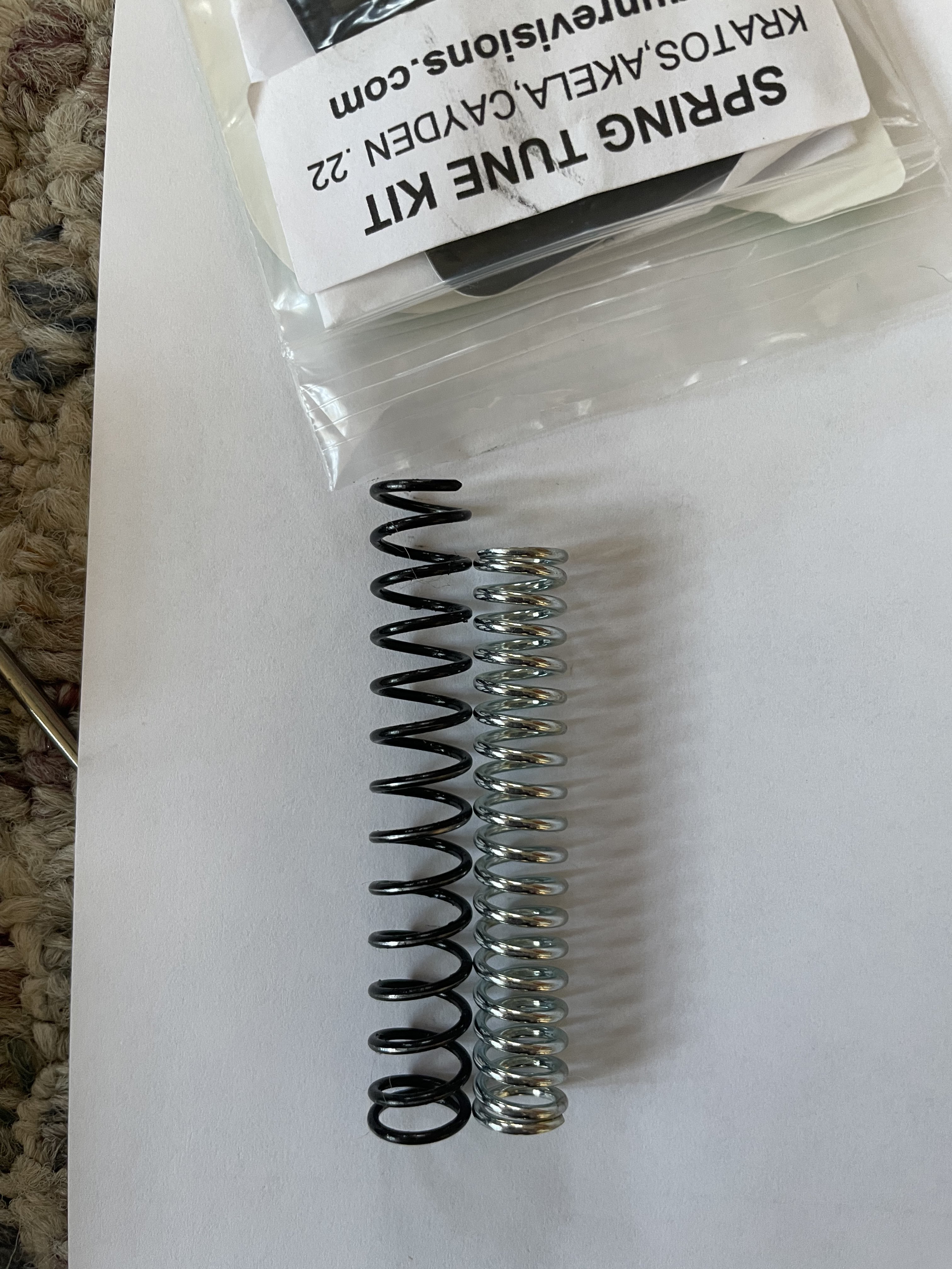

I was feeling so good about it that I took the bolt apart and hyper polished it - even though it was already smooth. I even stuck in a spring I got from a guy who runs Airgun Revisions - to see if it can improve on the performance of my 2.8” cut down stock spring.
I put it back together, put a chrono on it and dialed the spring in at 878fps. I’ll wait for a better day to try the 30 yard challenge with the “new” 5.5 ounce “target” trigger.

Well, I wouldn’t buy the Airgun Revisions kit until you spend some time cutting down the stock spring.

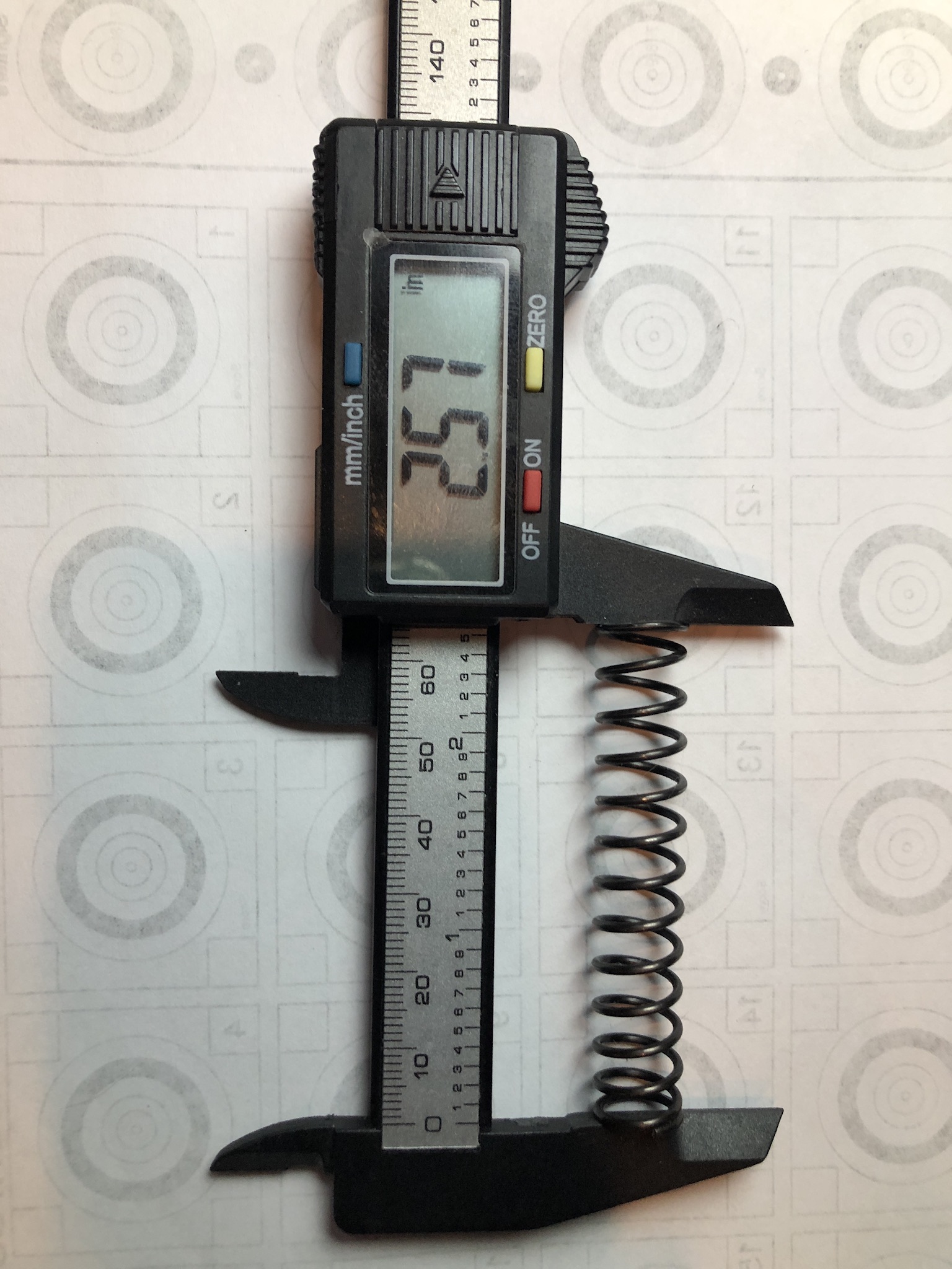

For .22 caliber, cut to 2.8 inches. For .177 caliber, cut to 2.57” - you will be blown away by the improvement in your shot string.
The Airgun revisions guy says that you shouldn’t do the valve spring if you are planning on shooting pellets 18g and heavier. So, I may try putting it in eventually - cause I’m usually shooting lighter pellets - 15.89 and 14.35 JSBs with my Cayden - I shot a 195 13xs on the 30 yard challenge with 24 of the 1st shots after the trigger tune. I like the lighter pellets as they enable lighter hammer spring pre-load - and it leads to an overall smoother shot cycle… which helps a lot when your target is a pin head at 30 yards.

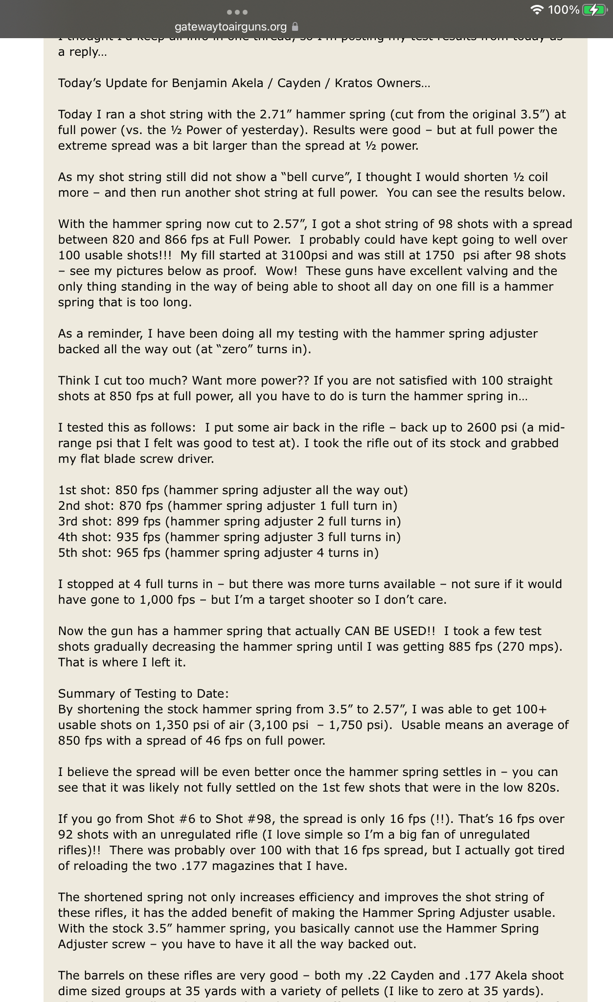

You do not need to “make contact” between the hammer spring adjustment screw and the spring PRIOR to cocking - when you cock the rifle it will compress the hammer spring .
Note the velocities achieved with the 2.57” spring backed All the way out and then for each turn in - using 10.3g .177 pellets - see pictures

Can you take the spring out of your rifle and put it up against a ruler or calipers to confirm exactly how long it is. Then we can go from there troubleshooting.
