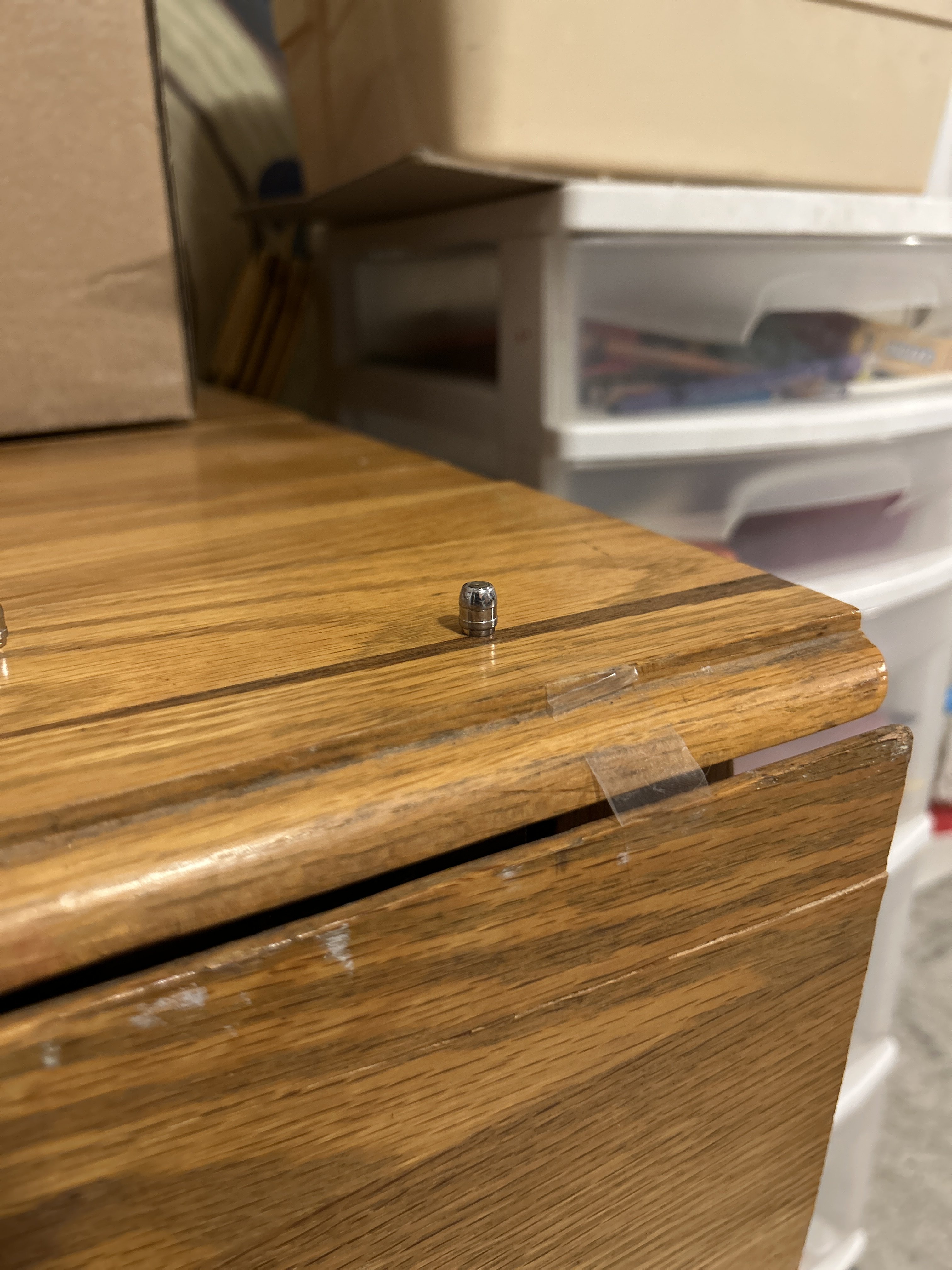

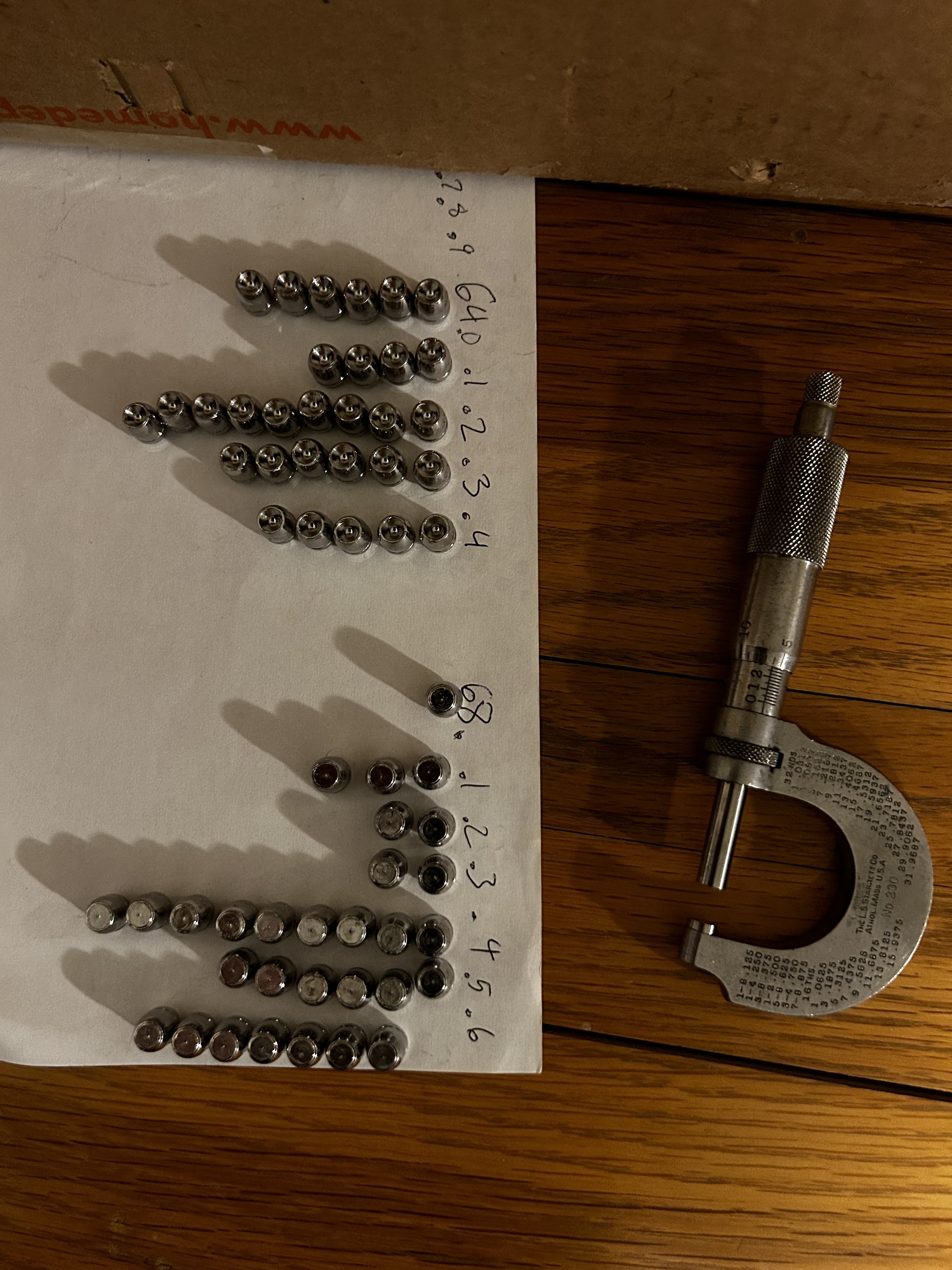

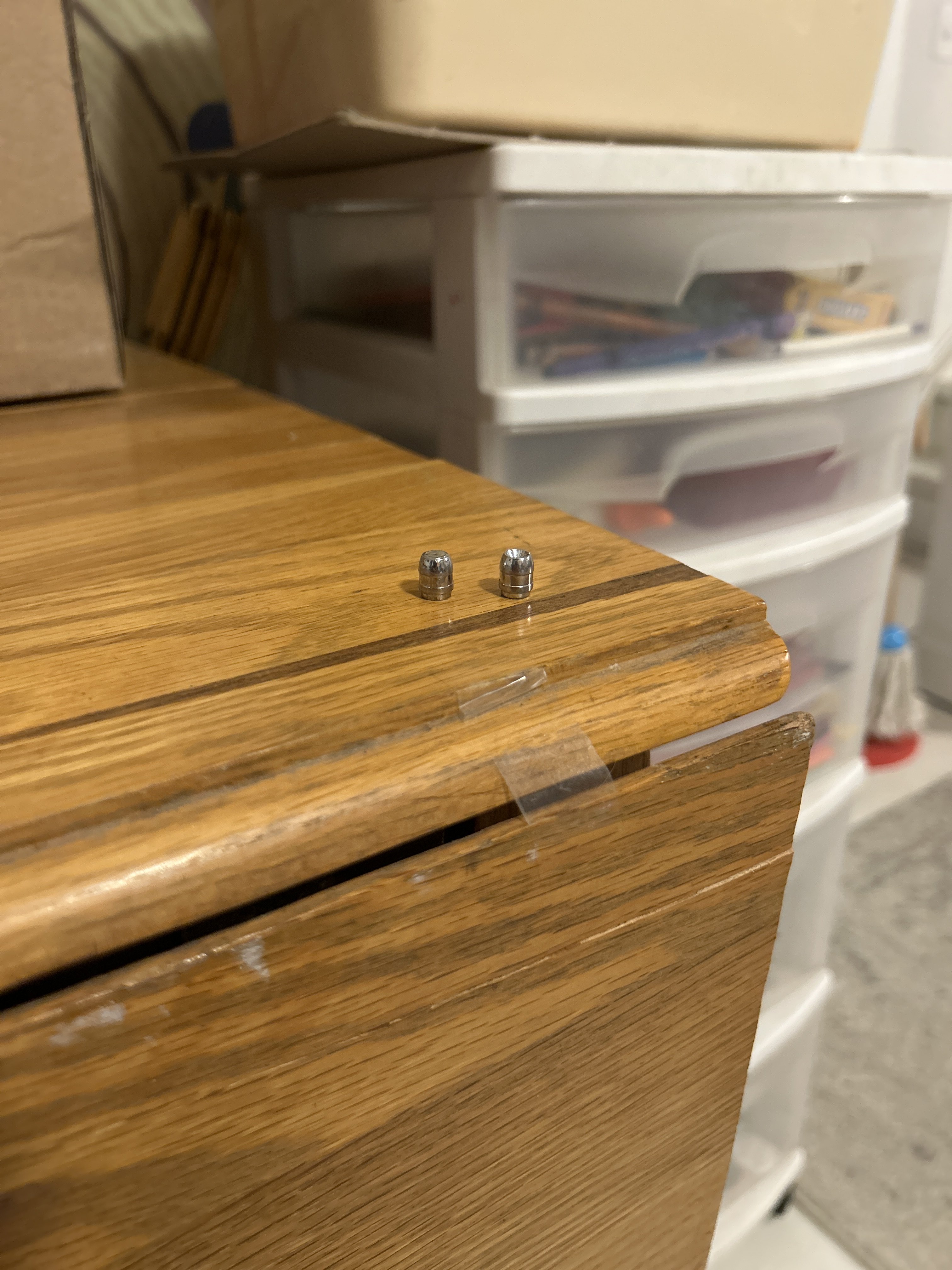

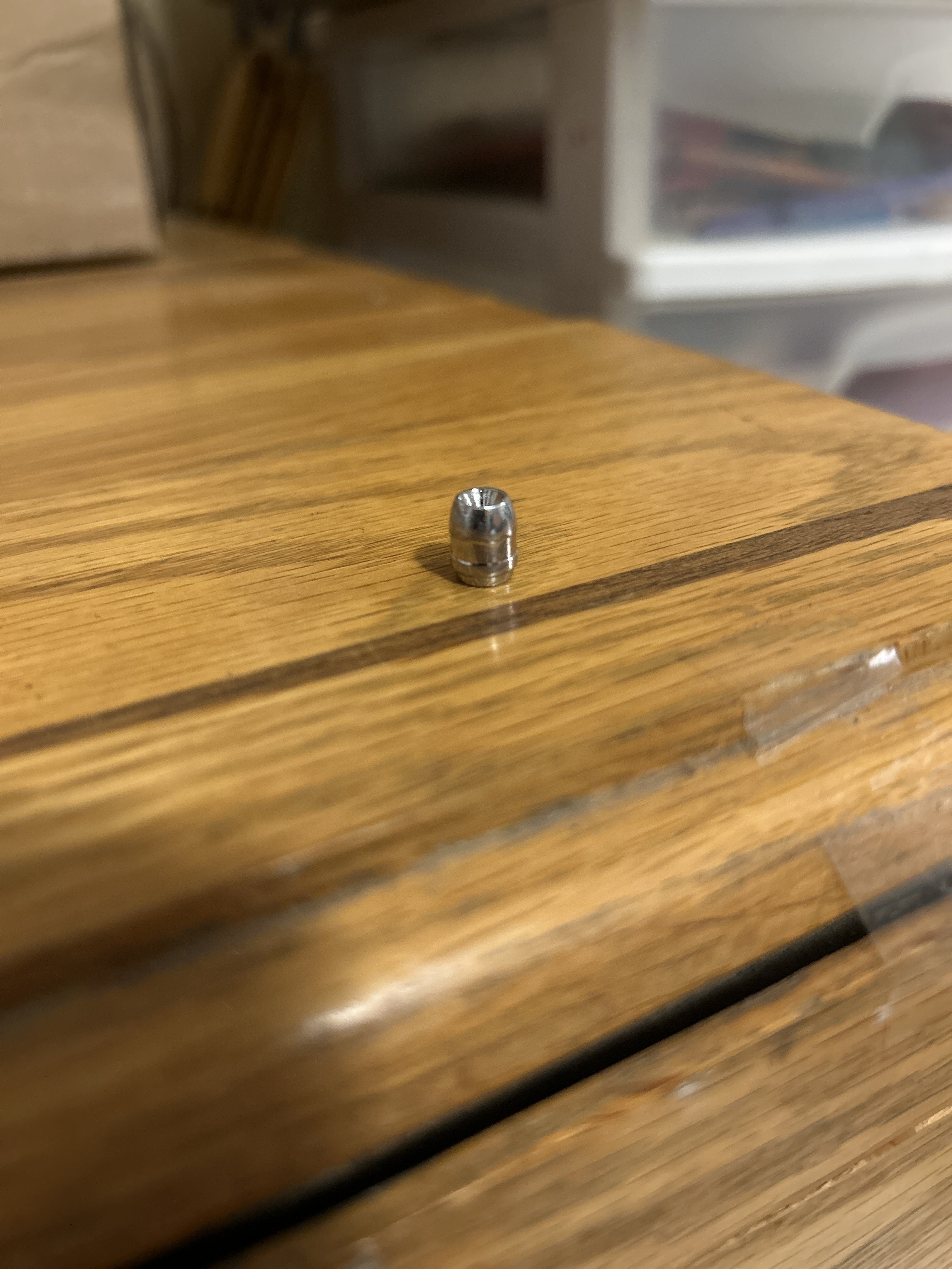

Just got a few minutes to run some out with my new NOE mould. The cup points are around 64 grains and the flat point are 68 grains thereabouts. Ran them out of pure lead. They mic out .3015-3025. We’ll see how they run in the neutral or may the plus barrel. Probably going to get a sizer in like .301. Here’s a few pics:
