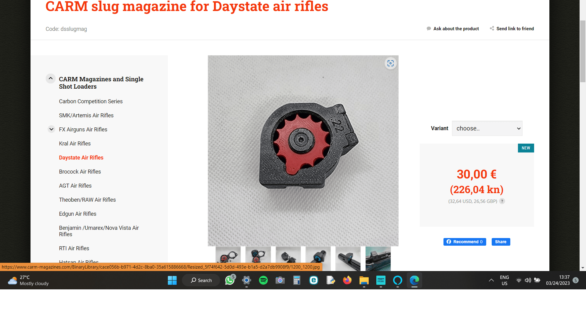

Carm magazine for a Daystate Revere .177cal
