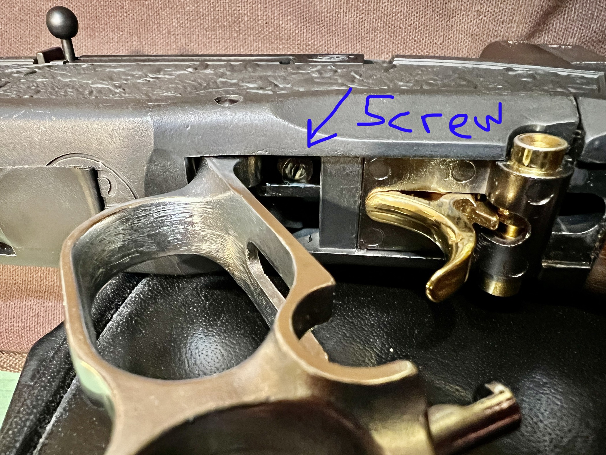

“ Quite simple really!
Push the underleaver forward to cock the gun and apply safety.Turn gun upside down,trigger uppermost,and look between where the lever pivots and the trigger blade,you should see a slotted head grub-screw which must be screwed in to lighten the trigger.Be very careful with any adjustments made.
Once you have the setting to how you like it,loctite the screw in place as it tends to move with use.”

Here's a pic of the trigger adjustment screw on my .22 Career 707 II. Turning the screw clockwise lightens the pull.
