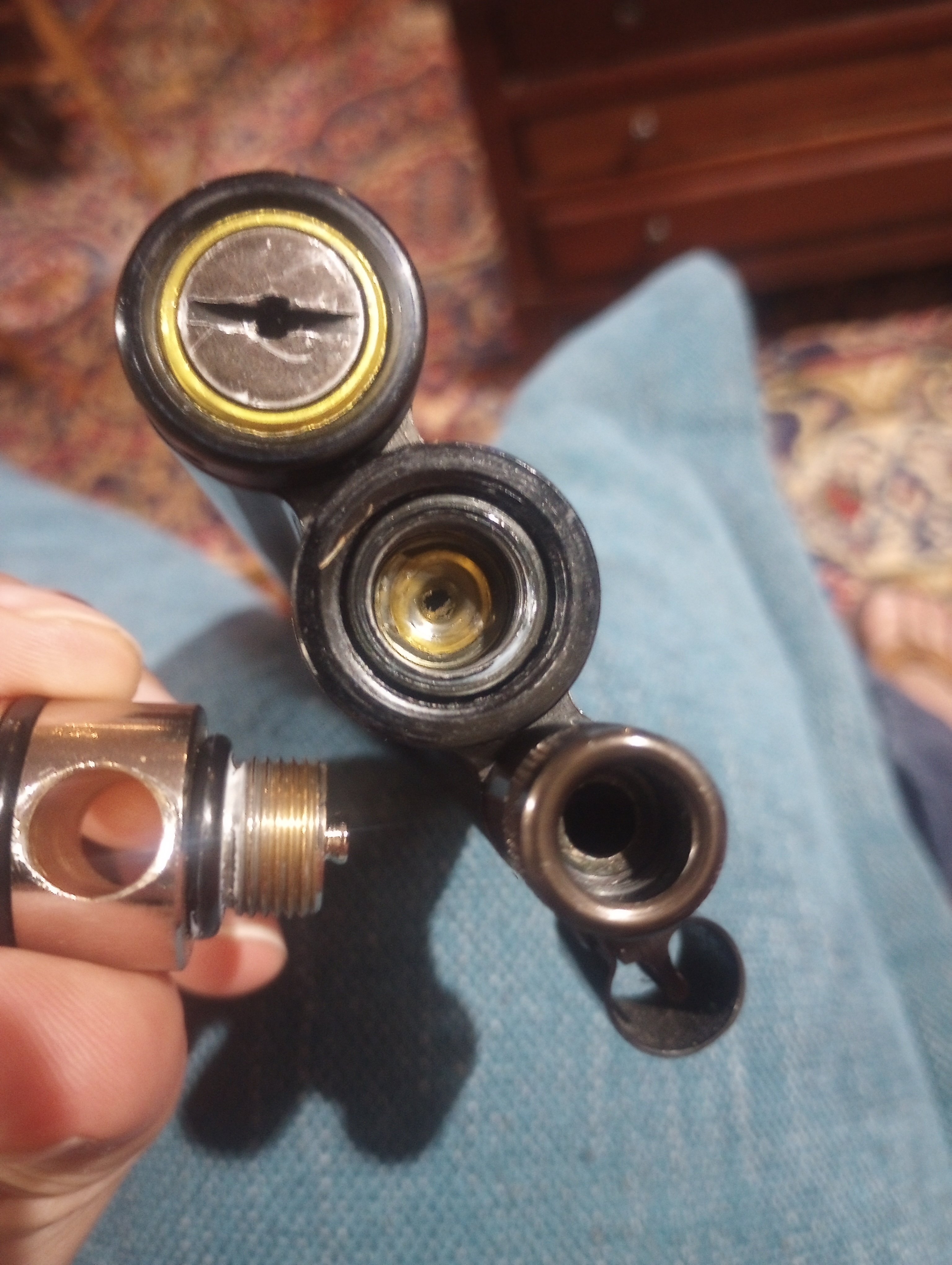

Is this the check valve you are talking about?
They were also infamous for doing that with slow bleed valves. The pointing down suggestion is a good one. You need to SUDDENLY open the bleed valve after filling to get it to slam shut. Some bleed valves can't do this so pointing it down and/or tapping the end with a hard plastic hammer or equivalent should get it to close...
