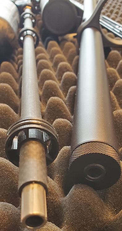

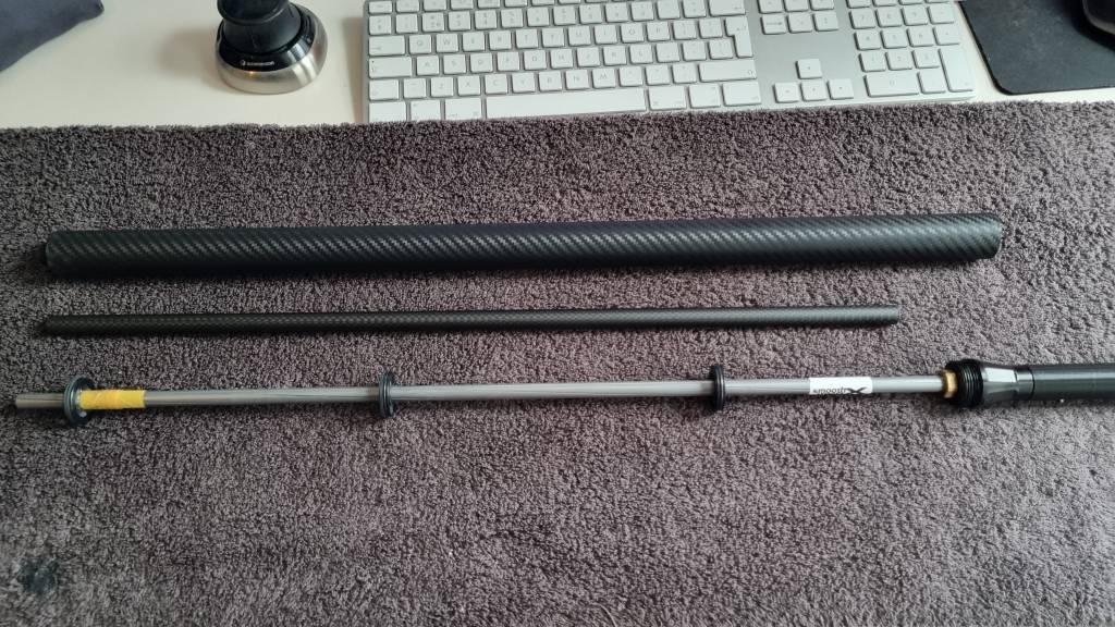

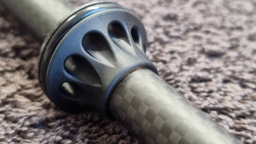

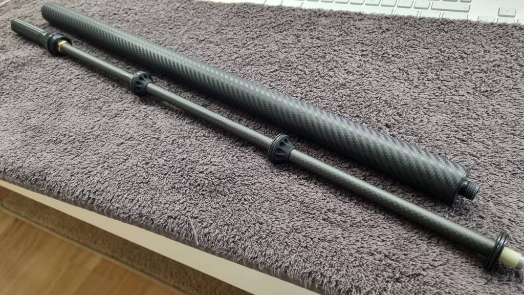

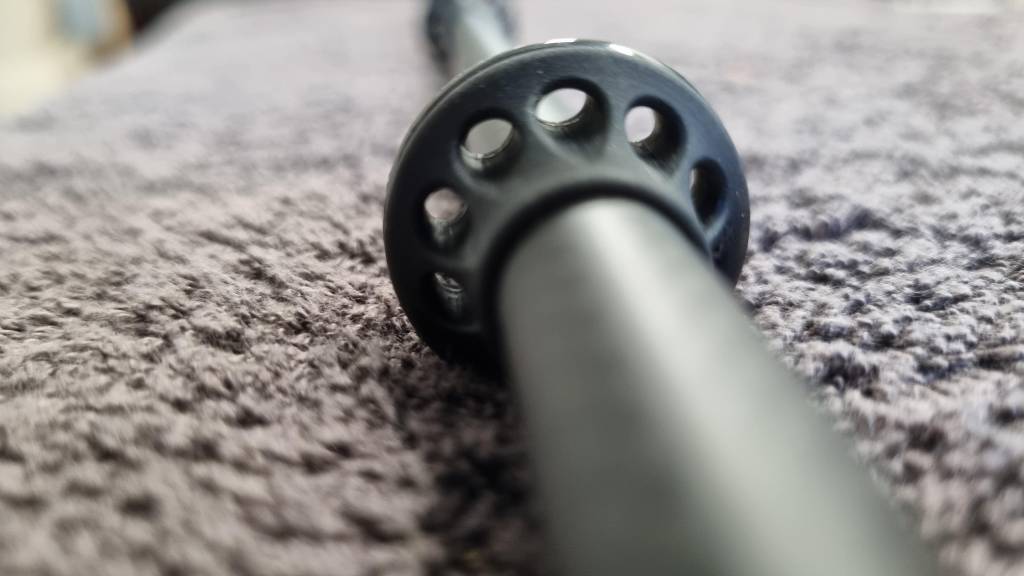

I have had some good results with the carbon sleeve on my M3. So I've made the same sleeve on my FX Crown. It took two new spacers over the carbon part. These are printed parts that I have drawn this morning.
Fits like a glove.

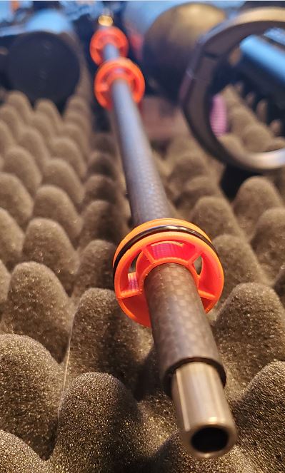

thank you for sharing. I printed it and works great.
Long story short, I bought an FX CF barrel sleeve from Talon Tunes before I saw this thread. When I disassembled the gun, the spacers between the barrel and the shroud obviously would not fit. So I called Talon Tunes and Tony told me they weren't necessary just toss them. So I did, and I fired the gun after reassembly, with a DonnyFL on the end. Well, obvious to me now, the shot caused significant damage to the DonnyFL. That sucks. Lesson learned. Fortunately that was it.

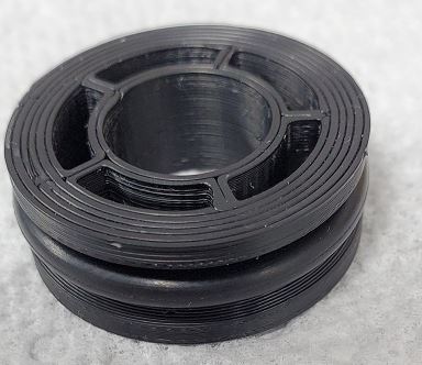

Then I found this thread, printed up the RTL, but the design did not turn out because I have a normal FDM printer not a resin printer.
So I designed my own version.
I have printed some extra so if anybody in the U.S. needs them check out the classified. Rigid, high temperature and strong ABS plastic that won't warp if left in a car on a hot summer day. (I wouldn't use PLA for these unless you're sure you'll never leave your gun in a car or truck on a hot summer day). They are for 0.25, but if you have a .177, .22, or .30 FX Crown get me the outside diameter of the CF sleeve and I can print some up for you to test. Check out the classifieds.
