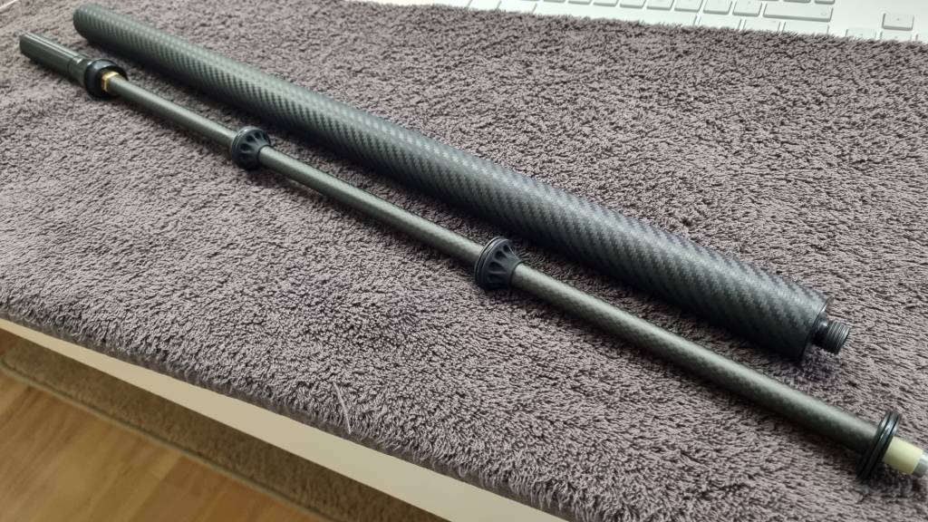

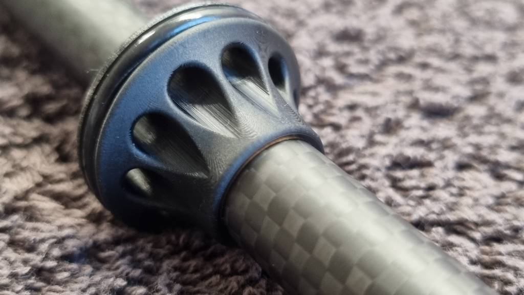

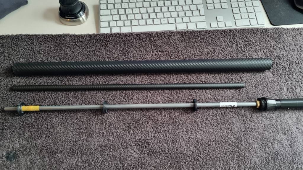

I have had some good results with the carbon sleeve on my M3. So I've made the same sleeve on my FX Crown. It took two new spacers over the carbon part. These are printed parts that I have drawn this morning.
Fits like a glove.

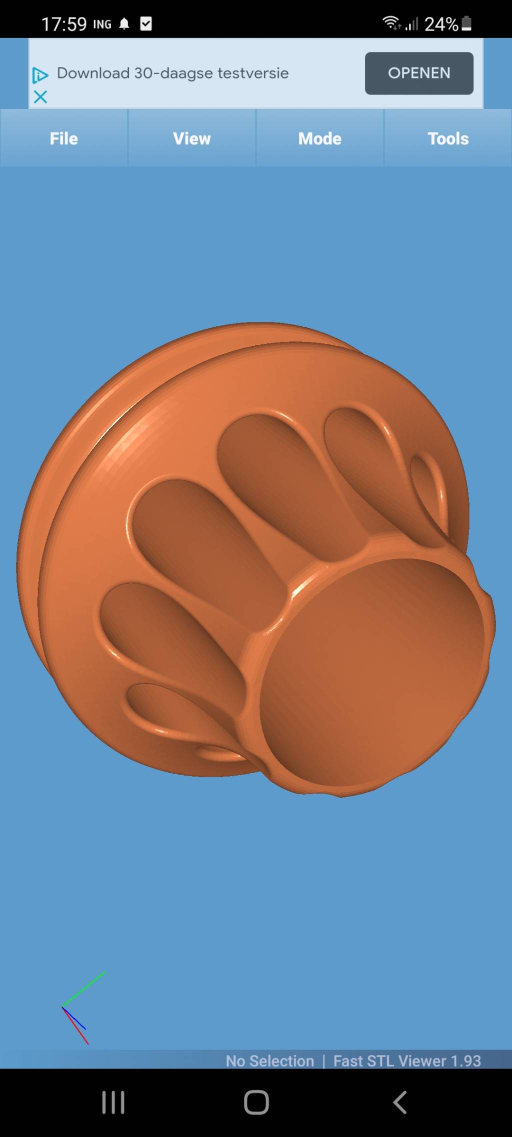

Is it an stl? If you don't mind emailing it to me, I may be able to convert and slice it for the filament printer I have. Though, I'm sure resin would be a better medium.... Hmm. Now I'm wondering how well resin holds up to oil exposure, haha. Most plastics for sure do not.

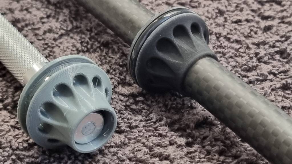

Yes, it's ans STL. you can use it with every slicer and so you can print it on FDM or SLA for sure. I have printed the grey left one this morning on a FDM (pla filament printer).
It's not the same quality as a resinprint, but surely without any doubt usable for the purpose. I have used the same offset and it came out perfect. Just print it slow and use a low layerheight.
Keep in mind, I have only drawn this one for .25 othe calibers will come soon.

Good deal. Even so, that design should be easy to modify for other calibers. I appreciate you sharing the file. My 3d design skills arent nearly where I'd like them to be yet. It is a lot of fun learning, though.

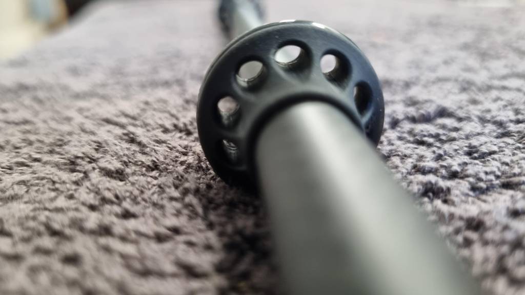

I hadda local gun shop with 3 x 3D printers, make two of the carbon sleeve spacers for me using your plan ($20 for the pair). Got em today along with a carbon fiber sleeve from Utah Air (timing baby!). The two printed spacers worked and fit well on my new carbon fiber sleeve. They were slightly loose and would move if I just pushed them in so I hadda use some electrical tape to hold the position. The O-Ring well/groove also needed some very minor cleanup to seat the O-Ring completely and it was a nice tight fit in the shroud. I really appreciate the effort and kindness in allowing the use of your idea, much appreciated! Gonna go test em manana!
