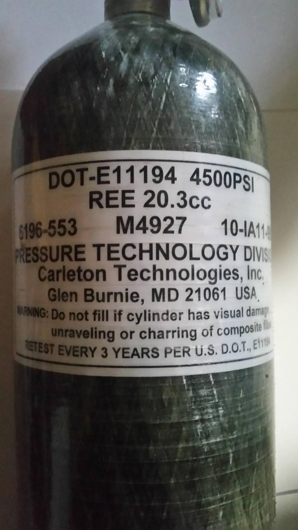

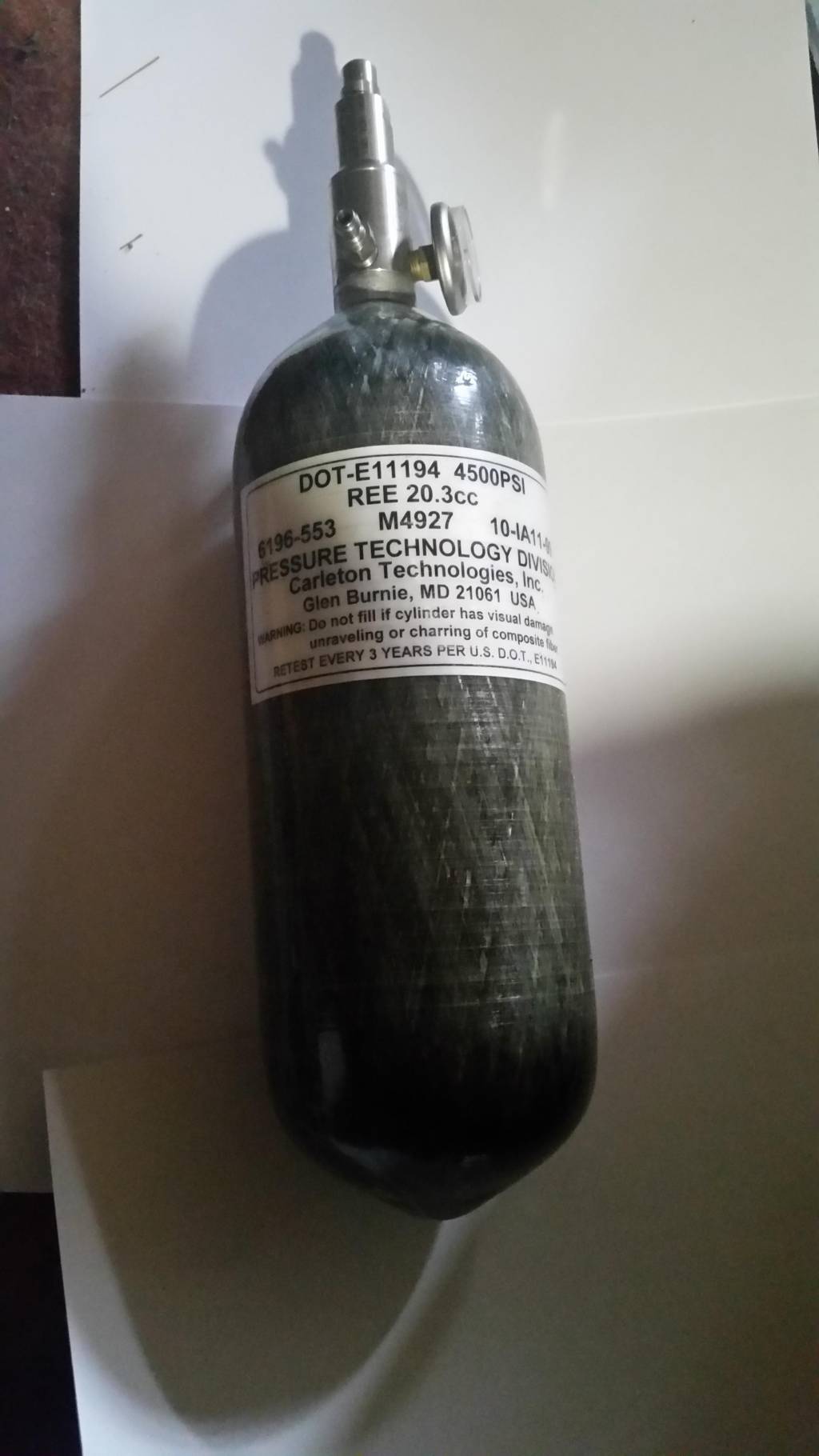

i have a tank that is about 11.5 inches x 4.5 inches across (13 inches dia) i like to know the about how many ci it is???

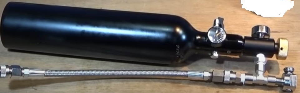

also I'm looking more information on the valve air america raptor rex 9473 or can i make up something like this pic 3
one more thing thank you all for any help you can give....
Empty the tank and remove the valve. Fill the tank up to the threads with water, then pour the water into a large measuring cup and see how many liters it holds. Then use the chart at the top of this thread and convert the amount of liters to cubic inches. That is a small tank and appears to be 90 cubic inches capacity based upon your dimensions.
