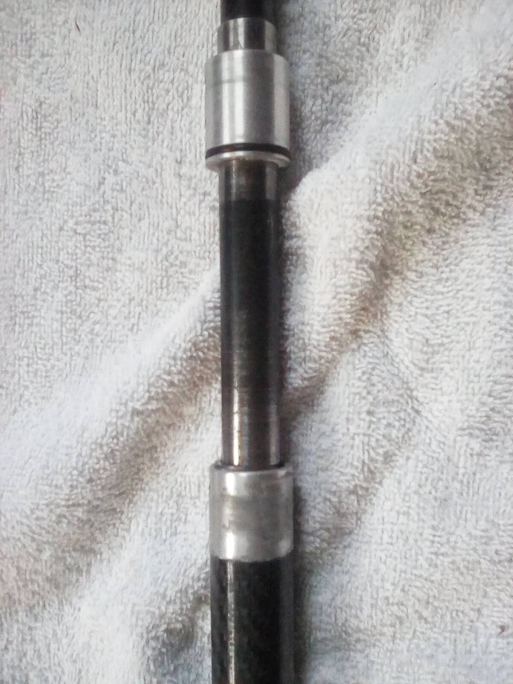

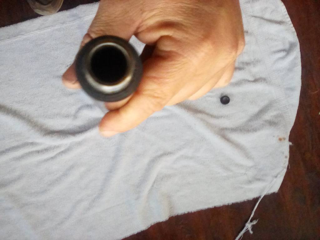

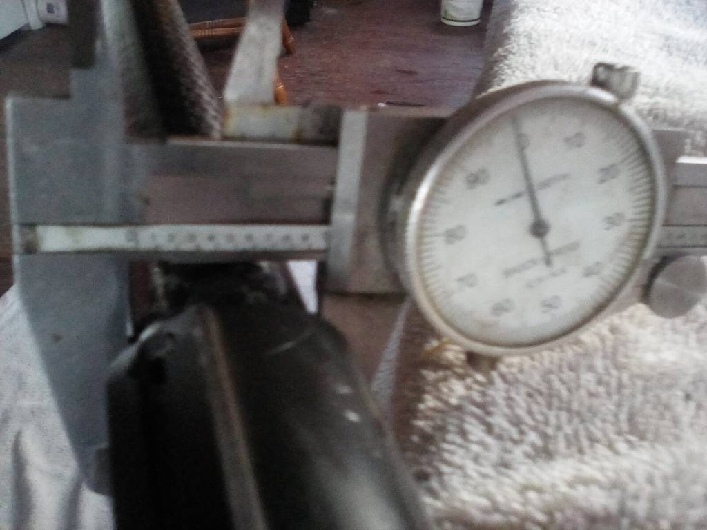

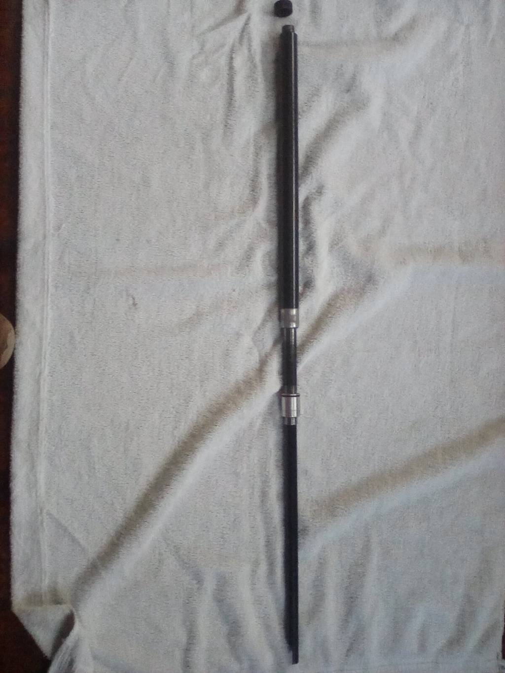

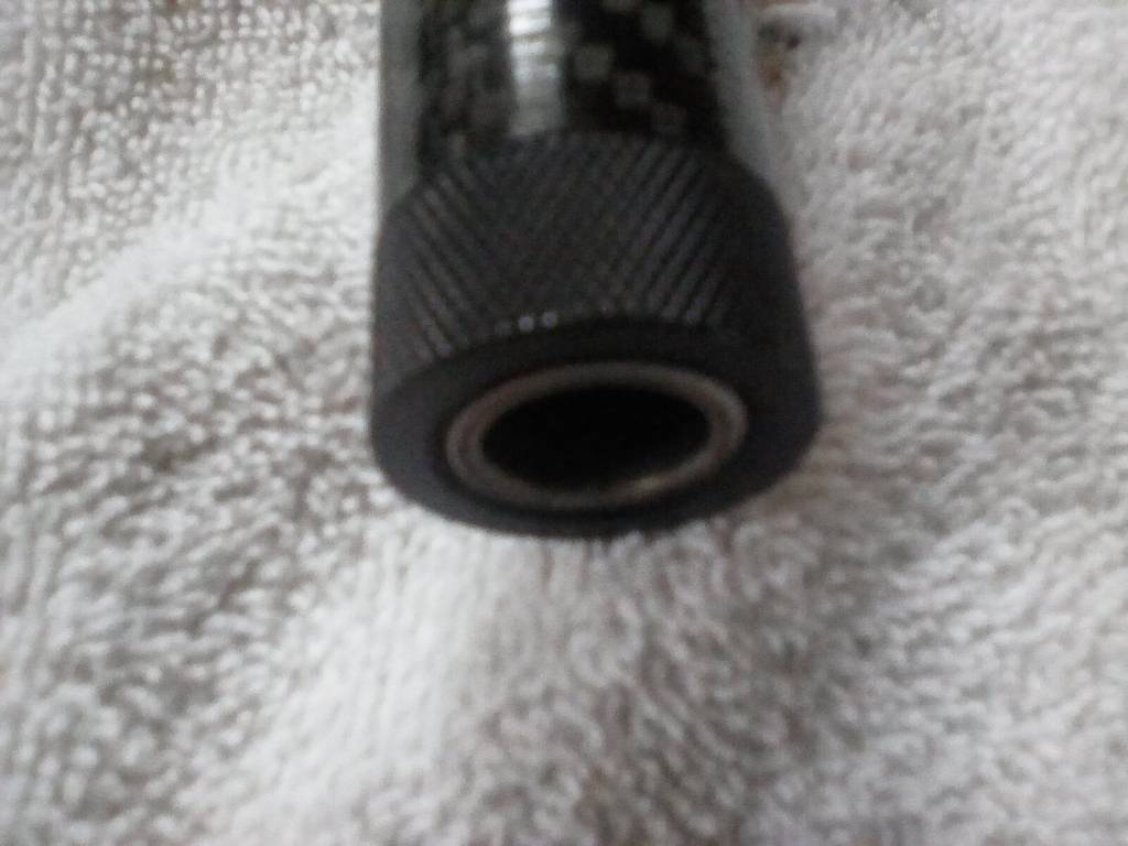

Had my Texan tore down . I wanted to post some pics to try to simplify the ease and significantly add strength and full length bushing in youR frame. The sleeve is .250 thick 1.00inch outside and .750 inside the barrel is .750 outside diameter. The frame is 1.005 inside You have 5 thousands wiggle room just enough to slide in. Use your two end cap grub screws on the frame to make perfectly tight. Sorry I didn't save the place I bought the sleeve from but the hardest part was convert mm to stand measurements. The sleeve was a $100.00 a year ago and was long enough to do 2 barrels. Thought this might help some of my friends on within nation. Good day
