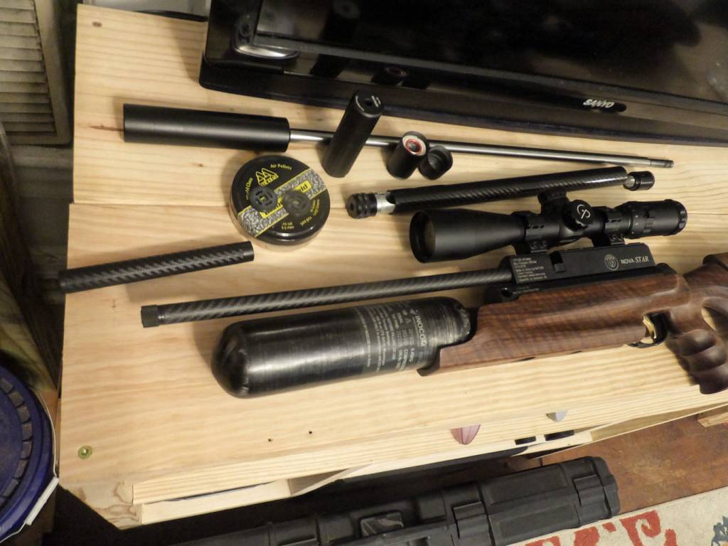

Matte finish and hidden inside of the black aluminum shroud. Explain to me how this is for "looks" again? Also took time to make sure bond was as uniform as I could get by slowing working it into the tube. Then let it set up while installed, and supported inside shroud. This barrel shoots outstandingly.
The barrel on the other gun has a LW barrel bonded with Matte carbon fiber as well. I actually have a tensioning shroud that makes it shoot even better. Carbon fiber is desirable for its stiffness and lightness. If I had wanted something heavier, I would have used aluminum or steel for the tensioning shroud.
