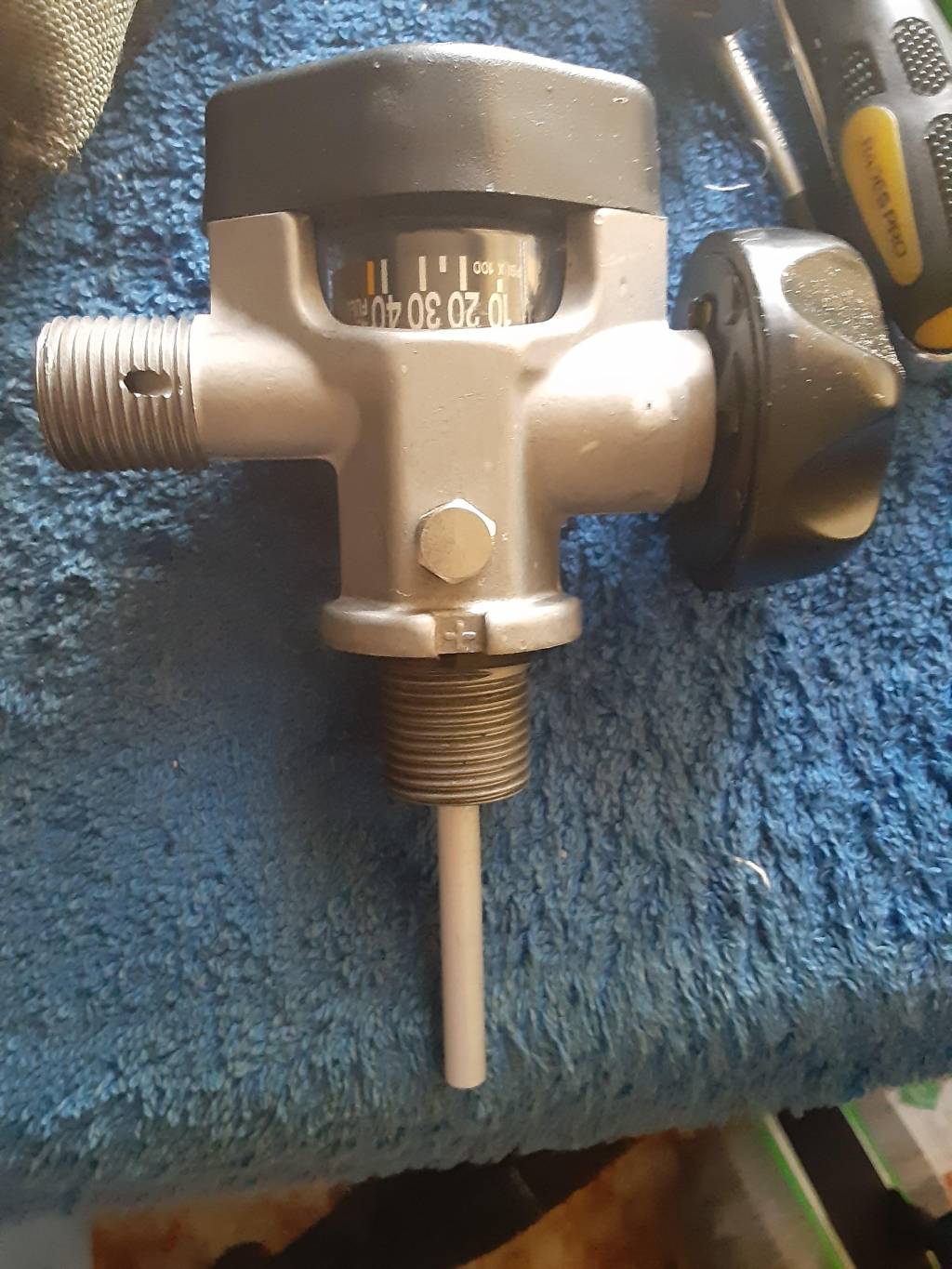

I have never seen an air tank and valve assembly taken apart. Does the valve have any type of pickup tube? Or does a valve just screw into the neck of the bottle? Reason I ask is could a person turn a tank upside down and crack the valve blowing moisture out?

The purpose of that tube is to prevent accumulated water being breathed. It serves no other purpose, but it does prevent draining any water, if there were to be some. In our application they should be removed. I believe they are threaded 1/16 NPT and simply unscrew.. Those tank valves are not installed very tight They seal via O ring. If you suspect water in the bottle, drain all the air and remove the valve and look.
Thanks for those that gave answers. After reading posts of guys worried about not having good filteration. I thought a better than nothing thing they could do is turn their bottle upside down and bleed a small amount of air in hopes of purging. I know it won’t replace a filter. I have read my air and the dew point is very low with my filters
