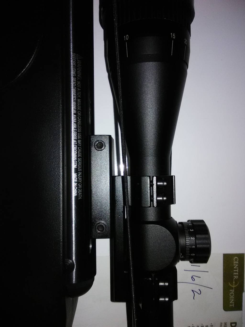

I just redid mount on my CenterPoint 3x9-40 to Crosman F4 Nitro-Piston .177 for that reason, plus, I needed more scope eye relief. The product shown is a CenterPoint Optics Dovetail High Profile, Model CPM1PA-250F. So far, so good. Purchased from Amazon, not expensive. Since scope and mount are matched, might be reason mentioned by Ripper, that it seems to be working. WM

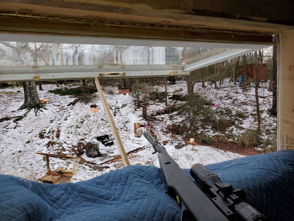

Put the UTG Accushot on it. I had to drill another stop pin hole a bit fwd of the original bc it wouldn't fit.
Leveled on the Bug Buster.
Icy, snow, rainy day here in NC. Got up in the tree house, zeroed/sighted in at 25 yds, Crosman dome 10.5g. 7g pellets fly crazy from this rifle.
From a rested position thru a window, I was pinging targets out to 25 yards, 1" diameter.
Lightly tightened the screws once.
I'm now okay sighting in squirrels and other small targets with confidence I can place a humane shot.

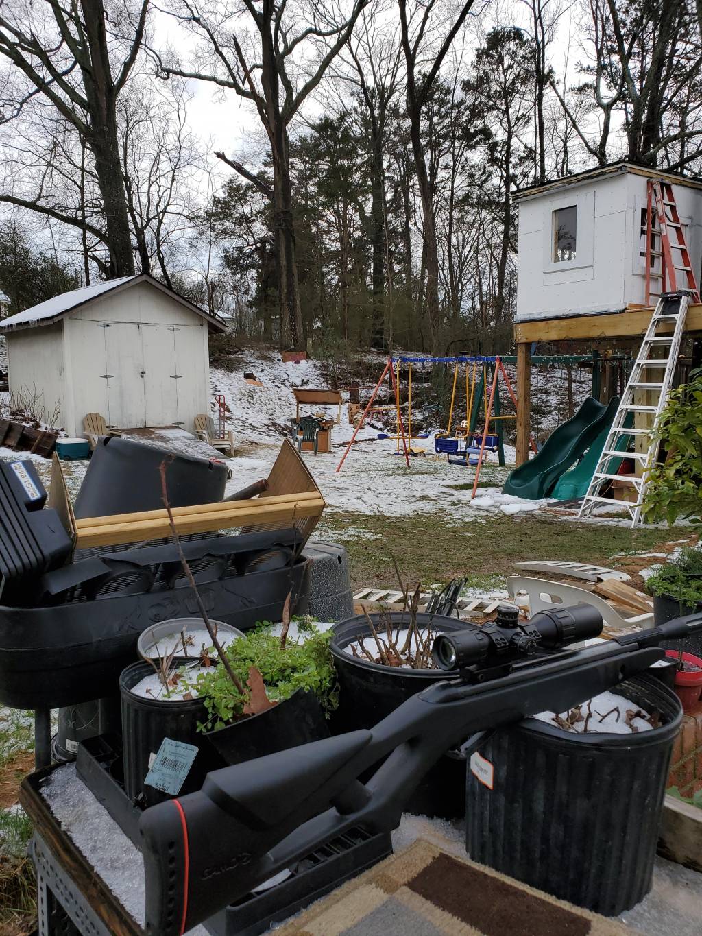

UTG Accushot, high, one piece mount.
So I had to drill a new stop pin hole fwd of original.
Cleaned the tube and rings, and put loctite blue on upper rings, and top ring screw holes. I probably was a bit liberal with application, but after three sessions, zero movement, and I can confidently say that all my misses are my fault.
