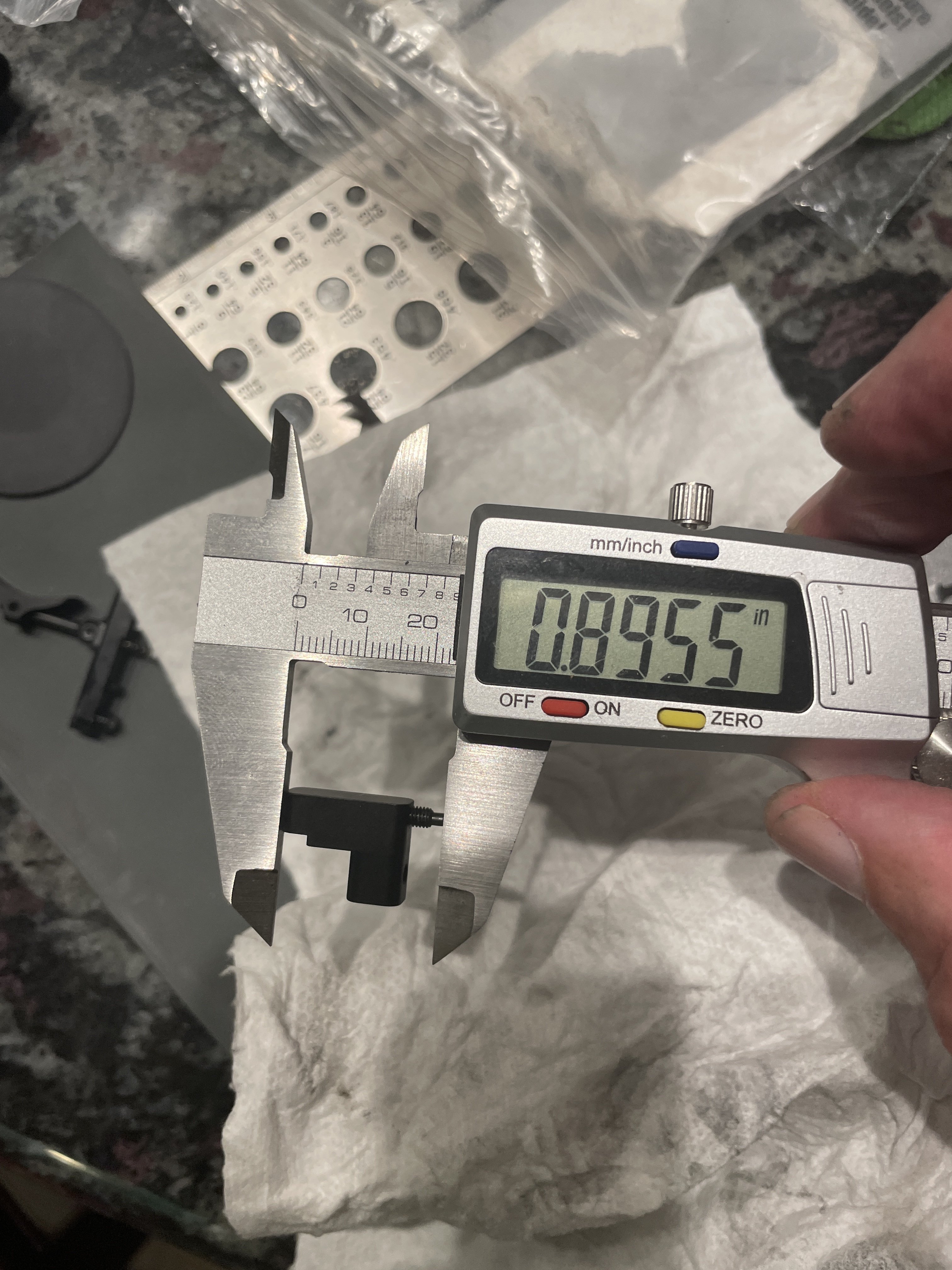

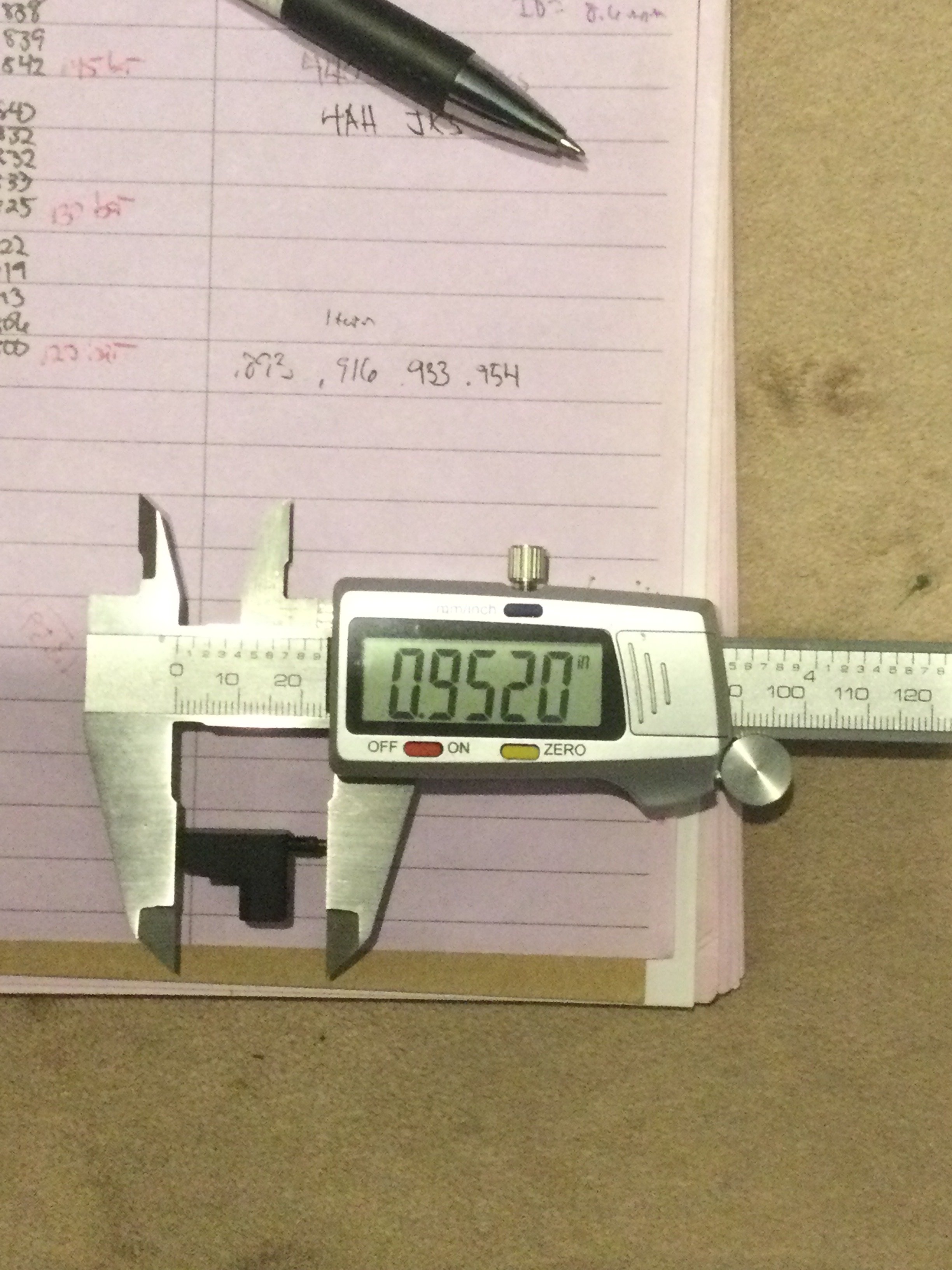

To the original poster - pull out your hammer adjuster and measure it with calipers.
Here is a couple recent settings I’ve used on my 3 Crown Mk2s - see hammer adjuster preload measurements below.
-Ed
