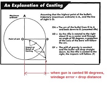

... So your statement that "it will hit left an amount equal to drop" is simply and plainly incorrect. And as long as you adhered to such a view, you do not understand.
With an uncanted gun, the barrel points slightly upward to compensate for drop. When you cant the gun 90 degrees to the left, the barrel now points slightly left, so that is where the poi will now be.
This picture has the barrel pointing to the right, but same affect. Windage error = drop distance:
I think we are making progress, as scope height is no longer part of the discussion. It's now about drop (gravity) and cant angle. And that is what determines gun cant errors.
"It's now about drop (gravity) and cant angle. And that is what determines gun cant errors."
This is close, for now, as you state angle (correctly) AND GRAVITY(incorrectly) is what "determines gun cant errors". But I believe I can find a direct quote from you stating that there can be no cant error without drop.
