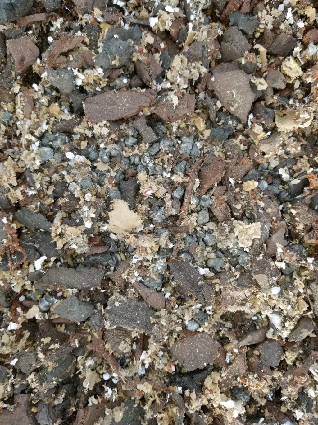

From what I found today - yes AND no. So I went out to my trap to change out the cardboard target face. I found some of the mulch and pellets on the ground in front of the trap. Ok, it's been too long since I swapped the cardboard out. I open the faceplate, remove the old cardboard and:

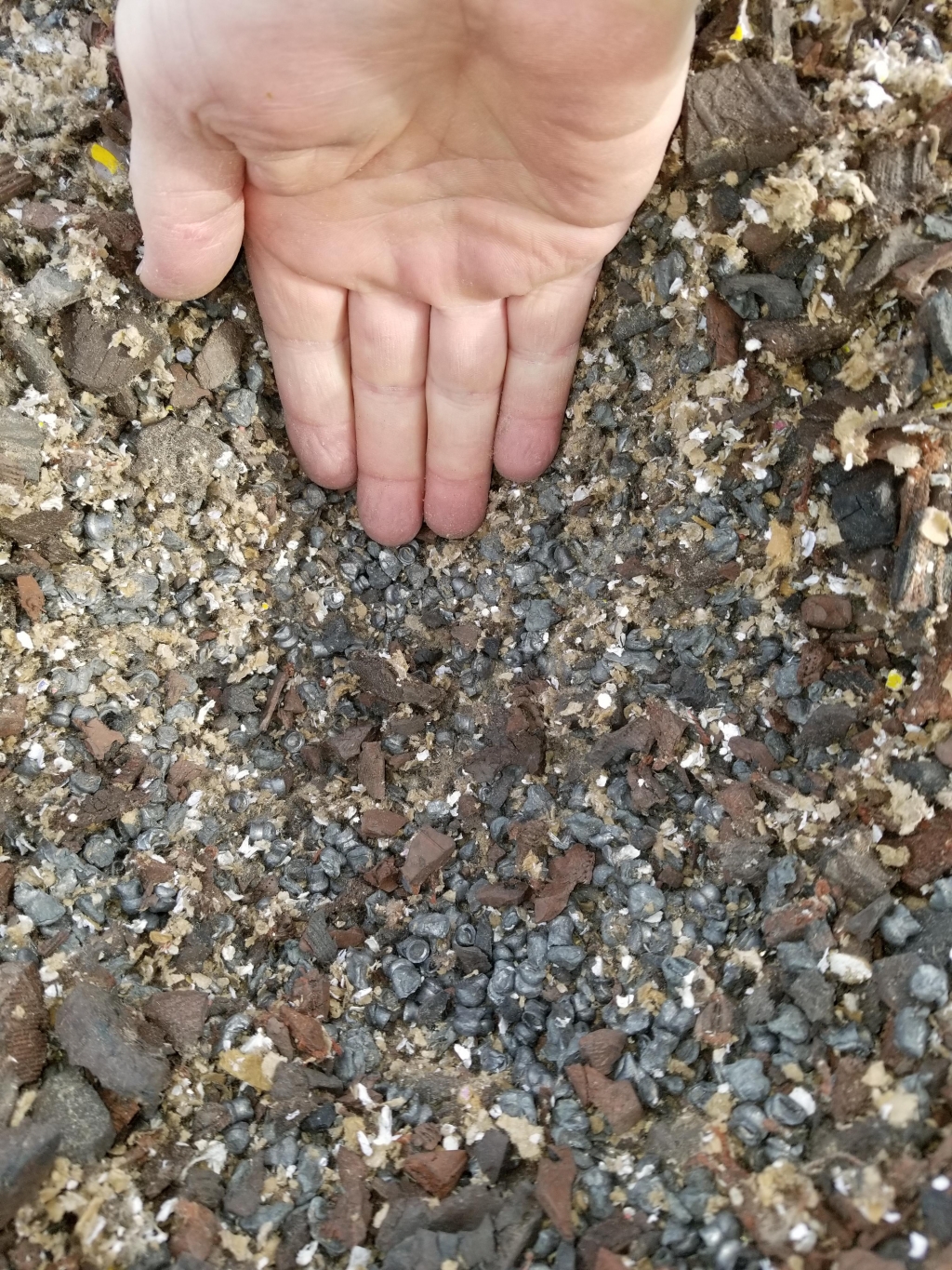

It is pretty well packed with pellets. I figure that I need to "fluff" the rubber mulch so that it will trap the pellets and not drop them out the front of the trap. I start to mixing and find the whole trap packed full hand deep.
The only mulch not laden with pellets is in the corners. I did not realize just how much I had shot into this trap. It seems to me that as you continue to build up lead in in the trap that added mass makes for a better trap. So, wear the trap out - No. However, with so much lead built up in the surface of the mulch the pellets are not penetrating. Now I'm getting pellets hitting the trap and falling to the ground in front of the trap. So it has lost some effectiveness in that regard. Worn out - Yes. I have a new trap design in mind to build this spring that will catch the "fall out" pellets and only need half of the "pre-leaded" mulch. Anyone need some pre- leaded trap filler? (No, I'm not shipping it)

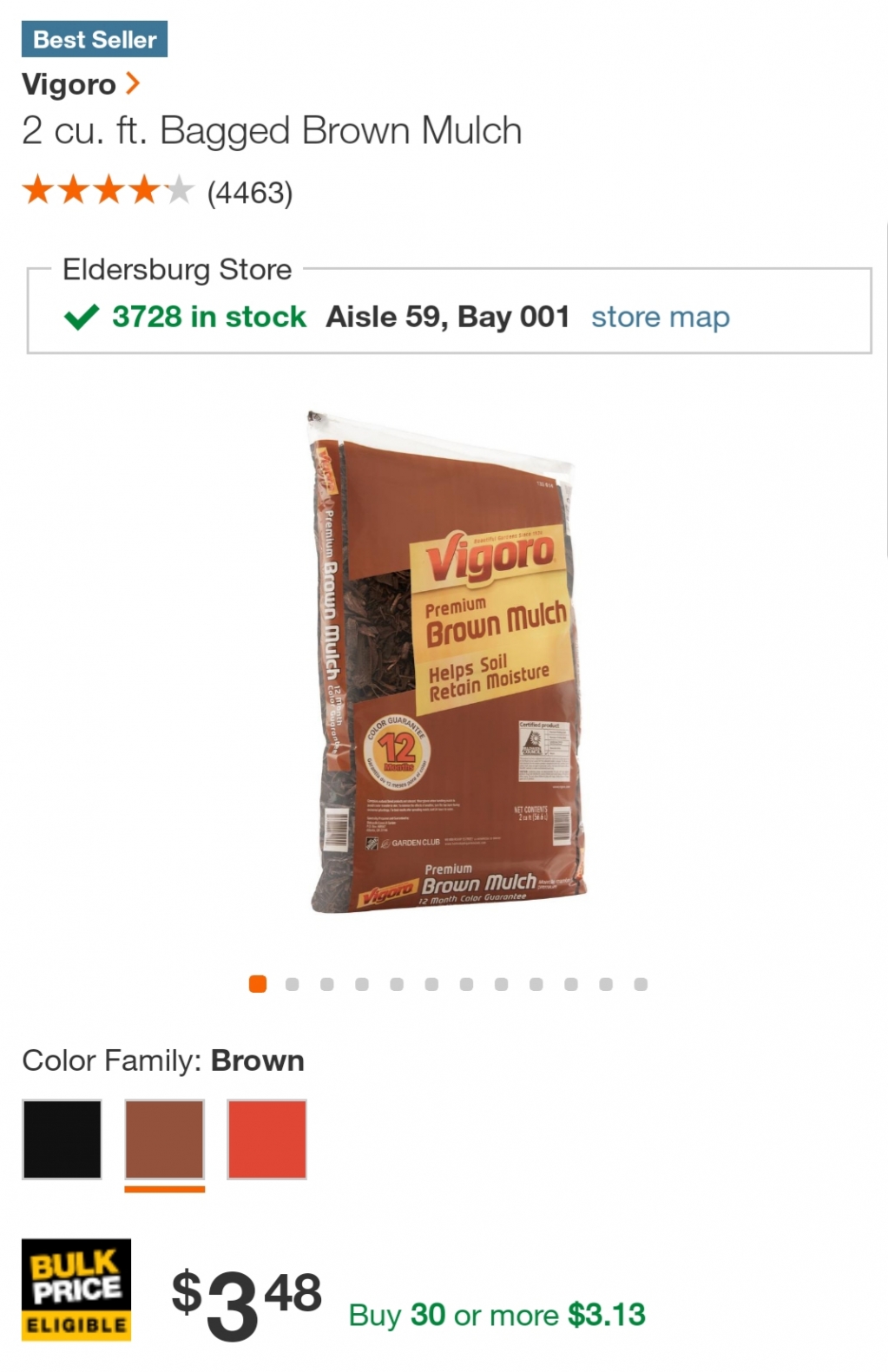

This is the rubber mulch that HD carries in my area.
I notice that the price is about half of what I remember paying. Maybe HD is selling a different brand now. It is cheap enough. Might buy a bag just to see if this brand floats.
The mulch you have pictured is not rubber it is wood based,
I thought was I tripping
